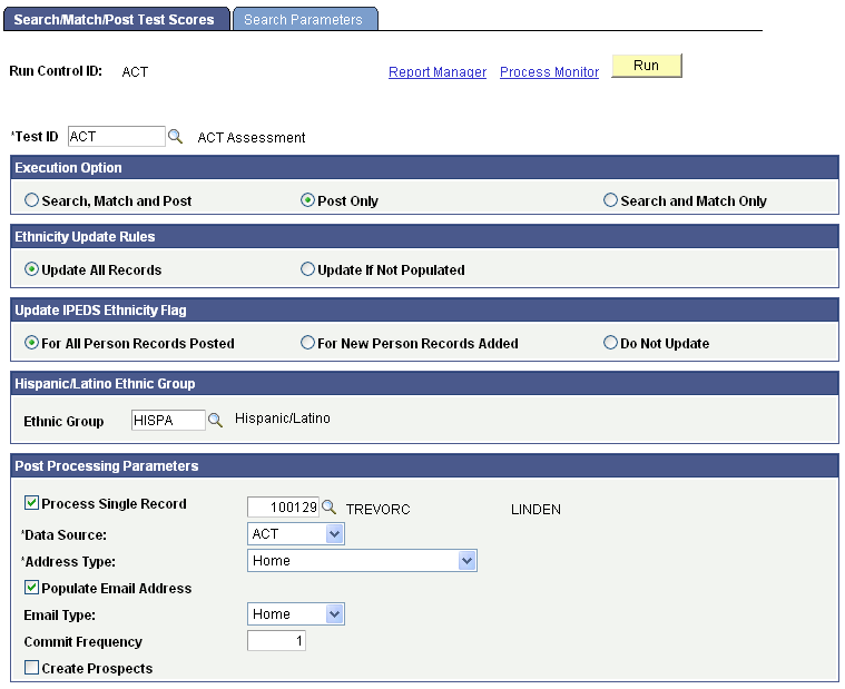

Access the Search/Match/Post Test Scores page ( or ).
This example illustrates the fields and controls on the Search/Match/Post Test Scores page. You can find definitions for the fields and controls later on this page.

Test ID |
Enter the test ID that you want to process. Once you enter the test ID, the additional fields specific to the test will appear. You must have Test ID Security established in order to select a value. The prompt will display only test IDs to which you have security to access. This field is required. |

Execution Option
Field or Control |
Description |
Search, Match and Post |
Select this option if you want the process to search your database for records that match the suspense record and post the suspense data to your database. This is the recommended option. |
Post Only |
Select this option if you want only to post the suspense data to your database (if you select this option, you must have already run search/match or manually changed the Search and Post process options on the External Test Score Suspense page). |
Search and Match Only |
Select this option if you want to only run the search and match process on the suspense file. You will need to post the data at a later time. |
Post To
Field or Control |
Description |
Campus Solutions |
Select this option if you want to post the suspense data to Campus Solutions. |
Enterprise CRM |
Select this option if you want to post the suspense data to PeopleSoft CRM. The system displays this option if you have selected the CRM for Higher Education check box on the SA Features page of the Student Admin Installation component and if the test ID is eligible for posting to CRM. If the test ID is eligible for posting to CRM, the system displays the Available for CRM Post check box as selected on the External Test Score Mapping page (Set Up SACR, Product Related, Recruiting and Admissions, External Test Scores, External Test Score Mapping). |

Ethnicity Update Rules
For ACT, LSAT/LSDAS, AMCAS only:
Field or Control |
Description |
Update All Records |
Select this option if you want the process to post the ethnicity data to the ethnicity records (DIVERS_ETHNIC and ETHNICITY_DTL) for all existing EMPLIDS. The posted ethnicity data can be viewed on the Ethnicity page (Campus Community, Personal Information, Biographical, Personal Attributes, Ethnicity) or on the Regional page of the Add/Update a Person component (Campus Community, Personal Information or Personal Information (Student), Add/Update a Person). If you select this option and if data already exists for an EMPLID on the ethnicity records, the process inserts a new row into the records for the EMPLID. If the Ethnic Group of NSPEC is currently populated on either ethnicity record, new rows will not be inserted. |
Update If Not Populated |
Select this option if you want the process to post the ethnicity data only for those EMPLIDS who do not have existing ethnicity data. |

Update IPEDS Ethnicity Flag
For ACT, LSAT/LSDAS, and AMCAS only:
Field or Control |
Description |
For New Person Records Added |
Select this option if you want the process to check the IPEDS check box on each ethnic group row inserted to the Ethnicity or Regional page (ETH_VALIDATED = Y for each DIVERS_ETHNIC record) only for new EMPLIDS added to the system. |
For All Person Records Posted |
Select this option if you want the process to check the IPEDS check box on each ethnic group row inserted to the Ethnicity or Regional page (ETH_VALIDATED = Y for each DIVERS_ETHNIC record) for both new and updated EMPLIDS. |
Do Not Update |
This check box is available only for ACT. Select this check box if you do not want the process to check the IPEDS check box regardless of whether the suspense record contains ethnicity information. |
Hispanic/Latino Ethnic Group
For ACT only:
Field or Control |
Description |
Ethnic Group |
Select the PeopleSoft ethnic group code that the search/match/post process should post to the Ethnicity group box of the Ethnicity or Regional page. The process posts this value only if the person is Hispanic or Latino. |
Post Processing Parameters
Field or Control |
Description |
Process Single Record |
Select this check box if you want to run the search/match/post process for a single suspense record. The field to the right becomes available. Select the suspense record that you want to process. Only records where the Edit processing option is set to Complete on the External Test Score Suspense component will appear. |
Data Source |
Select the data source from which this information was received. Data source is a required value on the Test Results page. The search/match/post process will post the value that you select here to the Test Results page. Values for this field are delivered with your system as translate values. You can modify these translate values. |
Address Type |
If the search/match/post process adds a new record to your database, the process loads the address information from the test record into the Addresses page. Select the address type that you want the process to assign to the new address. Define address types on the Address Type Table. |
Phone Type |
If the search/match/post process adds a new record to your database, the process loads the phone number from the test record to the Personal Information page. Select the phone type that you want to process to assign to the new phone number. This field will appear only for test IDs where the phone number is loaded. |
Commit Frequency |
The commit frequency enables you to decide how often the data is saved during the Search/Match/Post process. The field defaults to 1000. Edit this field to decrease or increase the number of records that are processed before being saved. The commit frequency can help with the performance of the program. A commit frequency that is too low, however, can slow the program down. |
Populate Email Address, Email Type |
Select this check box to post an email address to the Email Addresses on the Add/Update a Person component. If you choose to populate an email address, you must then select an email type. Note: These fields appear only for test IDs where an email address is loaded. |
Create Prospects |
Select to create prospect records for the IDs that are added or for existing IDs where no prospect record exists from the test score post. The Default Prospect Values group box becomes available to enter default values for the prospect records that the system creates. You can view prospect data in the Create/Update Prospect component under the menu Student Recruiting, Maintain Prospects. If you have selected the Enterprise CRM option in the Post To group box, the system selects the Create Prospects check box and disables it You must enter the required fields in the Default Prospect Values group if the Create Prospects check box is selected. |
