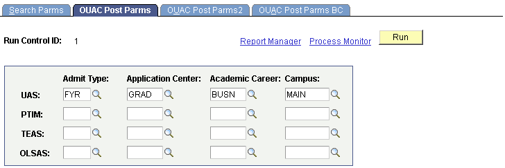

Access the OUAC Post Parms (OUAC post parameters) page ().
This example illustrates the fields and controls on the OUAC Post Parms page. You can find definitions for the fields and controls later on this page.
Field or Control |
Description |
Admit Type |
Select the default admit type for all OUAC transactions concerning each of the following categories of students: undergraduates (UAS), part-time (PTIM), teacher's college (TEAS), and law (OLSAS). The admit type that you enter here is the default on the Application Data page (the ADM_APPL_DATA record). Define admit types on the Admit Types Table page. |
Application Center |
Select the default application center for all OUAC transactions concerning each of the following categories of students: undergraduates (UAS), part-time (PTIM), teacher's college (TEAS), and law (OLSAS). The application center that you enter here is the default on the Application Data page (the ADM_APPL_DATA record). Define application centers on the Application Center Table page. |
Academic Career |
Select the default academic career for all OUAC transactions concerning each of the following categories of students: undergraduates (UAS), part-time (PTIM), teacher's college (TEAS), and law (OLSAS). The academic career that you enter here is the default in the ADM_APP_CAR_SEQ record. Define academic careers on the Academic Career Table page. |
Campus |
Select the default campus for all OUAC transactions concerning each of the following categories of students: undergraduates (UAS), part-time (PTIM), teacher's college (TEAS), and law (OLSAS). The campus that you enter here is the default on the Application Program page (the ADM_APPL_PROG record). If you do not select a campus here, the default is the default campus attached to the applicant's academic program. Define campuses on the Campus Table page. |
