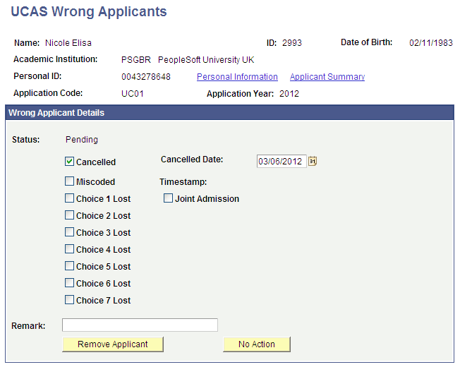

  • Delete incorrect UCAS applicant records.

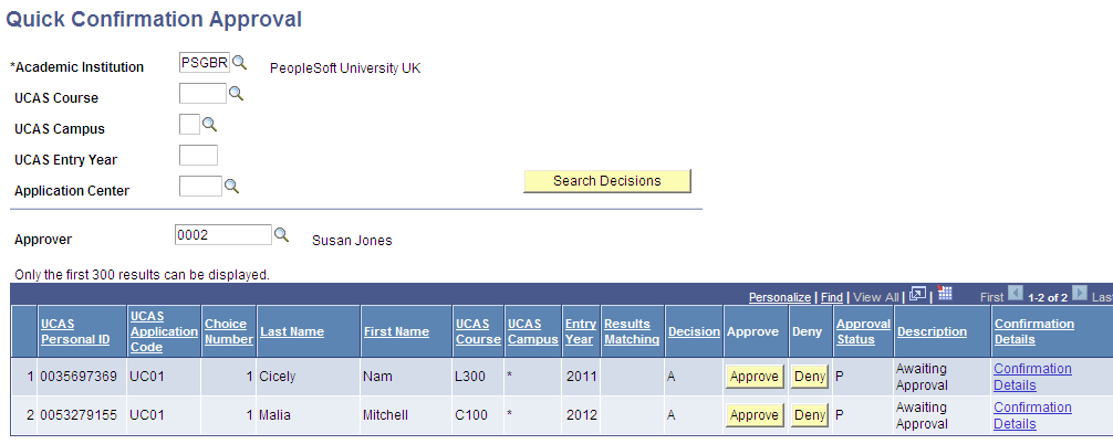

  • Approve or reject a UCAS Confirmation decision.
  • Approve or reject multiple UCAS Confirmation decisions.

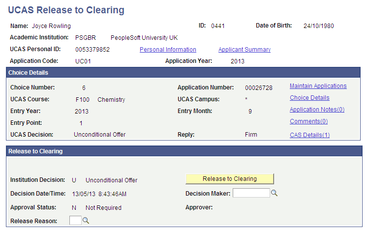

  • Enter a decision to release an applicant into Clearing.

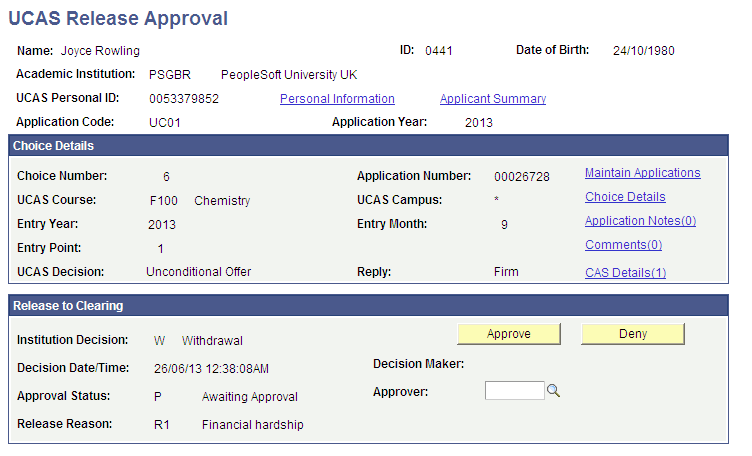

  • Approve or reject the Release into Clearing decision.

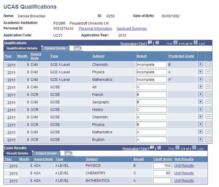

  • Review and update UCAS qualifications.

After you import and review the applicants and their applications, delete any applicant records that UCAS has sent in error or UCAS has canceled. The UCASApplicantCancelled XML object contains the data related to applicants and application choices that have been sent to UCAS by mistake or subsequently canceled at UCAS. When you use the Import Applicant Data process to import the applications and applicant data, the import process also imports the data. Use the Remove Wrong Applicants components to review the data and delete them from your database. You can also use the Remove Wrong Applicants components to manually unmatch an applicant record which is incorrectly matched to an existing person record.

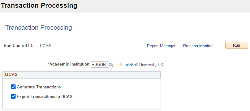

  1. After entering or updating a decision, run the Transaction Processing process to generate a transaction. If decision approval is set up, use the Decision Approval page to approve the decision before you generate a transaction.
  2. Use the Transaction Processing process to export transactions to UCAS and to import error codes once UCAS has processed the transactions. Transactions that the system sends to UCAS initially have an error code of -1 to indicate that UCAS hasn't yet processed the transaction. Once UCAS fully processes the transaction, the error code is either 0 (success) or is a code that UCAS defines in the Error reference data.

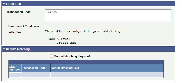

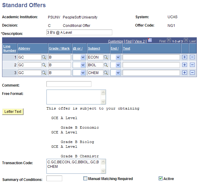

Use the Standard Offers page to define conditions for an offer to send to UCAS. For example, you can define a condition three A Levels at Grade B that can be used for multiple application decisions. Subsequently, you can enter this condition in the Decision Processing pages when making a conditional offer. When you generate transactions for the conditional offers, the system includes this condition in the transactions to send to UCAS.

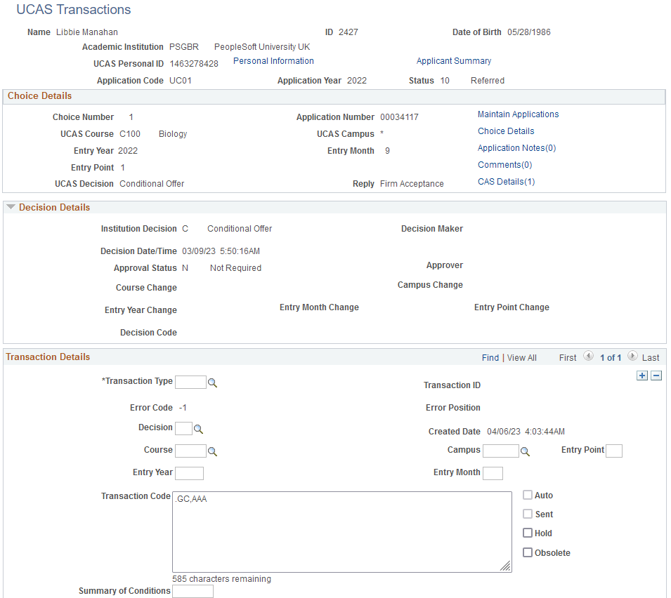

  1. Use the Initial Decision Entry pages to enter a decision. For example, enter a decision of unconditional offer.
  2. Run the Transaction Processing process to generate the transaction for the unconditional offer decision. (Select the Generate Transactions check box on the Transaction Processing page.)
  3. Use the UCAS Transactions page to review the transaction. For example, because you entered a decision of Unconditional Offer, the Transaction Details section of the page displays the Transaction Type LD and Decision of U.
Now you want to export this decision to UCAS and also want to know that UCAS has received this transaction. It is recommended that you first generate transactions, review the created transactions, and then export the transactions to UCAS.
For XML-link processing, error codes are read back when the transaction is posted so steps 2 and 3 aren't required.
  1. Run the Transaction Processing process to export the applicant's LD transaction to UCAS (select the Export Transactions check box on the Transaction Processing page.)
  2. In the UCAS Transactions page, review the exported transaction (the Sent check box appears as selected).
  3. Run the Transaction Processing process to receive the acknowledgment from UCAS for the exported transaction (select the Update Transactions from UCAS check box on the Transaction Processing page).
  4. Use the UCAS Transactions page to review the error code for the applicant's LD transaction sent to UCAS. The error code is 0 (success) in the UCAS Transactions page, which indicates that UCAS received the institution's decision.

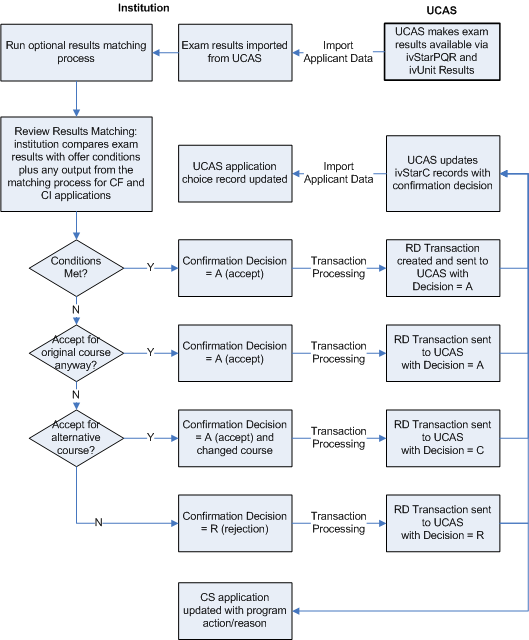

When exam results are available, your institution will confirm conditional offers for UCAS applications:
  1. For UCAS applications, make sure you have imported Tariff reference data (by running the Import Reference Data process) if you want to use the Results/Offer Matching process to evaluate tariff offers.
  2. Run the Import Applicant Data process to import the exam results.
  3. Compare the applicant exam results with the offer conditions. You can do the comparison manually or run the Results/Offer Matching process.
  4. Use the Quick Confirmation page or the Confirmation Entry page to accept or reject the conditional offer.
  5. Run the Transaction Processing process to generate and export the RD transaction.
This diagram illustrates the Confirmation process flow.
Confirmation Processing Flow

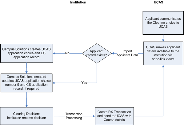

An applicant who may not have got admission in any institution is eligible for Clearing. To process Clearing applications for UCAS applicants:
  1. Use the Import Applicant Data to import the Clearing application choices.
  2. Use the UCAS Initial Decision Entry or the UCAS Decision Processing page to enter an admission decision for the Clearing application. To search for the Clearing applications, enter 9 in the UCAS Choice Number field of the decision search page. Note that the decision search pages don't display accepted Clearing applications (that is UCAS applications with choice number = 9 and the decision value = A).
  3. Run the Transaction Processing process to generate and export the RX transaction to UCAS. The RX transaction must have a decision value.
This diagram illustrates an example of the Clearing process flow.
Clearing Processing Flow Example
Use the UCAS Release to Clearing page to release an applicant into Clearing.

Standard Offers
SAD_UC_STD_OFF
Student Admissions > UCAS Processing > Standard Offers
Define conditions for an offer that UCAS sends to the applicant.

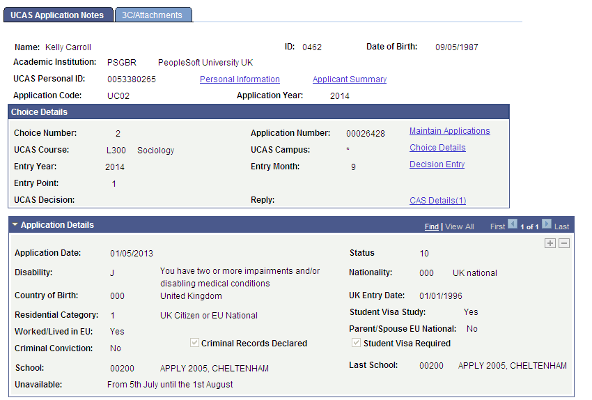

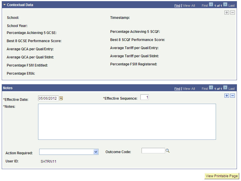

UCAS Application Notes
SAD_UC_APPLNOTES
Student Admissions > UCAS Processing > UCAS Application Notes

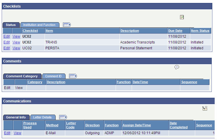

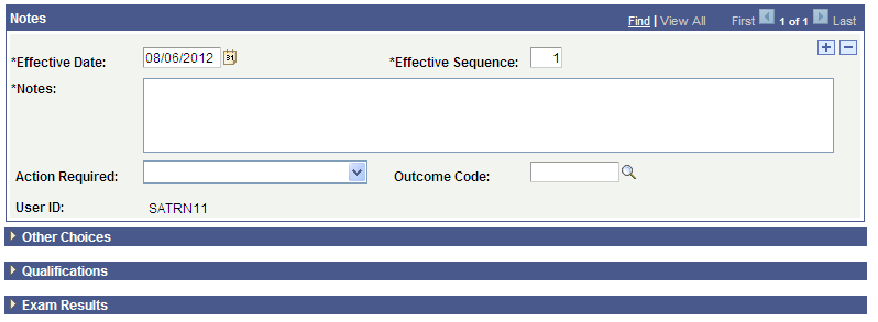

View the key information for a UCAS application choice, on a single page. Enter notes for the application choice.

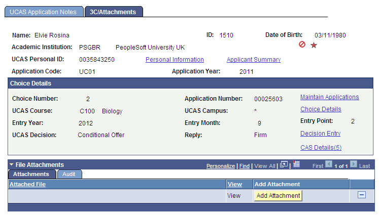

3C/Attachments
SAD_UC_3C_ATTACH
Student Admissions > UCAS Processing > UCAS Application Notes > 3C/Attachments
Add or view attachments for the Campus Solutions application record. Enter or view the 3C information for the person ID.

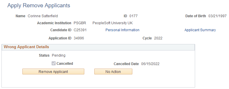

UCAS Wrong Applicants
SAD_UC_STARW
Student Admissions > UCAS Processing > Remove Wrong Applicants > UCAS Wrong Applicants
Review the imported canceled/wrong applicant records and delete records if required. You can also use this page to unmatch an applicant record that's incorrectly matched to a person record.

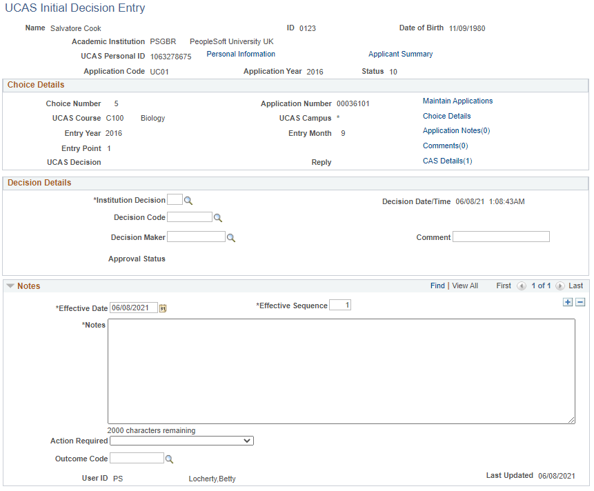

SAD_UC_DECENTRY
Student Admissions > UCAS Processing > UCAS Decision Processing > Initial Decision Entry
Enter an admission decision for a UCAS application choice.

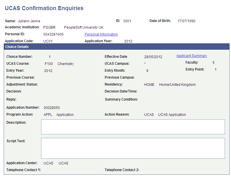

Find out whether your institution has confirmed the applicant's admission offer or released the applicant into Clearing.

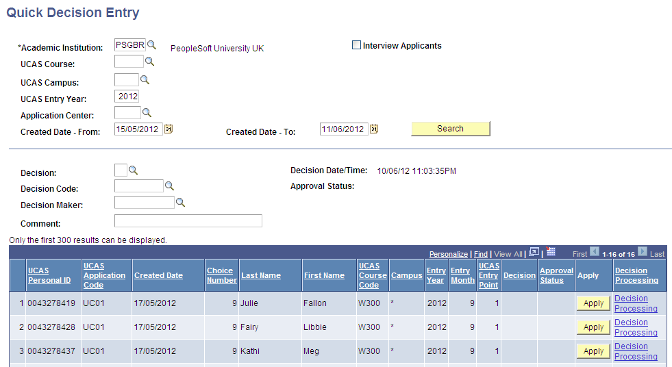

UCAS Quick Decision Entry
SAD_UC_QDEC
Student Admissions > UCAS Processing > UCAS Decision Processing > Quick Decision Entry
Enter a decision simultaneously for multiple UCAS applications.

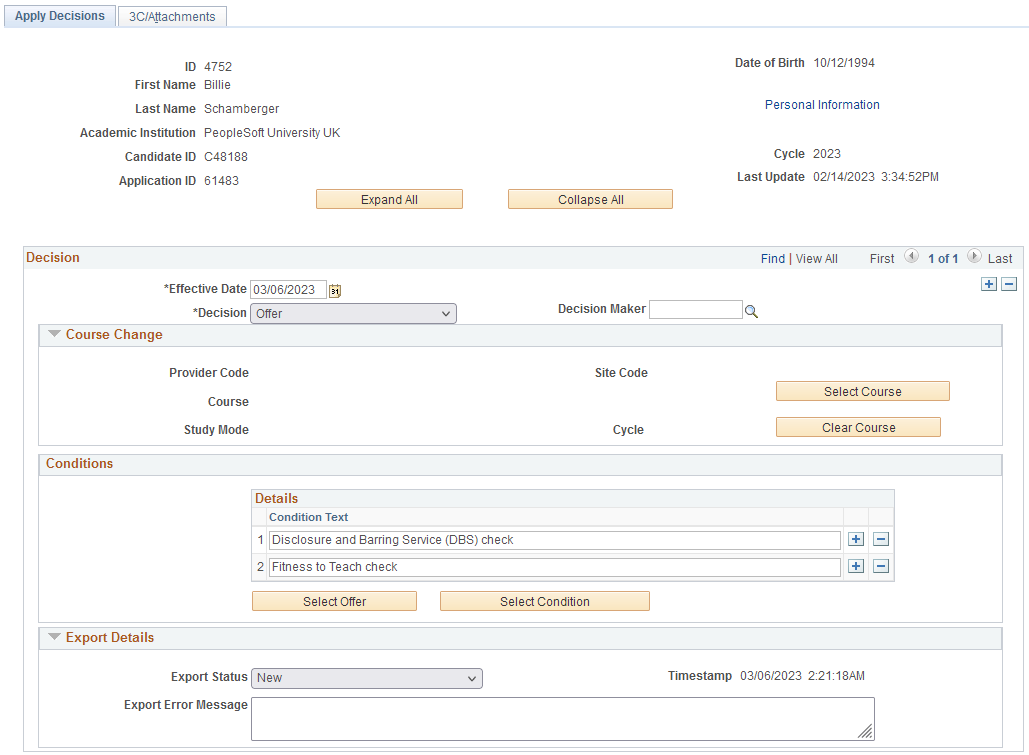

Apply Decisions
SAD_UC_APDECISN_PG
Student Admissions > UCAS Processing > Apply Decision Processing > Apply Decisions
Enter or update a decision for Apply applications.

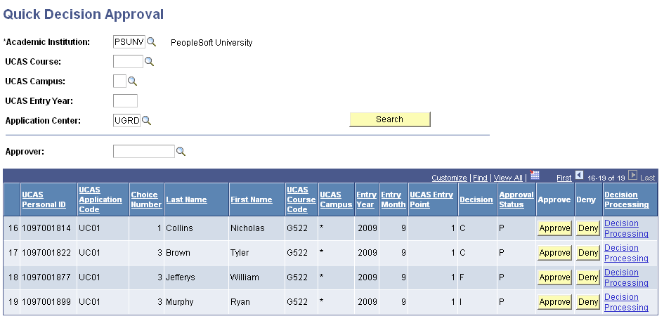

UCAS Quick Decision Approval
SAD_UC_QDAPR
Student Admissions > UCAS Processing > UCAS Decision Approval > Quick Decision Approval
Approve or reject simultaneously the admission decisions for multiple UCAS applications.

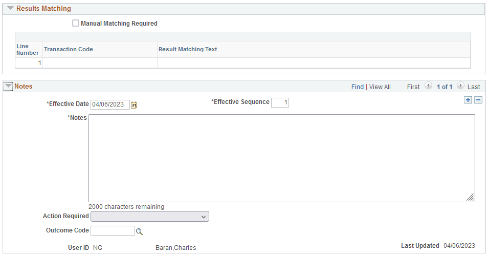

Match exam results with conditional offer details for Confirmation. The process determines whether the applicants have satisfied the offer conditions.
You can run this process for all applicants in an institution, for all applicants of a particular course, or for specific applicants.
This process is optional for confirming conditional offers. You can use the Confirmation Entry page to manually determine whether an applicant has satisfied the offer conditions.

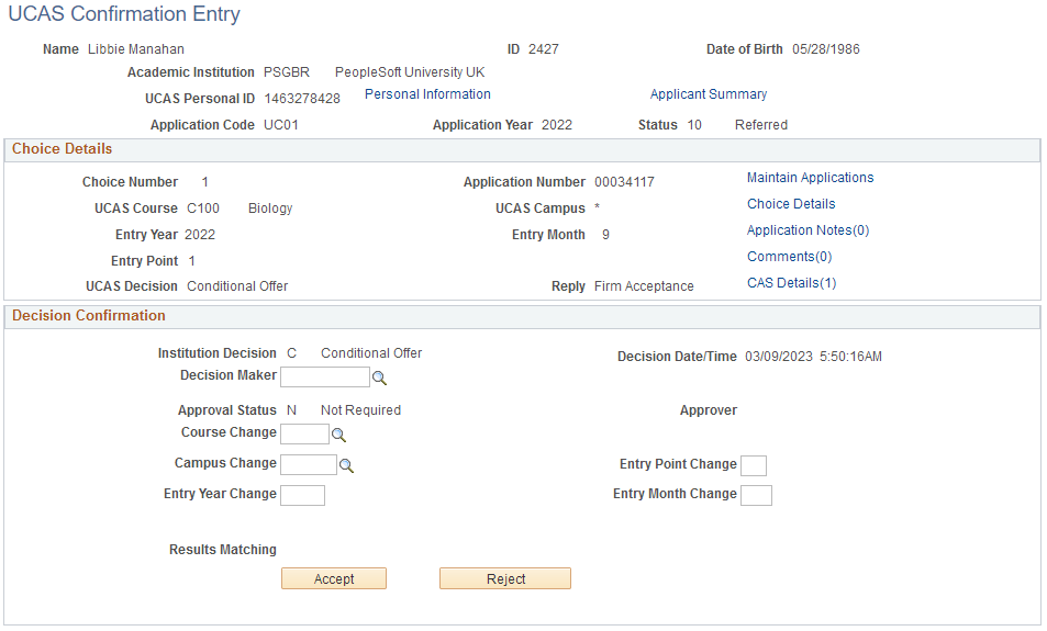

UCAS Confirmation Entry
SAD_UC_CNFDEC
Student Admissions > UCAS Processing > UCAS Decision Processing > Confirmation Entry
Accept or reject the conditional offer of an applicant.
If you haven't run the Results/Offer Matching process for the applicant, manually match the applicant's exam results with the conditional offer details and indicate whether the applicant has satisfied the conditions for admission.

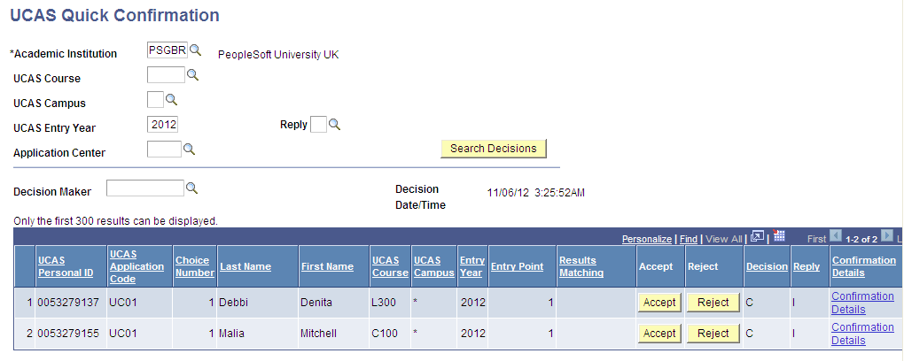

UCAS Quick Confirmation
SAD_UC_QCONF
Student Admissions > UCAS Processing > UCAS Decision Processing > Quick Confirmation
Accept or reject the conditional offer of multiple applicants.

UCAS Quick Confirmation Approval
SAD_UC_QAPR
Student Admissions > UCAS Processing > UCAS Decision Approval > Quick Confirmation Approval
Approve or reject the Confirmation decision for multiple applicants.
UCAS Release To Clearing
SAD_UC_RELDEC
Student Admissions > UCAS Processing > UCAS Decision Processing > Release to Clearing
Release an applicant into Clearing.
UCAS Release to Clearing Approval
SAD_UC_RELAPR
Student Admissions > UCAS Processing > UCAS Decision Approval > Release to Clearing Approval
Approve or reject an applicant's release into Clearing.

Review and edit imported qualification and exam result records.
SAD_UC_TRN_PROC
Student Admissions > UCAS Processing > Transaction Processing > Transaction Processing
Generate, export, and update UCAS transactions.
UCAS Transactions
SAD_UC_TRANIN
Student Admissions > UCAS Processing > Transaction Processing > UCAS Transactions
Review the UCAS transactions. In addition, manually add or delete transactions and set the hold flag to prevent the system from sending the transactions to UCAS.
UCAS Confirmation Enquiries
SAD_UC_CONF_ENQ
Student Admissions > UCAS Processing > UCAS Confirmation Enquiries
Review a summary of the Confirmation or Clearing application choice. Also, enter notes and outcome codes for an application choice while handling applicant enquiries related to Confirmation and Clearing.

Access the Standard Offers page (Student Admissions > UCAS Processing > Standard Offers).
This example illustrates the fields and controls on the Standard Offers page. You can find definitions for the fields and controls later on this page.
You can use the Decision Code field in the Decision Processing, Initial Decision and Quick Decision pages to select a standard offer. On selecting a standard offer, the system populates the decision record with the values that you defined on the Standard Offers page.
Free Format field and the Interview decision
For Interview decisions, the value you enter in the Free Format field need not start with DDMMYY. You can define interview standard offers with or without date and time elements. Note that the generated Transaction Code should not be blank for Interview decisions. You must enter text in either the Comment field or the Free Format field to generate transaction code.
If the Free Format field on the Standard Offers page starts with a date in the format DDMMYY, then the system populates the Interview Date field in the UCAS Decision Processing and Initial Decision pages with this date. For example, suppose you have an INT01 offer with a free format text that starts with 010100 on the Standard Offers page. In such a case, when you select INT01 as a decision code on the UCAS Decision Processing page, the page automatically populates the Interview Date field as 01/01/2000.
If the Free Format field on the Standard Offers page includes a time in the format HHMM from position 8 to 11 (that is, after a hyphen - as character 7), then the system populates the Interview Time field in the UCAS Decision Processing and UCAS Initial Decision pages with this time. For example, suppose you have an INT01 offer with a free format text that starts with 010100-1300. In such a case, when you select INT01 as a decision code on the UCAS Decision Processing page, the page automatically populates the Interview Date field as 01/01/2000 and Interview Time as 13:00.
The system populates the Free Format field on the UCAS Decision Processing page with the Free Format value from the Standard Offers page without the interview date and time elements. For example, suppose you have an INT01 offer with a free format text 010100-1300 Is your interview date and time. In such a case, when you select INT01 as a decision code on the UCAS Decision Processing page, the page automatically populates the Interview Date field with 01/01/2000, Interview Time field with 13:00, and the Free Format field with Is your interview date and time. The Free Format field doesn't appear on the Initial Decision pages but the system applies similar logic in the background to populate the Free Format field of the decision record with the free format text from the standard offer minus any interview date and time elements.
You can change the interview date and time, comment, and the free format text values on the decision pages, if required.

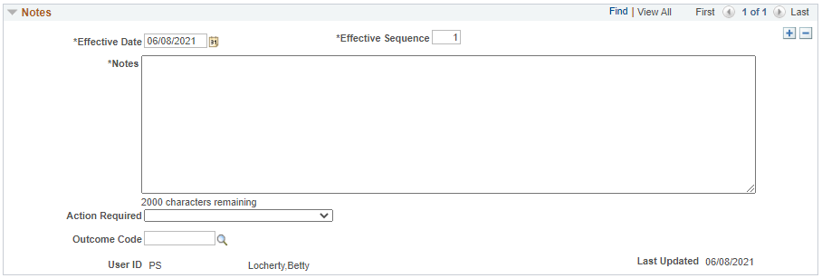

Access the UCAS Application Notes page (Student Admissions > UCAS Processing > UCAS Application Notes).
This example illustrates the fields and controls on the UCAS Application Notes page (1 of 4). You can find definitions for the fields and controls later on this page.
UCAS (Universities and Colleges Admissions Service) Application Notes page (1 of 4)
This example illustrates the fields and controls on the UCAS Application Notes page (2 of 4). You can find definitions for the fields and controls later on this page.
UCAS (Universities and Colleges Admissions Service) Application Notes page (2 of 4)
This example illustrates the fields and controls on the UCAS Application Notes page (3 of 4). You can find definitions for the fields and controls later on this page.
UCAS (Universities and Colleges Admissions Service) Application Notes page (3 of 4)
This example illustrates the fields and controls on the UCAS Application Notes page (4 of 4). You can find definitions for the fields and controls later on this page.
UCAS (Universities and Colleges Admissions Service) Application Notes page (4 of 4)
The fields on the Notes region are similar to those on the UCAS Confirmation Enquiries page. The Automatic Save and Outcome Required settings on the UCAS Configuration page affects only the UCAS Confirmation Enquiries page and doesn't affect the UCAS Application Notes page.
Field or Control
Description
View Printable Page
Click to obtain a printable version of the application information.
Access the 3C/Attachments page (Student Admissions > UCAS Processing > UCAS Application Notes > 3C/Attachments).
This example illustrates the fields and controls on the 3C/Attachments page (1 of 2). You can find definitions for the fields and controls later on this page.
3C (communications, comments, and checklists)/Attachments page (1 of 2)
This example illustrates the fields and controls on the 3C/Attachments page (2 of 2). You can find definitions for the fields and controls later on this page.
3C (communications, comments, and checklists)/Attachments page (2 of 2)
File Attachments
Use this group box to add, delete and view attachments for the Campus Solutions application.
Field or Control
Description
Add Attachment
Click to access standard PeopleTools functionality to browse to a file and upload it
View
Click the link to open the attachment in a new window.
The Audit tab displays all updates to attachments, including user name and date/time.
Note that you can also use the File Attachments group box on the Application Data page of the Maintain Applications component to maintain and access the attachment data.
The 3C Group Boxes (Checklists, Comments, and Communications)
The fields on these group boxes are similar to the fields that appear on the Campus Community's checklist, comment, and communication pages. The group boxes display the records in a similar way to the Campus Community's checklist, comment, and communication summary pages.
See Understanding Checklists
See Understanding Comments
See Understanding Communication Management
Note that the group boxes display a person ID's 3C records for only the ADMA and ADMP administrative functions. Also, these group boxes display only those 3C records where the application number in the variable data of the 3C record matches with the application choice that the Choice Details region of the page displays or if the application number value in the variable data is blank (3C records can be created without the application number value in variable data). Records linked to other application numbers aren't displayed.
When you create a checklist, comment, or communication record by clicking the create button on any one of these group boxes, the system by default:
  • Populates the Administrative Function field with the value that you selected for the Default Admin Function field on the UCAS Configuration page (if the Default Admin Function field is blank, then the system will enter ADMA in the Administrative Function field).
  • Enters the variable data based on the application choice (that is, academic career, student career Nbr, application number, and application center).
Access the UCAS Wrong Applicants page (Student Admissions > UCAS Processing > Remove Wrong Applicants > UCAS Wrong Applicants).
This example illustrates the fields and controls on the UCAS Wrong Applicants page . You can find definitions for the fields and controls later on this page.
UCAS (Universities and Colleges Admissions Service) Wrong Applicants page
In certain circumstances, an incoming UCAS applicant record can be incorrectly matched to an existing person record during the import process or through the Transaction Data page. In such circumstances:
  1. Use the UCAS Remove Wrong Applicants component to manually add the wrong applicant record.
  2. Select the Cancelled check box. If needed, edit the Cancelled Date field. Optionally, enter a remark.
  3. Save the record.
  4. Click the Remove Applicant button to run the Remove Applicant process. This process removes the incorrectly matched applicant.
    The Remove Applicant process doesn't alter the person-related records (for example, Disability, Ethnicity, Citizenship, National ID, External System ID and so on) that the Import Applicant Data process may have created for the incorrect ID. These records should be updated or removed using the relevant Campus Community pages. In particular, the UCAS Personal ID that the import process creates as an External System ID for the incorrect ID should be removed to prevent the record being incorrectly matched again during the re-import.
  5. Run the Import Applicant Data process for the single applicant so that all the deleted applicant records can be re-imported and either matched to the correct person or a new person record created.
Field or Control
Description
Cancelled Date
This field is available for edit only when you are manually adding a record. After you save the manually added record, this field becomes unavailable.
Remark
Remove Applicant
Click to run the Remove Applicant process that will delete the IDs:
  • UCAS applicant record.
  • UCAS application choice records.
  • Non-matriculated Campus Solutions application records.
The system enables this button if the status is Pending, Partially Removed, or No Action.. When you click the button, the status changes to Removed.
When you click the button for a UCAS applicant for whom only specific choices are lost, the system removes the specific lost choices but retains the overall applicant record.
For a manually added record, the system enables the button only when you save the record.
No Action
Click to change the record status from Pending to No Action. The No Action status indicates that the record need not be removed.
For a manually added record, the system enables the button only when save the record.
After clicking the Remove Applicant button, navigate to Campus Community > Personal Information > ID Management > ID Delete to remove the person record of the UCAS wrong applicant.
Access the UCAS Initial Decision Entry page (Student Admissions > UCAS Processing > UCAS Decision Processing > Initial Decision Entry).
This example illustrates the fields and controls on the UCAS Initial Decision Entry page. You can find definitions for the fields and controls later on this page.
UCAS (Universities and Colleges Admissions Service) Initial Decision Entry page
If you didn't select the Interview Applicants option on the UCAS Initial Decision Entry search page, an application choice is included in the search results only if all the following conditions are satisfied:
  • An institution decision doesn't exist.
  • UCAS decision of the choice is blank.
  • Choice isn't cancelled.
  • Action isn't Declined by Default (D) or Rejected by Default (R).
  • The whole application isn't withdrawn.
In such a case, the UCAS Initial Decision Entry page doesn't allow you to modify an institution decision. If you want to modify an institution decision, use the UCAS Decision Processing page.
If you select the Interview Applicants option on the UCAS Initial Decision Entry search page, an application choice is included in the search results only if all the following conditions are satisfied:
  • An institution decision record exists with decision = I (interview) and decision is approved or doesn't require approval.
  • UCAS decision value of the choice (imported from StarC/StarG) isn't W (withdrawn) or R (rejected).
In such a case, you can then use the UCAS Initial Decision Entry to modify the Interview decision to a post-interview decision (that is, Offer, Conditional offer, or Reject).
Decision Details
Field or Control
Description
Institution Decision
Select an admission decision. After you enter a decision, run the Transaction Processing process to generate the transaction to send to UCAS.
If the choice number is 9 (Clearing), the valid decisions are A (Accept) or R (Rejection). If the choice number is 6 (Adjustment), the valid decision is U (Unconditional Offer). If the choice number isn't 9 or 6 (standard application), the valid decisions are C (Conditional Offer), U (Unconditional Offer), R (Rejection), F (Course Full), and I (Interview).
The Interview Date and Interview Time fields appear only if you select the Interview decision.
You can't enter the Delayed Conditional decision code (D) on this page. This decision can be entered only in the Decision Processing page.
Decision Code
Optionally, add a standard offer to the decision.
Interview Date
Select the date on which the interview is to take place.
Interview Time
Enter the time the interview is scheduled to begin. The time format uses a 24-hour clock. Therefore, for example, if the interview time is 2:30 PM, enter 14:30.
Comment
For all decisions you can add a comment, unless a standard offer is entered.
You can enter the reason for a Clearing Rejection in the Comment field. When you generate a RX transaction for the rejection, the system includes the comment text in the Free Format column of the RX transaction.
Notes
This region is similar to the Apply Application and UCAS Confirmation Enquiries pages.

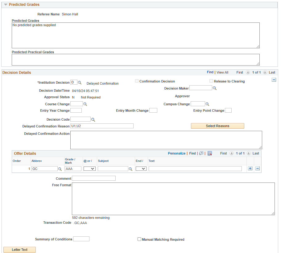

Select an admission decision. After you enter or update a decision, if required, use the UCAS Decision Approval page to approve the decision. Then use the Transaction Processing process to generate the decision transaction to send to UCAS.
The validations of this field are similar to that of the Institution Decision field on the UCAS Initial Decision Entry page. However, you can enter the Delayed Conditional (D) decision only from this page. Decision D is valid only for non-clearing CF application choices (CF means decision is Conditional Offer and reply is Firm).
Confirmation Decision
The system automatically selects this check box when you enter a Confirmation decision in the UCAS Confirmation Entry page or the UCAS Quick Confirmation page.
Release to Clearing
The system automatically selects this check box when you enter a Release into Clearing decision in the UCAS Release to Clearing page.
Decision Code
Delayed Confirmation Reason
This indicates the reason for the delay in confirming the offer.
Multiple reasons can be defined separated by commas. Use the Select Reasons button to select one or more reasons from the imported reference data.
Delayed Confirmation Action
This indicates the action students need to take to confirm the offer.
Comment
The usage of this field is similar to that of the Comment field on the UCAS Initial Decision Entry page. The only difference is that on this page you can use this field for transaction code. For example, if Interview Date is May 26, 2009 and Interview Time is 9:15 and Comment is Bring your portfolio and you click Letter Text, then the following transaction code appears 260509-0915,'Bring your portfolio'
The offer details fields are similar to the fields on the Standard Offers page.
Notes
Access the UCAS Quick Decision Entry page (Student Admissions > UCAS Processing > UCAS Decision Processing > Quick Decision Entry ).
This example illustrates the fields and controls on the UCAS Quick Decision Entry page. You can find definitions for the fields and controls later on this page.
UCAS (Universities and Colleges Admissions Service) Quick Decision Entry page
If you don't select the Interview Applicants check box on the UCAS Quick Decision Entry page, a choice is included in the search results only if all the following conditions are satisfied:
In such a case, the page doesn't allow you to modify an admission decision. If you want to modify an admission decision, use the UCAS Decision Processing page.
If you select the Interview Applicants check box on this page, a choice is included in the search results only if all the following conditions are satisfied:
  • UCAS decision value of the choice isn't W.
In such a case, you can use this page to modify the Interview decision to a post-interview decision (that is, Offer, Conditional offer, or Reject).
The system enables the Interview Date - From and Interview Date - To search fields and displays the interview date column in the search results, if you select the Interview Applicants check box. And the system enables the Created Date - From and Created Date - To search fields, if you deselect the Interview Applicants check box.
You can search for records of a particular institution, course, campus, entry year and application center or combination of those. The decision, decision code, decision maker and comment field values are used for all the records that have a decision applied and are saved.
You can't enter the Delayed Conditional decision code (D) in this page. This decision can be entered only in the Decision Processing page.

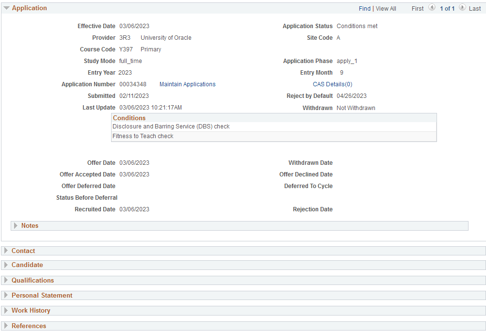

Access the Apply Decisions page (Student Admissions > UCAS Processing > Apply Decision Processing > Apply Decisions).
This example illustrates the fields and controls on the Apply Decisions page (1 of 2). You can find definitions for the fields and controls later on this page.
This example illustrates the fields and controls on the Apply Decisions page (2 of 2). You can find definitions for the fields and controls later on this page.

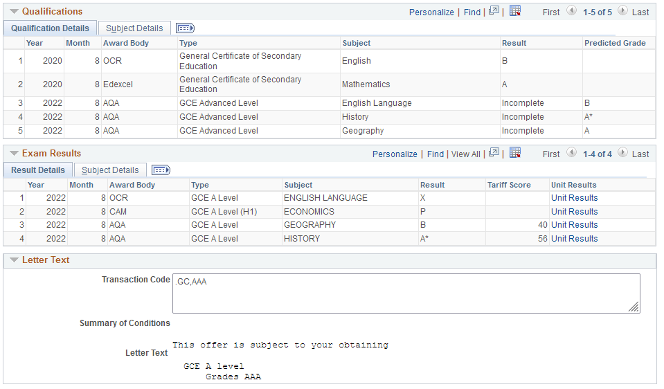

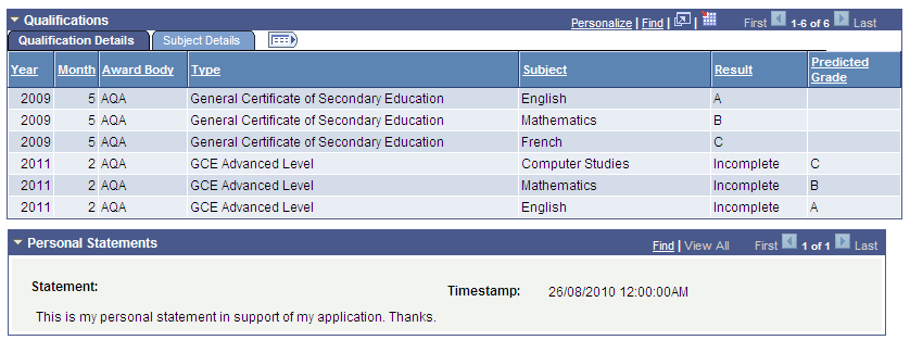

The regions Application, Contact, Candidate, Qualifications, Personal Statement, Work History, and References are similar to the ones on the Apply Application page.
Note: You may see positive or negative service indicator icons on the page. If you select either icon, the Manage Service Indicators page appears.
Decision
In this region, you can view current and older effective-dated records as well as delete them.
Field or Control
Description
Effective Date
This defaults to the current date when you add a new row.
Note: You can select a future effective date, but future records aren’t included in the export process.
Decision
Select your decision for this application.
The values you can select are derived from the most recent effective-dated row on the Apply Application Status page. For information about the decisions and application status mapping, see Creating or Reviewing Application Statuses for Apply Applications.
Decision Maker
When a decision has been made, this field is populated with a default value from any one of these:
  • If the user has defined a Decision Maker on the UCAS, Apply Defaults page.
  • If the Default Decision Maker check box is selected on the UCAS Configuration page, and the user who makes the decision is associated with an EMPLID, then this value is the default.
  • Blank by default.
Course Change
This region appears only when Decision = Offer.
Field or Control
Description
Select Course
Click to select an Apply Course. When you select a course, the fields in this region are populated and the existing conditions in the Conditions region are removed.
If there’s a default offer on the Apply Course page for the new course, the Conditions grid is populated with the conditions defined for the most recent row of that offer.
The list includes all Apply Course records for the cycle of the application for all provider codes.
Clear Course
Select to clear all the fields in this region as well as any default conditions in the Conditions region for the change of course.
Conditions
This region appears only when Decision = Offer. You can do any one of these actions:
  • Edit or delete the text even when the text is populated from an offer.
  • Click + to add ad hoc conditions that are specific to an application.
The Conditions region is populated based on these scenarios:
  • If there’s a default offer on the Apply Course page for the existing course or cycle of the choice, then this region is populated with the conditions associated with the most recent effective row of the offer.
  • If there isn’t a default offer and an Apply Offer is set as the default in the most recent effective-dated row for the offer, then the conditions associated with the most recent effective-dated row for the offer populates this region.
  • If a default offer isn’t defined on the Apply Course page nor is there a default offer on the Apply Offers page, the Conditions region is blank.
Field or Control
Description
Select Offer
Optional. Click to select an Apply Offer record. Only active offers are available to choose from. But the system may limit the choices to Available Offers that are defined on the Apply Course page.
When you select an offer record, existing rows in this region are removed. The conditions from the most recent effective-dated row for the offer populate this region.
Select Condition
Optional. Click to select an Apply Condition record. Only active conditions are available to choose from. But the system may limit the choices to Available Conditions that are defined on the Apply Course page.
When you select a condition record, a new row is added with the condition from the condition record you selected.
Rejection Reasons
This region appears only when Decision = Rejected. You can create multiple records similar to the Conditions region.
To save the record, you must select at least one rejection code.
Export Details
Field or Control
Description
Export Status
For new records, this field defaults to New. The decision export process updates this value to either Completed or Error.
You can manually set the status to Resend to re-export an existing decision record after you correct an error.
3C/Attachments
This region has the same functionality as UCAS Application Notes.

Access the UCAS Quick Decision Approval page (Student Admissions > UCAS Processing > UCAS Decision Approval > Quick Decision Approval).
This example illustrates the fields and controls on the UCAS Quick Decision Approval page. You can find definitions for the fields and controls later on this page.
UCAS (Universities and Colleges Admissions Service) Quick Decision Approval page
You can search for records of a particular institution, course, campus, entry year and application center or combination of those. The Approver value is used for all the records that are approved and saved.
Access the Result/Offer Matching Process page (Student Admissions > UCAS Processing > UCAS Decision Processing > Result/Offer Matching Process).
This example illustrates the fields and controls on the Result/Offer Matching Process page. You can find definitions for the fields and controls later on this page.
Field or Control
Description
Student Override
Select if you want to run the process for one or more IDs selected in the EmplID field.
If you select the Student Override check box, the process ignores any values entered in the UCAS Course Code field.
For a student, the process can compare the conditions you generated (Transaction Code) on the UCAS Decision Processing page with the exam results, and determine whether the student has satisfied the conditions. The process considers the following abbreviations when comparing conditional offer details with exam results:
  • TO - Tariff offers
  • GC - GCE A Level
  • AS - GCE AS Level
  • IH - Irish Leaving Certificate (Higher Level)
  • SH - SQA Highers
  • AH - SQA Advanced Highers
  • EG - Excluding General Studies
  • AC - Alternate conditions
Any other abbreviations need to be manually reviewed before the offer is confirmed.
After running this process, navigate to the UCAS Confirmation Entry page to check whether the applicant has satisfied the conditions. If the process determines that the applicant has satisfied all the conditions, the Results Matching field displays Satisfied on the UCAS Confirmation Entry page. If the process determines that at least one condition hasn't been met, the Results Matching field displays Not Satisfied. If the process determines that at least one condition hasn't been evaluated, the Results Matching field displays Partially Evaluated. If the process determines that none of the conditions have been evaluated, the Results Matching field displays Not Evaluated.
The following example shows how the Result/Offer Matching process works for a tariff offer:
  1. Use the UCAS Decision Processing page to enter a conditional offer for a student.
    Enter abbreviation = TO (Tariff Score) and Grade Mark = 200. This condition is generated: The student must obtain a minimum of 200 UCAS tariff points.
  2. Import the exam results from ivStarPQR.
    The student has grade C for GCE A Levels in Maths, General Studies, and English.
  3. Run the Results/Offer Matching process for the student.
    The system uses the imported cvRefTariff data to translate the total tariff score to 240 (grade C is equivalent to 80 tariff points).
  4. The UCAS Confirmation Entry page for the student shows that the condition is satisfied.
Note: The Result/Offer Matching process considers only records that have a current decision of C or D, for which the Manual Matching Required check box is cleared on the UCAS Decision Processing page.
Access the UCAS Confirmation Entry page (Student Admissions > UCAS Processing > UCAS Decision Processing > Confirmation Entry).
This example illustrates the fields and controls on the UCAS Confirmation Entry page (1 of 3). You can find definitions for the fields and controls later on this page.
UCAS (Universities and Colleges Admissions Service) Confirmation Entry page (1 of 3)
This example illustrates the fields and controls on the UCAS Confirmation Entry page (2 of 3). You can find definitions for the fields and controls later on this page.
UCAS (Universities and Colleges Admissions Service) Confirmation Entry page (2 of 3)
This example illustrates the fields and controls on the UCAS Confirmation Entry page (3 of 3). You can find definitions for the fields and controls later on this page.
UCAS (Universities and Colleges Admissions Service) Confirmation Entry page (3 of 3)
Click the Accept or Reject button to indicate the Confirmation decision.
To add any changes to the course details, first enter the changes, then click the Accept button, and finally save the record. For example, enter a Campus Change value, click the Accept button, and then save the record.
Note that if you decide to save the record without clicking either the Accept or Reject button, the system removes any course change details in the existing non-confirmation decision record.
All application records that are CF or CI (decision is conditional offer, and reply is firm or insurance) appear on the UCAS Confirmation Entry page regardless of whether a confirmation decision is pending or has been entered. Additionally, any application records that are DF (decision is delayed conditional and reply is firm) appear on the UCAS Confirmation Entry page regardless of whether a confirmation decision is pending or has been entered. You can enter or amend a confirmation decision using this page.
The system automatically selects the Confirmation Decision check box on the UCAS Decision Processing page when you click Accept or Reject.
After you enter a Confirmation decision, if required, use the Confirmation Approval page to approve the decision. Then run the Transaction Processing process to generate the RD transaction to send to UCAS.
If you amend an existing confirmation decision using this page, in most cases, the Transaction Processing process generates another RD transaction with the new Accept or Reject decision. However, in cases where you have already sent an accept decision and a course change is being made, then the process generates a RA transaction.
If the Entry Point is being changed to a foundation year with Entry Point of zero, you must enter 9 in the Entry Point Change field of this page. The system will send this value to UCAS in the confirmation transaction as zero when you run the Transaction Processing process.

Access the UCAS Quick Confirmation page (Student Admissions > UCAS Processing > UCAS Decision Processing > Quick Confirmation).
This example illustrates the fields and controls on the UCAS Quick Confirmation page. You can find definitions for the fields and controls later on this page.
UCAS (Universities and Colleges Admissions Service) Quick Confirmation page
The same rules discussed in the “Entering a Confirmation Decision” topic apply to the UCAS Quick Confirmation page. However, there are two exceptions:
  • The Quick Confirmation page doesn't display a DF application choice.
  • The Quick Confirmation page doesn't display an application choice for which you already have entered a confirmation decision.
You can search for records of a particular course. Also, you can use the same Decision Maker value for all the records that appear in the search results.
A choice is included in the search results of this page only if all the following conditions are satisfied:
  • Institution decision is C (conditional offer)
  • Reply of the choice is F or I.
When you click Accept or Reject, the system automatically updates the Decision value to A or R, respectively.

Access the UCAS Quick Confirmation Approval page (Student Admissions > UCAS Processing > UCAS Decision Approval > Quick Confirmation Approval).
This example illustrates the fields and controls on the UCAS Quick Confirmation Approval page. You can find definitions for the fields and controls later on this page.
UCAS (Universities and Colleges Admissions Service) Quick Confirmation Approval page
Access the UCAS Release to Clearing page (Student Admissions > UCAS Processing > UCAS Decision Processing > Release to Clearing).
This example illustrates the fields and controls on the UCAS Release to Clearing page. You can find definitions for the fields and controls later on this page.
UCAS (Universities and Colleges Admissions Service) Release to Clearing page
The page displays:
  • Application choices that have a Institution Decision of U (Unconditional), Reply of F (Firm), and the Release to Clearing check box cleared on the Decision Processing page.
  • All accepted Clearing and Adjustment application choices (that is, application choice number is 6 or 9, decision is A or U, and Reply isn't equal to D (declined).
The system automatically selects the Released to Clearing check box on the UCAS Decision Processing page when you click Release to Clearing.
After you enter a decision to release an applicant into Clearing, if required, use the Release to Clearing Approval page to approve the decision. Then run the Transaction Processing process to generate the RR transaction to send to UCAS.
Note: The system displays a warning message if the applicant isn't eligible for release to Clearing. That's, when you click the Release to Clearing button, a warning message appears if the application is for deferred entry, if the application is for a future or previous cycle, if the application is RPA (Record of Prior Acceptance), or if the application Fee Level is single fee.
Access the UCAS Release Approval page (Student Admissions > UCAS Processing > UCAS Decision Approval > Release to Clearing Approval).
This example illustrates the fields and controls on the UCAS Release Approval page.
UCAS (Universities and Colleges Admissions Service) Release Approval page

Access the Transaction Processing page (Student Admissions > UCAS Processing > Transaction Processing > Transaction Processing).
This example illustrates the fields and controls on the Transaction Processing page. You can find definitions for the fields and controls later on this page.
Use the check boxes in the UCAS region to generate, export, and update UCAS transactions.
During authentication, if Use XML for Decisions is selected, a request is sent that checks the combination of user ID and password to ensure they're correct. If the check fails, the processing the export of transactions is skipped and an error message is logged. If the check passes, the processing moves on to the individual calls to export transactions. If there's a UCAS decryption profile ID defined in the SA Features page, the stored encrypted password is decrypted to use with each request. Otherwise, the unencrypted password is used.
Field or Control
Description
Select to generate transactions and update the corresponding Campus Solutions application choice records.
Export Transactions to UCAS
Select to write the transactions to the TRANIN table at UCAS.
If the XML-link interface is set up for transactions, this process will use XML-link methods.

Access the UCAS Transactions page (Student Admissions > UCAS Processing > Transaction Processing > UCAS Transactions).
This example illustrates the fields and controls on the UCAS Transactions page. You can find definitions for the fields and controls later on this page.
UCAS (Universities and Colleges Admissions Service) Transactions page
You can't update transactions that the system has already sent to UCAS. The transaction appears in read-only mode if the system has already sent the transaction to UCAS. If the system hasn't sent the transaction, you can use this page to update, delete, or hold the transaction.
Field or Control
Description
Error Code
Displays the status of a transaction that UCAS sends back to the institution. You import the error codes, descriptions, and error positions from cvRefError view when you import the reference data.
An error code of:
  • -1 indicates that UCAS hasn't yet processed the transaction.
  • 0 indicates that UCAS has successfully processed the transaction.
Error Position
Indicates where the error appears in the transaction code.
Decision
Select a decision for the transaction of an application choice.
These fields appear if Decision equals D. To enter values for these fields, use the UCAS Decision Processing page.
Transaction Code
Enter the transaction code that you want to send to UCAS.
Auto
Indicates that the system has automatically generated the transaction.
Sent
Indicates that the system has sent the transaction to UCAS.
Hold
Select to indicate that you don't want the system to export the transaction to UCAS.
Obsolete
Select if you don't want the transaction to appear in the search results when you search for error, hold, or unsent transactions. Note that you can select the Transactions in Error check box, Transaction on Hold check box, or Unsent Transaction check box on the UCAS Transactions search page to search for error, hold, or unsent transactions.
Also, if you select the Obsolete check box, the system doesn't export the transaction to UCAS. Hold or obsolete transactions can't be sent to UCAS.
The following table lists the field values that are mandatory when you create a transaction manually. If you create a transaction manually, you will need to manually update the related Campus Solutions application record.

Access the UCAS Confirmation Enquiries page (Student Admissions > UCAS Processing > UCAS Confirmation Enquiries).
This example illustrates the fields and controls on the UCAS Confirmation Enquiries page (1 of 2). You can find definitions for the fields and controls later on this page.
UCAS (Universities and Colleges Admissions Service) Confirmation Enquiries page (1 of 2)
This example illustrates the fields and controls on the UCAS Confirmation Enquiries page (2 of 2). You can find definitions for the fields and controls later on this page.
UCAS (Universities and Colleges Admissions Service) Confirmation Enquiries page (2 of 2)
The page displays all UCAS application choices (similar to the UCAS Applications component). There is no restriction to just Confirmation and Clearing application choices. You can add multiple notes records for an effective date.
Field or Control
Description
Notes
Enter the details of the interaction with the applicant.
Action Required
Select a value to filter the codes available on the Outcome Code field.
Outcome Code
Select a code to categorize the interaction with the applicant.
Note: If you have configured Automatic Save, the system automatically saves a new record when you enter the mandatory values. The Notes field is always mandatory. The Action Required and Outcome Code fields become mandatory, if Outcome Required is configured as mandatory.
You configure Automatic Save and Outcome Required on the UCAS Configuration page.
Access the Apply Remove Applicants page (Student Admissions > UCAS Processing > Remove Wrong Applicants > Apply Remove Applicants).
This example illustrates the fields and controls on the Apply Remove Applicants page.
The fields on this page are similar to those on the UCAS Wrong Applicants page.
For Apply records:
  • When you click Applicant Summary , you’re accessing Apply Applications.
  • In Wrong Applicant Details, all options, except Cancelled, is hidden.
See also Deleting Incorrect UCAS Applicant Records
