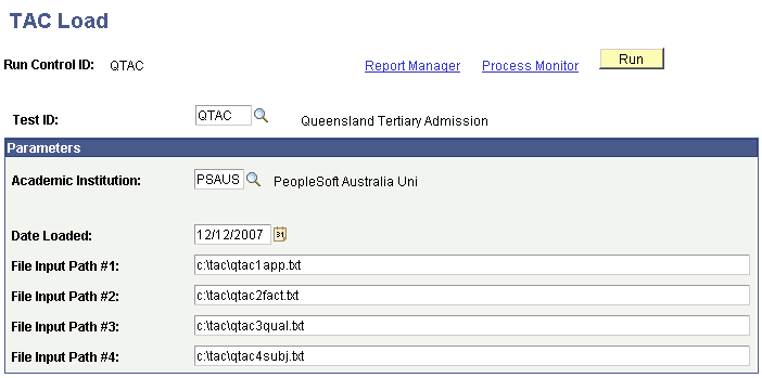

Access the TAC Load page ().
This example illustrates the fields and controls on the TAC Load page. You can find definitions for the fields and controls later on this page.
The number of input files that you can use depends on the TAC test ID that you enter. For example, the TAC Load page displays five file input fields for UAC and thirteen file input fields for SATAC.

Field or Control |
Description |
Test ID |
Enter the TAC test ID that you want to load. Define TAC test ID values on the Test Tables page. Once the TAC test ID is entered, the additional fields specific to the TAC will appear. You must have test ID security established in order to select a value. This field is required. |

File Input Path |
Enter the path of the directory and file where the TAC data resides. These fields are required. How you complete the fields depends on the TAC you are processing. In order for the upload to work correctly, you must list the input files in the correct order. |
Run |
Click the run button to run the SAD_TAC_LOAD Application Engine process at user-defined intervals. |
Note: To check for errors during the program run, review the trace file created by the Application Engine program. Nonfatal errors will appear in the Error Indicators group box in the TAC Suspense component.
