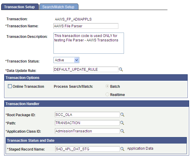

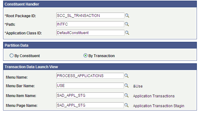

Define and configure an admission transaction that represents data in the external file.
This example illustrates the CTM Transaction Setup page for a bulk load admission transaction (1 of 2).
This example illustrates the CTM Transaction Setup page for a bulk load admission transaction (2 of 2).
Ensure that the following parameters are set up:
Set the Transaction Status as Active.
Deselect the Online Transaction check box. This indicates that the transaction is offline (that is, File Parser will add the data to the stage records offline). This will automatically set Process Search/Match to Batch.
