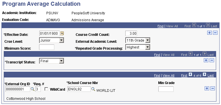

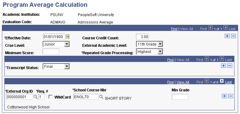

This is an example of Program Average Calculation page (1 of 4).
Select your second prerequisite in the School Course Nbr field and change the Req# value to 2. This tells the system to treat this course as a separate course, and to use the grades that the applicant earned in both of these courses in the calculation. Then insert a row as follows:
This is an example of Program Average Calculation page (2 of 4).
Enter a third course in the School Course Nbr field and change the Req# to 3. Then, insert two more rows and select the remaining two courses, but keep the Req# value the same.

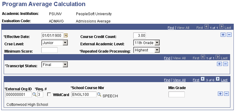

Note in page shot 3 of 4 that Req# is still 3, but you selected a second course.

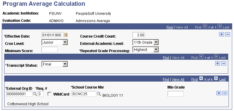

This is an example of Program Average Calculation page (4 of 4).
Note in page shot 4 of 4 that Req# is still 3, but you selected a third course. Because there are three courses with the Req# of 3, the process only uses one of the courses in the calculation. If the applicant took only one of the courses, the system would use that course. If the applicant took more than one of these courses, the system treats the courses as repeated and selects a class to use in the calculation process based on the option selected in the Repeated Grade Processing field.
