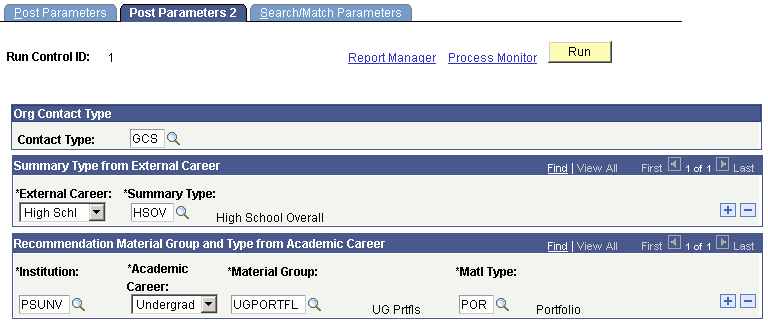

Access the Post Parameters 2 page ().
This example illustrates the fields and controls on the Post Parameters 2 page. You can find definitions for the fields and controls later on this page.
Field or Control |
Description |
Contact Type |
Select the contact type to enable the posting of new organization and organization contact information that is loaded with the TS189 file. |
External Career and Summary Type |
These are cross reference fields that work in conjunction with external academic summary data from incoming applications. The two fields enable the posting of external GPAs to students' external education records (external GPA is tied to summary type, which is a child of external career). External career data is loaded with the TS189 file. By defining desired summary types for each external career that has been loaded, the TS189 PeopleSearch/Post process writes external career, summary type, and external GPA data to the external education record. |
Institution, Academic Career, Material Group, and Matl Type (material type) |
These fields enable the posting of recommendation material group information. Select material groups that represent recommendations and the recommendation material type. Recommendation material group information gets posted to the general materials page. Define material groups on the Material Group Table page. |
