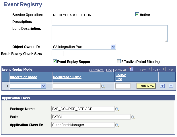

Access the Event Registry page ().
This example illustrates the fields and controls on the Event Registry page. You can find definitions for the fields and controls later on this page.
Field or Control |
Description |
Service Operation |
Enter the service operation that you want to register. For SAIP, you must register these service operations:
Description and Long Description |
Enter descriptions of the service operation. Consider describing its purpose and intended usage. |
Object Owner ID |
Displays the PeopleTools object owner ID that was set when the service operation was defined. |
Batch Replay Chunk Size |
(Not used by SAIP integrations.) Enter the maximum number of rows to send when performing real-time replay of batch updates. |
Event Replay Support |
Select only if the service operation stores event details in a database table for later replay according to a replay schedule. When selected, the Event Replay Mode group box appears. Note: You must select the Event Replay Support check box for each SAIP service operation that you register. Clear the check box if the service operation sends event information immediately. Clear the check box if the service operation sends event information immediately. |
Event Replay Mode
This group box appears only when the Event Replay Support check box is selected.
Field or Control |
Description |
Integration Mode |
Enter the mode in which the events should be replayed. For SAIP event replay, select only the Incremental integration mode. |
Recurrence Name |
Enter the Process Scheduler recurrence definition that defines the frequency with which you want the events to replay. |
Chunk Size |
Enter the maximum number of rows of outgoing event message data to send at a time. |
Run Now |
Click to schedule and run a real-time event replay. |
Application Class
Field or Control |
Description |
Package Name, Path, and Class ID |
Enter the name of the application class root package that contains the PeopleCode class for this service operation. |
Page |
Enter the path to specified application class root package. |
Class ID |
Enter the ID for the application class PeopleCode that provides the service operation implementation. |

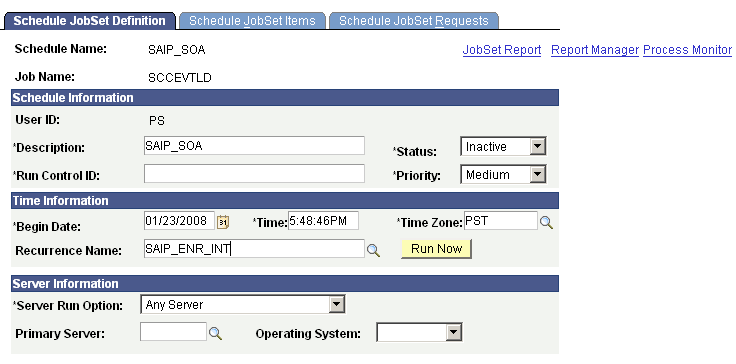

Access the Schedule JobSet Definition page ().
This example illustrates the fields and controls on the Schedule JobSet Definition page. You can find definitions for the fields and controls later on this page.
If the Event Replay Support check box is selected on the Event Registry page, then the Campus Integration framework Event Replay Schedule Load job (SCCEVTLD) with the desired recurrence name is required.
Note: This job must run at installation and at any time that the recurrence name on the Event Registry page changes.
SCCEVTLD evaluates the event registry for integration points that support event replay. For each potential event replay integration point, SCCEVTLD loads a new Process Scheduler recurring job with the recurrence schedule that is specified on the corresponding service operation's Event Registry page. At the specified time, the loaded job runs and subsequently replays event data stored for that integration point.
Create a schedule name, and schedule the Event Replay Schedule Load job, SCCEVTLD. Enter the recurrence name for the frequency at which the events should replay.

Recurrence Name |
Enter the name of the recurrence pattern that is set on the Recurrences Definition page for this service operation. |
Run the process as you would any Process Scheduler job.
