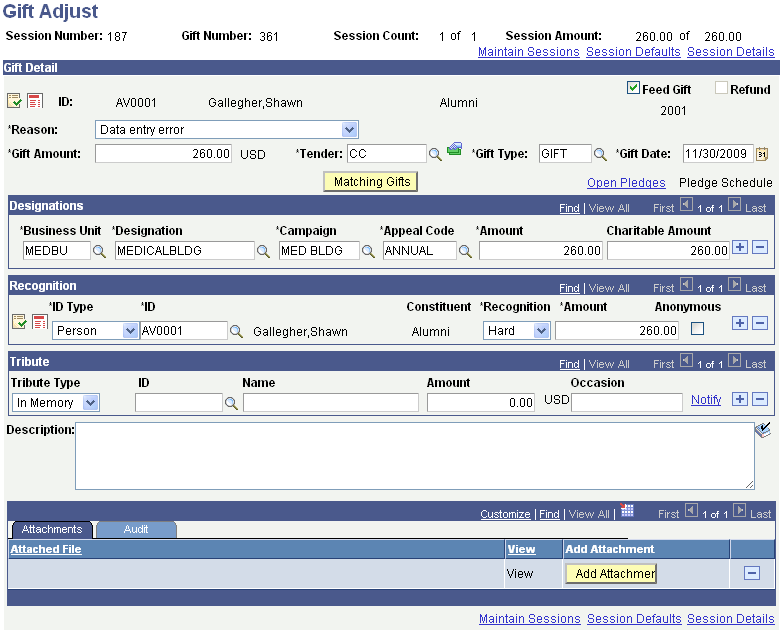

This example illustrates the fields and controls on the Gift Adjust page. You can find definitions for the fields and controls later on this page.

Field or Control |
Description |
Reason |
You must select a reason for the adjustment. Reasons are defined by your institution, and describe the reason why an adjustment is made. |
Refund |
Select if the gift adjustment results in a refund to the donor. If this check box is selected, when you run the GL Interface process on this adjustment session, the system creates a row in the CR Holding Account that indicates the donor is owed a refund. |
Click the links at the bottom of this page to access the Maintain Sessions, Session Defaults, and Session Details pages, where you can view information about the session that contains the adjusted transaction.
Recognition
In this group box, you can enter soft-dollar gifts and soft credit-only gifts.
Click the View link to open the attachment in a new window. Click the Add Attachment button to upload a new attachment from within the component.
