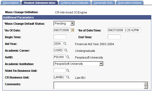

Access the Student Administration page (Contributor Relations > Initiatives > Process Initiatives > Initiative Mass Change > Student Administration).
This example illustrates the fields and controls on the Student Administration page. You can find definitions for the fields and controls later on this page.
Field or Control
Description
Academic Institution
Enter the institution for which the communications are to be created when the mass change process is run.
CR Business Unit
For a membership mass change, enter the CR Business Unit that owns the membership organization for which the mass change is to be run. This business unit determines which membership organizations appear in the Membership Organization field on the Criteria and Defaults page.

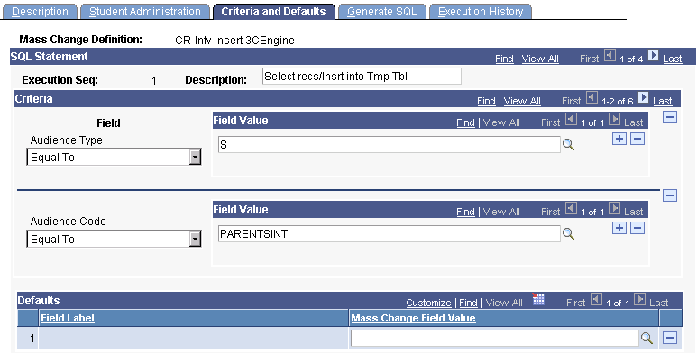

Access the Criteria and Defaults page (Contributor Relations > Initiatives > Process Initiatives > Initiative Mass Change > Criteria and Defaults).
Note: If you are running mass change for an initiative, select the CR-Intv-Insert3CEngine mass change definition. If you are running mass change for a membership organization, select the CR-Mbrshp-Insert3CEngine mass change definition.
This example illustrates the fields and controls on the Criteria and Defaults page. You can find definitions for the fields and controls later on this page.
Field or Control
Description
Criteria
Set criteria values using SQL operators and values. For example, to select an audience type of Segmentation, you would select Equal To and enter a field value of S.
You must have a thorough understanding of your data and dependencies before selecting criteria. Many codes are not intuitive, and many fields are dependent upon others. For example, a dues level must be related to a specific member organization, but the prompts are not hierarchical.
Field
You can enter only one SQL operator per criteria. However, if you select a criteria option such as In, you can list multiple values by placing the cursor in the Field Value field and inserting rows.
