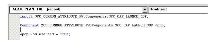

Inline Code example
The following inline code example uses the Academic Structure, Academic Plan Table ACAD_PLAN_TBL record and page.
On the SCC_CAF_LAUNCH_SBP subpage, in the RowInsert event of the CAF-enabled record, set the RowInserted property to True. We recommend you add the following inline code in the Component Record PeopleCode:
import SCC_COMMON_ATTRIBUTE_FW:Components:SCC_CAF_LAUNCH_SBP;
Component SCC_COMMON_ATTRIBUTE_FW:Components:SCC_CAF_LAUNCH_SBP &pop;
&pop.RowInserted = True;
This example illustrates using inline code on the SCC_CAF_LAUNCH_SBP subpage.

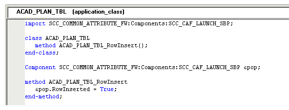

Application Class Code Example
On the SCC_CAF_LAUNCH_SBP subpage, in the RowInsert event of the CAF-enabled record, set the RowInserted property to True. We recommend this method if other Component PeopleCode has been administered or is to be administered in a dedicated Application Class.
Set the RowInserted property by adding a new method to either to an existing application class or to a new application class. In this example, the method is added to SSR_COMMON_UTILITIES:COMPONENTS.
import SCC_COMMON_ATTRIBUTE_FW:Components:SCC_CAF_LAUNCH_SBP; Class ACAD_PLAN_TBL Method ACAD_PLAN_TBL_RowInsert(); End-class; Component SCC_COMMON_ATTRIBUTE_FW:Components:SCC_CAF_LAUNCH_SBP &pop; method ACAD_PLAN_TBL_RowInsert &pop.RowInserted = True; end-method;
This example illustrates using application class code on the SCC_CAF_LAUNCH_SBP subpage.

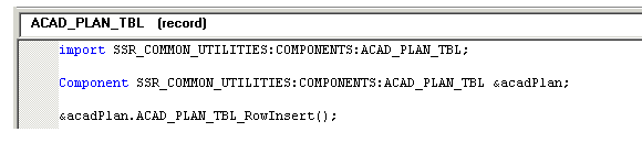

Call the new method in the record’s RowInsert event.
import SSR_COMMON_UTILITIES:Components:ACAD_PLAN_TBL; Component SSR_COMMON_UTILITIES:Components:ACAD_PLAN_TBL &acadPlan; &acadPlan.ACAD_PLAN_TBL_RowInsert();
