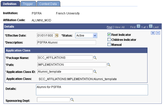

Access the Definition page ().
This example illustrates the fields and controls on the Definition page. You can find definitions for the fields and controls later on this page.
Campus Solutions delivers five predefined Affiliation Code examples: Alumni, Recruiter, Applicant, Student, and Non-Student Employee. The Application Class and the triggering event information is already set up for these codes. You can define the details of an affiliation code, and assign it a place in a hierarchy. Hierarchies of affiliation are designated with the Root Indicator and Children Indicator check boxes.

Field or Control |
Description |
Package Name |
Select an Application Class Package ID. A SCC_AFFILIATIONS Package ID is delivered with Campus Solutions. |
Path |
Select a Qualified Package/Class Path for the selected Package Name. An IMPLEMENTATION Qualified Package/Class Path for Package ID SCC_AFFILIATIONS is delivered with Campus Solutions. |
Application Class ID |
Select an Application Class ID for the selected Package Name and Path. The Alumni_template, Applicant_template, Employee_template Recruiter_template,Student_template, and Application Path IDs for Package ID SCC_AFFILIATIONS and Qualified Package/Class Path IMPLEMENTATION are delivered with Campus Solutions. |
Application Class |
Displays the Application Class created by selection of the Package Name, Path, and Application Class ID on this page and assigned for this Affiliation Code The Application Class field is specified on the last node or leaf of the hierarchy, at the lowest level when defining a triggered affiliation code. The class is created in App Designer and contains the implementation logic or transaction validation logic for the specific affiliation code. The system uses the class defined here to determine which affiliations are set and not set for a person. The PeopleSoft system delivers five application class templates. Each template file name ends with "_template":

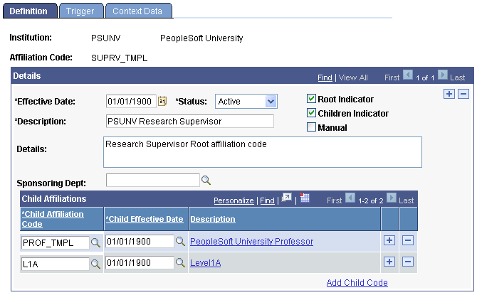

Child Affiliations
You can enter child affiliations in two ways: click the Add Child Code link to actually create the child affiliation code or select a Child Affiliation Code, if one has already been defined.

Add Child Code |
Click this link to create a new individual child affiliation code (on a second Definition page). After you create and save the child affiliation code, the system returns to the original Definition page and the Child Affiliation Code becomes available to be selected and assigned. |
Child Affiliation Code |
Select an existing code to assign to the child level of the affiliation at the institution. |

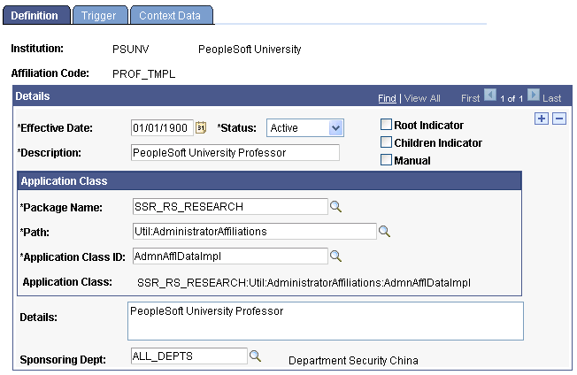

Single-Level Hierarchy Example
In this example, the Root Indicator check box is selected and the Children Indicator check box is clear. This specifies that there are no additional subcategories or children associated with this affiliation code. Since this is the lowest level in the hierarchy, the application class is entered here to define the transactional logic.
This example illustrates the fields and controls on the Single-level hierarchy example. You can find definitions for the fields and controls later on this page.

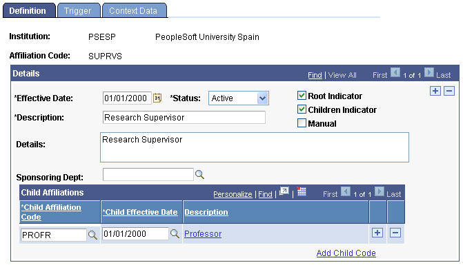

Two-Level Hierarchy Example
In this example, the Root Indicator check box is selected and the Children Indicator check box is selected for the parent/root affiliation. This specifies that the root has additional subcategories or children associated with it. When you select the Children Indicator check box, you can then enter an associated Child Affiliation Code that has already been defined.
This example illustrates the fields and controls on the Two-level hierarchy example (1 of 2). You can find definitions for the fields and controls later on this page.
The lowest level of a hierarchical affiliation does not have the check boxes for either Root Indicator or Children Indicator selected. In a two-level hierarchy, the child of the affiliation has no indicator boxes checked and the Application Class field contains the actual affiliation application class value.
This example illustrates the fields and controls on the Two-level hierarchy example (2 of 2). You can find definitions for the fields and controls later on this page.
Three-or-More-Level Hierarchy Example
In this example, both the Root Indicator check box and the Children Indicator check box are selected for the parent/root affiliation code. This specifies that the root has additional subcategories or children associated with it. When you select the Children Indicator check box, you can then define or enter an associated Child Affiliation Code that has already been defined.
This example illustrates the fields and controls on the Three-or-more level hierarchy example (1 of 3). You can find definitions for the fields and controls later on this page.
For the middle-level affiliation codes, the Root Indicator check box is cleared and the Children Indicator check box is selected. This specifies that the affiliation code is not the root and it has additional subcategories associated with it. When you select the Children Indicator check box, you can then enter the associated Children Affiliation Code that has already been defined for this affiliation code.
This example illustrates the fields and controls on the Three-or-more level hierarchy example (2 of 3). You can find definitions for the fields and controls later on this page.
The lowest level of a hierarchical affiliation does not have the boxes for Root Indicator or Children Indicator selected. These are left clear and the Application Class contains the actual affiliation application class value.
This example illustrates the fields and controls on the Three-or-more level hierarchy example (3 of 3). You can find definitions for the fields and controls later on this page.

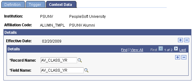

Access the Context Data page ().
This example illustrates the fields and controls on the Context Data page. You can find definitions for the fields and controls later on this page.
The Context Data tab of the Affiliation Setup component is used to associate additional record/field pairs with the Affiliation Code. These details are then included as part of the data when the Affiliation event message is published. Up to ten separate record/field pairs may be defined.

Record Name |
Select the Record Name table or Record Name for the Field Name you want to associate with the Affiliation Code. |
Field Name |
Select the Field Name you want to associate with the Affiliation Code and publish within the Affiliation message. |
