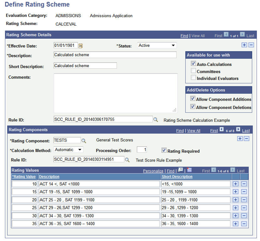

Access the Define Rating Scheme page (
).This example illustrates the fields and controls on the Define Rating Scheme page. You can find definitions for the fields and controls later on this page.
Available for use with
The options in this group box determine how a rating scheme can be used, whether by a Committees scheme, Individual Evaluators scheme, or by a scheme that uses Auto-Calculations. These settings control the values available for the Rating Scheme fields of the Committee Scheme and Individual Evaluator setup and the Rating Scheme field on the Evaluation Code setup. Committee Scheme and Individual Evaluator may be used concurrently. If you select Auto-Calculations, the other two options are unavailable. When you select Auto-Calculations, two Rule ID fields become available on the page: one at the scheme level and one for each rating component.
Note: A rating scheme marked as Auto-Calculations cannot also be used as an Individual Evaluator scheme or Committee scheme.

Field or Control |
Description |
Allow Component Deletion |
This option controls behavior on the Manage Evaluation component. Select this option to allow the system or a user to delete components under this scheme from an ID’s evaluation record if the status for that scheme is not Final. |
Allow Component Addition |
This option controls behavior on the Manage Evaluation component. Select this option to allow the system or a user to add components under this scheme to a specific ID’s evaluation record if the status for that scheme is not Final. The system prompts against valid designated rating scheme values. |
Rule ID
This field becomes available in the Rating Scheme Details group box when the rating scheme is marked for Auto-Calculations. This field is optional. When populated, the system will use this rule to calculate the Overall Rating value for the scheme. If no rule is designated for a rating component, then the system will calculate the Overall Rating using an average of the rating component values.
This field prompts from the values in the Rules Engine tables.
Rating Components
The fields in this group box define what evaluators can change or modify during the evaluation process.
Field or Control |
Description |
Rating Component |
Rating components roll up under the rating scheme. Rating components are defined on the Define Rating Component page. |
Calculation Method |
This field has no impact in the system. |
Processing Order |
This value is used by the system when the Auto-Calculations option is selected. Components that use Rules will be evaluated according to the Processing Order. |
Rating Required |
Select this check box to determine whether, on the Manage Evaluation component, this component rating must be completed by the evaluator or by an auto-calculation. If selected, the evaluation cannot be marked final unless this rating is populated. |
Rule ID |
This field becomes available when the rating scheme is marked for Auto-Calculations. This field is optional. When populated, the system will use this rule to calculate the rating value for the component. If no rule is designated for a rating component, it is assumed that the rating value will be populated manually. This field prompts from the values in the Rules Engine tables. |
Rating Value |
