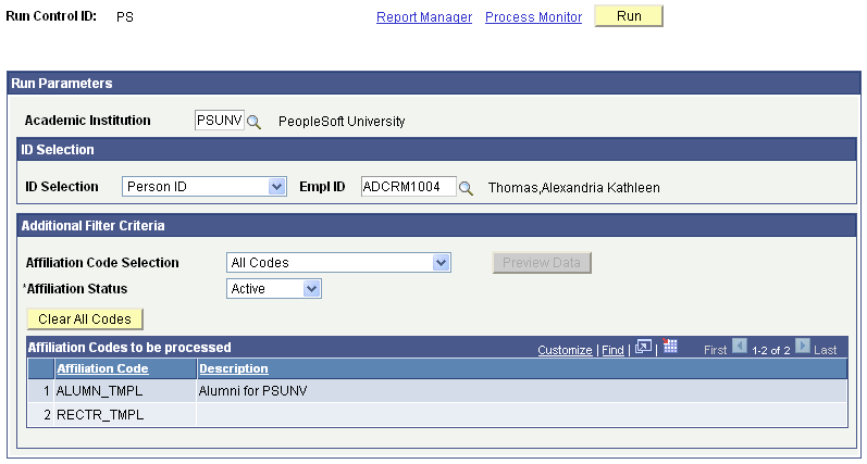

Access the Affiliation Select Delete Processing page (
).This example illustrates the fields and controls on the Affiliation Select Delete Processing page. You can find definitions for the fields and controls later on this page.
ID Selection
Field or Control |
Description |
ID Selection |
Select either Person ID or Population Selection. If you select Person ID, enter a single ID to list affiliation code(s) associated with this ID. If you select Population Selection, the Population Selection group box appears. Enter a Selection Tool (either External File or PS Query) and the corresponding values for the fields associated with that selection tool. |
Empl ID |
Enter the ID for the person for whom you want to delete affiliation code(s). |
Additional Filter Criteria
Field or Control |
Description |
Affiliation Code Selection |
Select All Codes or One or More Codes. If you select All Codes, the system evaluates all affiliation codes currently available within an institution for the person. Select One or More Codes to specify the exact affiliation code or codes to be evaluated for the person. |
Affiliation Status |
Select the status of the affiliation code you are considering deleting. System-defined affiliation status values are Active, Inactive, or Error. |
Clear All Codes |
Click this button to remove all affiliation codes listed to be processed as listed in the group box. You can use this button regardless of whether you are referring to a code for one person or you use Population Selection. |
Preview Data |
This button appears after you click the Run button to run the SCC_AFL_PRDL process that creates the people/affiliation code pairs that meet the criteria specified by the filter. This is the group that can be acted upon to delete affiliations. The Preview Data button is unavailable for selection until the process has been run. |
