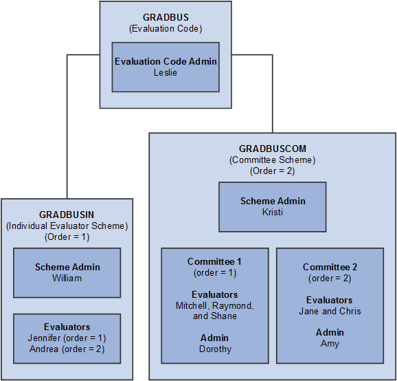

This graphic illustrates an example of evaluation code setup:

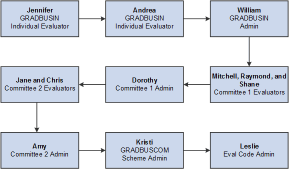

This graphic illustrates the order in which workflow processes the evaluators and administrators based on above example setup:

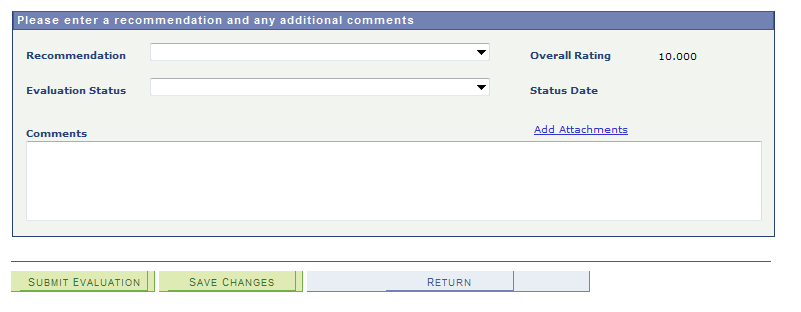

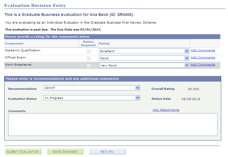

This is an example of Evaluation Decision Entry page for an Individual Evaluator:

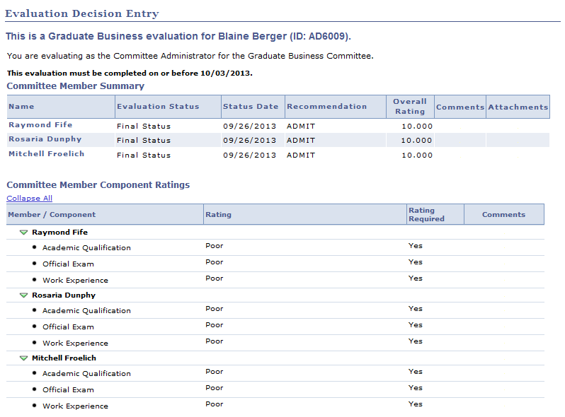

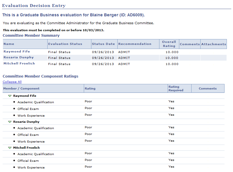

This is an example of Evaluation Decision Entry page for a Committee Administrator (1 of 2):
This is an example of Evaluation Decision Entry page for a Committee Administrator (2 of 2):

Note: The Evaluation Decision Entry page functionality is similar to the Manage Evaluation component. The Managing Evaluations topic describes the Manage Evaluation component. Therefore, refer to the Managing Evaluations topic for more information about the fields on the Evaluation Decision Entry page. There are however few differences between the Evaluation Decision Entry page and Manage Evaluation component. One difference is that on the Evaluation Decision Entry page, the evaluator is only seeing that portion he or she needs to work on. Another difference is the Submit Evaluation, Save Changes, and Return buttons that only appear on the Evaluation Decision Entry page. Clicking the Submit Evaluation button finalizes the evaluation and removes the evaluation from the worklist. The evaluator cannot access that evaluation again. Clicking the Save Changes button will save the work-in-progress and the evaluation will remain in the worklist, allowing the evaluator to re-access and complete the evaluation. Finally, clicking the Return button will return the evaluator to the worklist.

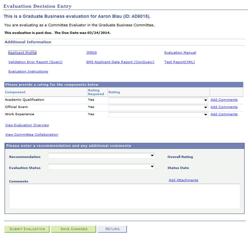

This is an example of the decision entry page that shows the Additional Information section, and the View Evaluation Overview and View Committee Collaboration links.

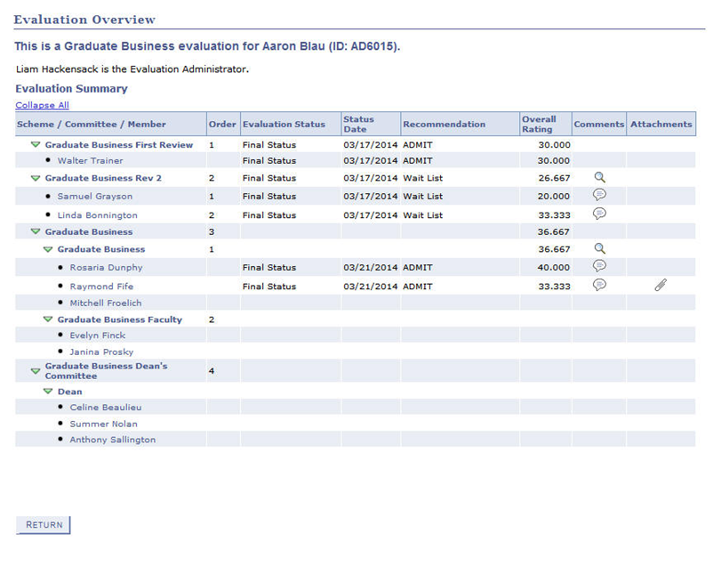

This is an example of the Evaluation Overview page.
In the above example, the view is given to all levels of the evaluation: orders which have completed before this evaluator’s turn for the evaluation as well as visibility of which order will occur beyond the evaluator’s order in the evaluation.

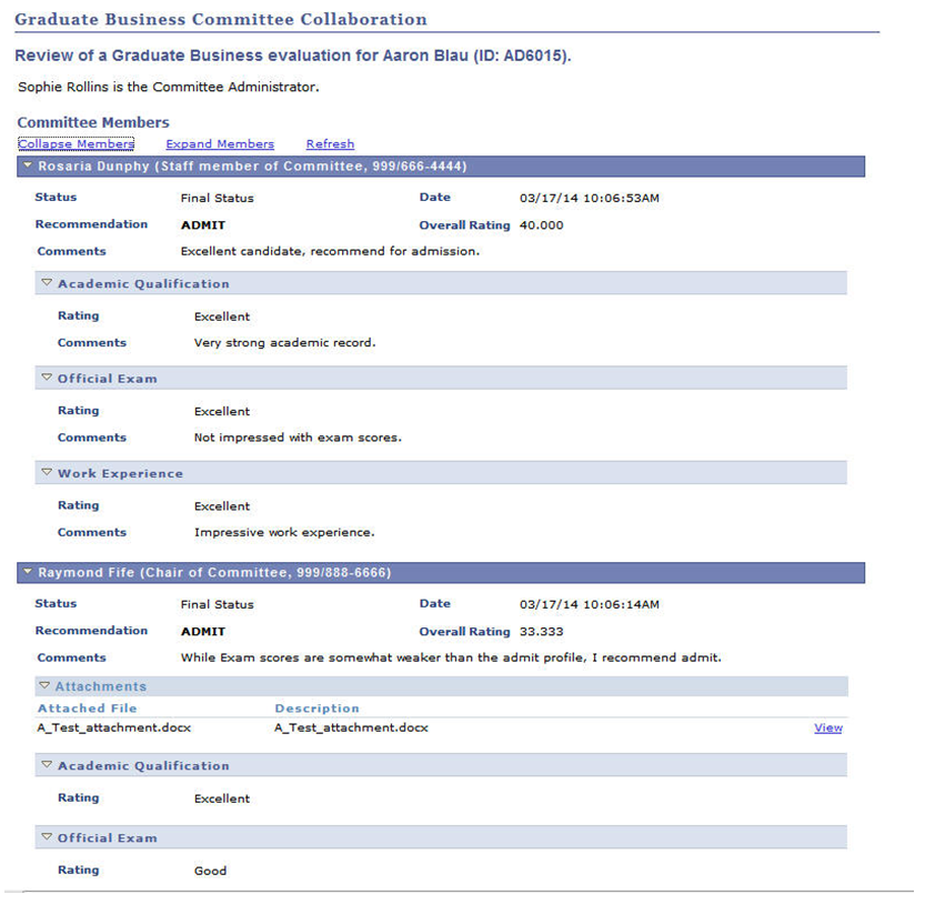

This is an example of the Committee Collaboration page.
The ratings, recommendations, comments and attachments are made available to all committee members. The Refresh link refreshes the data to capture any recent changes made by other committee members.
