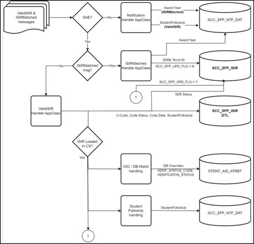

Here is the CS/SAE Message Handling Flow:

These are the Notification Events currently supported in the SAE Pull Process:
FasStudentNotificationEvent.
FasDocumentRequestEvent.
FasDocumentRejectedEvent.
FasLetterNotificationEvent.
FasValidIsirProcessStatusInformationEvent.
ISIR entry saved only if its corresponding
StudentFollowUpvalue isTrue.
