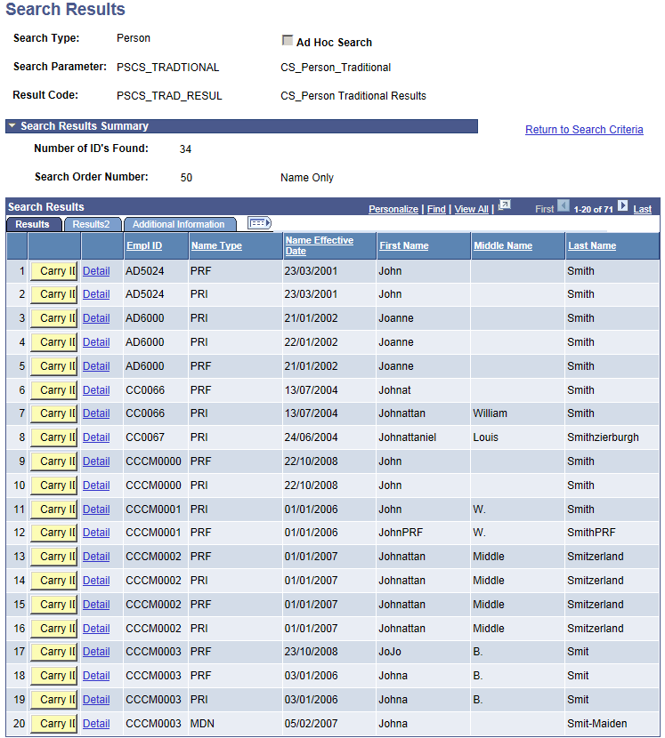

Access the Integrated Search Results page (Click the Search button or one of the available Selective Search buttons on the Search Criteria page). If the External Search/Match is triggered and the system has found matching candidates on a search rule number lower or equal to the Search/Match, the Integrated Search Results page appears.
This example illustrates the fields and controls on the Integrated Search Results page.
Many fields on this page are the same as those on the Search Results page. However, there are some important distinctions:
Records with no EmplIDs appear first in the Search Results group box.
Records with no EmplIDs are assigned an External Sys ID.
Records with no EmplIDs, that are importing EmplIDs from an external system, are assigned an External Sys ID and display the External Employee ID.
Where an EmplID exists, the Detail link leads to a page where you can view details of the ID record from the CS system.
Where no EmplID exists, the Detail link leads to a page where you can view details of the data from the external system.
The Import button appears when a person meets the criteria in the external system.
The Score % and Universal ID columns appear based on settings defined on the External System Search Match Options page.
Masking configuration is in effect for all matching constituents, even those with no EmplID.
For matching constituent records found by External Search/Match, this page displays information that is not necessarily stored inside the external system (for example, Aid Year).

Number of ID's Found |
The system displays the total number of distinct IDs returned by both Search/Match and External Search/Match, just Search/Match, or just External Search/Match. |
Search Order Number |
The system shows the Search Order Number where results were found. When the internal and external searches find results under different search rules, the Results Engine evaluates the Search Order Number returned by both searches and displays the results for the search that found results under the smallest search order number (the most restrictive search). When the internal and external searches find results under the same search rule, the Results Engine displays them both. |
Search Results
The fields in this group box are similar to those on the Search Results page. The system displays the results returned from both the CS database and the external system, along with additional data to describe the IDs retuned. However, the columns are dynamic and they can refer to personal data info or transaction data info. Define static columns to appear here on the External System Search Match Options page.

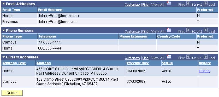

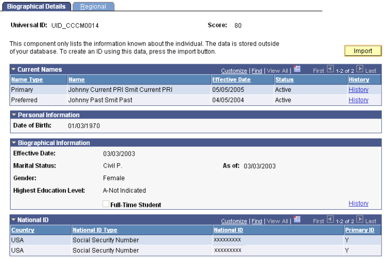

Access the Biographic Details page (click the Detail link on the Integrated Search Results page).
This example illustrates the fields and controls on the Biographical Details page (1 of 2). You can find definitions for the fields and controls later on this page.
This example illustrates the fields and controls on the Biographical Details page (2 of 2). You can find definitions for the fields and controls later on this page.
This page displays sections of data that are not actually stored in the CS database until you click the Import button.
The system displays messages on this page based on the following conditions:
Note: Where no data exists, the system hides the fields and displays a message in the Missing Information group box.

Field or Control |
Description |
Import |
Click this button to import the Universal ID and all the information displayed into the CS system and create an EmplID. |

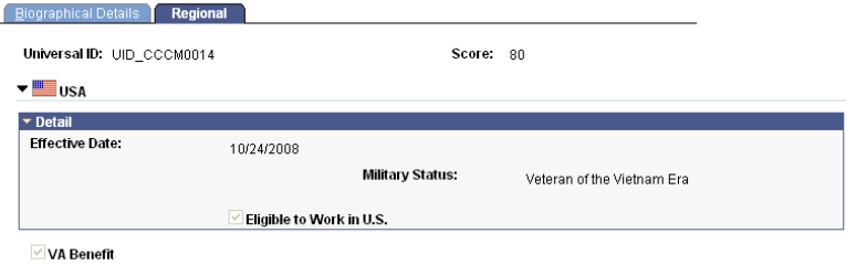

Access the Regional page (click the Detail link on the Integrated Search Results page, then Regional tab).
This example illustrates the fields and controls on the Regional page. You can find definitions for the fields and controls later on this page.
This page is available only if it contains data. If the Fetch Response contains no Regional information, this message appears on the Missing Information group box on the Biographical Details page.
