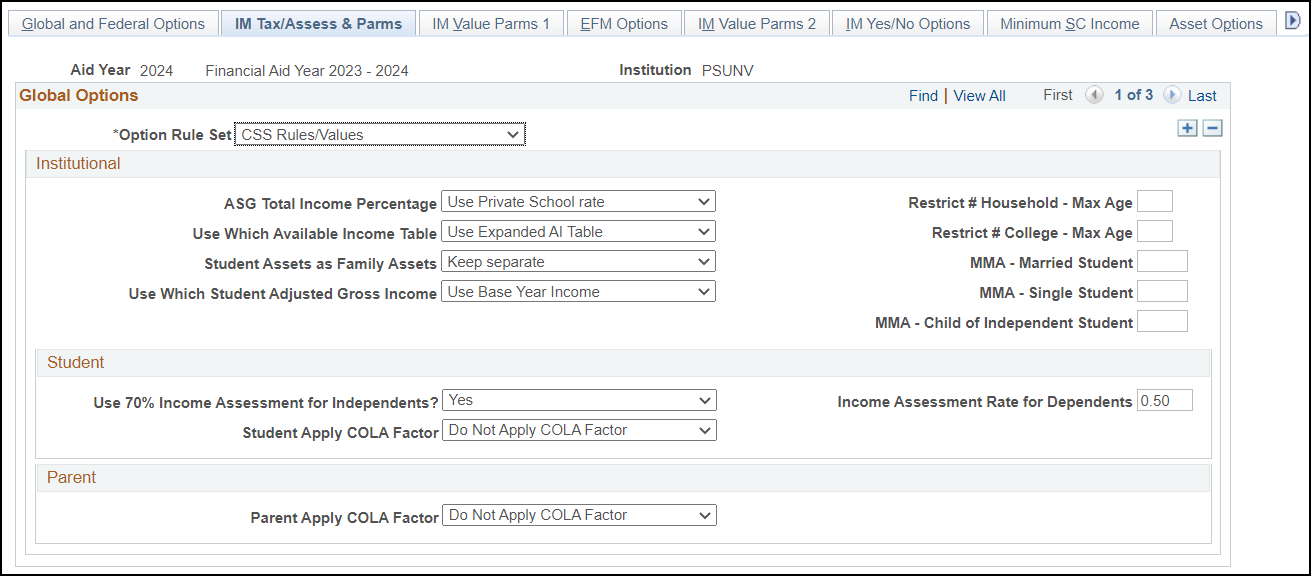

IM Tax/Assess Parms (institutional methodology tax assessment parameters)
INAS_LCL_PLCY2_nn
Set Up SACR > Product Related > Financial Aid > Application Processing > NA 20nn–20nn Global Options > IM Tax/Assess Parms
Define IM INAS calculation options for parents and students
Note: This page is only used for 2023-2024 and prior Aid Years.

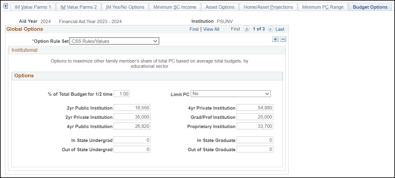

Budget Options
INAS_LCL_PLCY9_nn
Set Up SACR > Product Related > Financial Aid > Application Processing > NA 20nn–20nn Global Options > Budget Options
Define allocation of total parental contribution to children on the basis of educational costs.

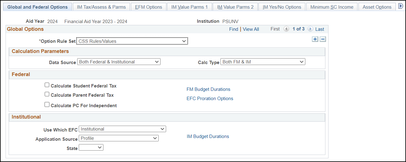

Use this page to define EFC calculation Global and Federal Options for ISIR records or Profile records by Aid Year and Institution.
Note: The system always makes available the three most recent Aid Year versions of the EFC Global Options component. For the 2021-2022 and 2022-2023 Aid Years, the page name remains "INAS 20nn-20nn Global Options". For the 2023-2024 and future Aid Years, the navigation is "NA 20nn-20nn Global Options".
Access the Global and Federal Options page (Set Up SACR > Product Related > Financial Aid > Application Processing > NA 20nn–20nn Global Options > Global and Federal Options).
This example illustrates the fields and controls on the Global and Federal Options page. You can find definitions for the fields and controls later on this page.
Use this page to set the EFC calculation options for ISIR or Profile records.
Field or Control
Description
Option Rule Set
Select the Option Rule Set.
The Option Rule Set value enables full flexibility to determine how need analysis is processed for different academic careers or academic programs; it is linked to a specific academic career or program through the valid careers for aid year and valid programs for aid year tables. Your institution can create additional Option Rule Sets. The Option Rule Set refers to the Option Base Rules delivered with the Financial Aid system. Values are: CSS Rules/Values, Health Professional, and Undergraduate/Graduate.
Global
Use the Global group box to define the parameters that control general processing options related to methodologies used.
Field or Control
Description
Data Source
Select the Data Source that you want the EFC Calculation process to use to retrieve student information. Select:
Both Federal & Institutional (both federal and institutional) to use both sets of data to calculate EFCs for either Profile or ISIR records.
Federal Data to use only federal data to calculate a FM EFC for ISIR records only.
Institutional to use only institutional data to calculate an IM EFC for PROFILE records only.
Calc Type (calculation type)
Select the calculation type:
Federal Methodology to calculate a FM EFC for ISIR records only.
Both FM & IM (both federal methodology and institutional methodology) to calculate EFCs for either PROFILE or ISIR records.
Institutional Methodology to calculate an IM EFC for PROFILE records only.
Federal
Use the Federal group box to define how the Federal Methodology Need Analysis Calculator (FM NAC) processes federal ISIR data.
Field or Control
Description
Calculate Student Federal Tax
Select to calculate student federal tax as defined by the federal tax bracket and rate for the applicable tax year.
Calculate Parent Federal Tax
Select to calculate parent federal tax as defined by the federal tax bracket and rate for the applicable tax year.
Calculate PC for Independent (calculate parent contribution for independent students)
Select to calculate a parental contribution for independent students if parental data is available. The parental contribution is calculated, but not added to the EFC.
FM Budget Durations
Click this link to access the FM Budget Durations page, which shows academic and non-standard durations for both dependent and independent students.
EFC Prorations Options
Click this link to access the EFC Proration Options page.
Institutional
Use the Institutional group box to define how INAS computes your IM.
Field or Control
Description
Use Which EFC
Select a value to determine the institutional EFC displayed on the Need Summary page and used in the Award Entry component. Values are:
Estimated Federal (estimated federal methodology): Select to display and use the EFM-EFC.
Greatest: Select to compare base, IM with options, and estimated federal EFC, and then use the greatest EFC value of the three.
Institutional W/Opt: Select to use the IM-EFC as a result of the calculation of IM with options.
Institutional: Select to use the IM-EFC as a result of the base IM calculations.
Application Source
Select an application source. Values are:
FT Canada Student Loan (full-time Canada Student Loan): Used in Canadian Need Analysis.
Institutional Application.
PT Canada Student Loan (part-time Canada Student Loan): Used in Canadian Need Analysis.
Profile.
State
Select the state in which your institution is located. INAS uses this field to determine a student's budget requirements.
IM Budget Durations
Click this link to access the IM Budget Durations page, which shows academic and non-standard durations for both dependent and independent students.

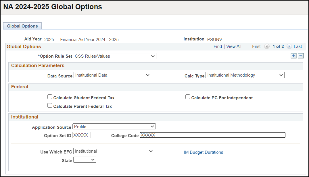

Use this page to define FM Student Aid Index (SAI) IM Expected Family Contribution (EFC) calculation Global Options for ISIR records or Profile records by Aid Year and Institution for the 2024-2025 and future Aid Years.
Access the Global Options page (Set Up SACR > Product Related > Financial Aid > Application Processing > NA 20nn–20nn Global Options > Global Options).
This example illustrates the fields and controls on the Global Options page. You can find definitions for the fields and controls later on this page.
Need Analysis Global Options
Use this page to set the FM SAI and IM EFC calculation options for ISIR or Profile records, respectively.
Field or Control
Description
Option Rule Set
Calculation Parameters
Use the Calculation Parameters group box to define the parameters that control general processing options related to methodologies used.
Field or Control
Description
Data Source
Select the Data Source that you want the FM SAI/IM EFC Calculation process to use to retrieve student information. Select:
Both Federal & Institutional (both Federal and institutional) to use both sets of data to calculate FM SAIs/IM EFCs for either ISIR or Profile records.
Federal Data to use only federal data to calculate a FM SAI for ISIR records only.
Institutional to use only institutional data to calculate an IM EFC for Profile records only.
Federal Methodology to calculate a FM SAI for ISIR records only.
Both FM & IM (both federal methodology and institutional methodology) to calculate FA SAIs/IM EFCs for either ISIR or Profile records.
Institutional Methodology to calculate an IM EFC for Profile records only.
Federal
Use the Federal group box to define how the Federal Methodology Need Analysis Calculator (FM NAC) processes federal ISIR data to calculate an SAI.
Field or Control
Description
Institutional
Use the Institutional group box to define how INAS computes your IM EFC.
Field or Control
Description
Application Source
The Application Source is Profile.
Option Set ID
Enter the token ID provided by the College Board for each Global Option that is created within the College Board’s Need Analysis Options (NAO) website. You are required to setup an Option Rule Set for each Global Option created in the NAO website.
College Code
Enter the College Code provided by the College Board for your institution.
Use Which EFC
State
IM Budget Durations

Use this page to define IM Tax and Assessment parameters for both Dependent and Independent students.
Note: This setup is only used for 2023-2024 and prior Aid Years. For 2024-2025 and future Aid Years, this setup is done on the College Board’s Need Analysis Options (NAO) website.
Access the IM Tax/Assess & Parms page (Set Up SACR > Product Related > Financial Aid > Application Processing > NA 20nn–20nn Global Options > IM Tax/Assess Parms).
This example illustrates the fields and controls on the IM Tax/Assess & Parms page. You can find definitions for the fields and controls later on this page.
IM (institutional methodology) Tax/Assess and Parms (parameters) page
Institutional
Field or Control
Description
ASG Total Income Percentage (annual savings goal total income percentage)
Select a value to determine an appropriate ASG total income percentage. This percentage is used as an allowance against income.
Values are:
  • Use Private School rate. This is the default option.
  • Use Public School rate.
  • Use Public/Private School rate.
Note: College Board CSS Profile users should refer to the College Board's Financial Aid Services Information Center (https://groups.collegeboard.org/fas) for supporting documentation.
Use Which Available Income Table
Select a value to determine which Available Income Assessment Rate table to use. Values are:
  • Use Expanded AI (available income) table. This is the default value.
  • Use Legacy AI (available income) table.
Studnt Assets as Family Assets (student assets as family assets)
Select All Student Assets to have all of the student's assets count as parent assets. Student assets are summed in the parent column. These calculation adjustments occur:
  1. Family Total Net Worth (FTNW) FTNW = Parents' Total Net Worth (NW) + Student's Total NW.
  2. Family Discretionary Net Worth (FDNW) FDNW = FTNW - Asset Protection Allowances.
  3. The Asset Conversion rate is then applied to the FDNW to produce the family contribution from assets (FCA) where PC (parental contribution) = PCI (parent contribution from income) + FCA, and TFC (total family contribution) = PC + SCI (student contribution from income).
  4. In the student column, student assets equal zero and student contribution (SC) = SCI, because all student assets have been moved to the parent column.
Select All but Trusts to have all of the student's assets except for the value of trust funds count as parent assets. The only student assets summed in the student column are trust funds. These calculation adjustments occur:
  1. Family Total Net Worth (FTNW) FTNW = Parents' Total Net Worth (NW) + (Student's Total NW - Student's Value of Trusts).
  2. Student Contribution From Assets (SCA) SCA = Student's Value of Trusts * Asset Conversion rate.
  3. Family Discretionary Net Worth (FDNW) FDNW = FTNW - Asset Protection Allowances.
  4. The Asset Conversion rate is then applied to the FDNW to produce the family contribution from assets (FCA) where: PC (parental contribution) = PCI (parent contribution from income) + FCA, SC (student contribution) = SCI (student contribution from income) + SCA, and TFC (total family contribution) = PC + SC.
Select Keep separate to use the default calculation. Parent assets are summed in the parent column and student assets are summed in the student column. If you leave this field blank, the system automatically enters Separate and uses the default calculation.
Select Stu Assets 5% and Trusts 25% to have the EFC calculation process assess student assets at 5 percent and the student's trust funds at 25 percent when calculating the student contribution portion of the EFC.
Use Which Student AGI (use which student adjusted gross income)
Select how the student adjusted gross income is represented:
  • Use Anticipated Year Income
  • Use Base Year Income
Field or Control
Description
Rstrct # Household - Max Age (restrict number in household - maximum age)
Enter the value. You can restrict the family size used in the calculation by establishing an age threshold for siblings or dependents. For example, the calculation would not include an allowance for a member in the household over the maximum age set by the institution.
Rstrct # in College - Max Age (restrict number in college - maximum age)
Enter the value. You can restrict the number in college used in the calculation by establishing an age threshold for family members in college. For example, the calculation would not include an allowance for a member of the household in college over the maximum age set by the institution.
MMA-Married Student (monthly maintenance allowance for married student)
Enter a value to override the default MMA rate for a married student.
MMA-Single Student (monthly maintenance allowance for single student)
Enter a value to override the default MMA rate for a single independent student.
MMA Child of Indep Student (monthly maintenance allowance for child of an independent student)
Enter a value to override the default MMA rate for a child of an independent student.
STUDENT
Field or Control
Description
Use 70% Income Assmnt for Ind (use 70 percent income assessment for independent)
This field refers to the available income assessment rate for independent students. Select from these values:
  • Yes: Uses 70 percent for income assessment. This is the default.
  • No: Select if you elect not to use the 70 percent income assessment; the Alt Income Assessment Rate field appears on the page.
Alt Income Assessment Rate (alternate income assessment rate)
When you select No for the Use 70% Income Assmnt for Ind option, enter the Alt Income Assessment Rate.
Available options:
Blank = No alternate rate provided; INAS will use the standard income assessment rate for independent students
nnn = User defined number value; activate an alternate user-defined rate between 0% and 100%. For example, to specify 50%, enter "050"’. Entering "000" sets the rate to 0%.
Income Assmnt Rate for Dep (income assessment rate for dependent)
Enter an income assessment rate for dependent students. The default is 50 percent.
Student Apply COLA Factor (student apply cost of living adjustment factor)
  • Do not apply COLA factor
  • Apply COLA factor
PARENT
Field or Control
Description
Parent Apply COLA Factor (student apply cost of living adjustment factor)
  • Apply COLA factor

Use this page to define budget (cost of attendance) options.
Access the Budget Options page (Set Up SACR > Product Related > Financial Aid > Application Processing > NA 20nn–20nn Global Options > Budget Options).
This example illustrates the fields and controls on the Budget Options page. You can find definitions for the fields and controls later on this page.
Budget Options page
Institutional
Field or Control
Description
% of Total Budget for 1/2 time (percentage of total budget for half-time)
Enter a percentage of the total budget that you want to use for a student attending an institution half-time.
Note: The value 1.00 is equal to 100 percent.
Limit PC (limit parental contribution)
Select a parental contribution limit. Values are:
No: Select for no parental contribution limit.
Yes; % Total Budget (yes; percentage of total budget): Select to have the parental contribution limited to the student’s cost of attendance budget divided by the total of the cost of attendance budgets of all children in the family attending college.
Yes; Highest PC from Sum and % (yes; highest parental contribution from sum and percentage) Select to compare the parental contribution limits set by Yes; % Total Budget (yes; percentage of total budget) and Yes; Sum of Budget: and set the limit to the higher value.
Yes; Sum of Budget: Limit the parental contribution to the sum of the cost of attendance budgets for all other children in the family; not including the student.
Enter the values that your institution set for each type of institution.
