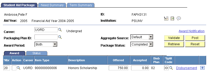

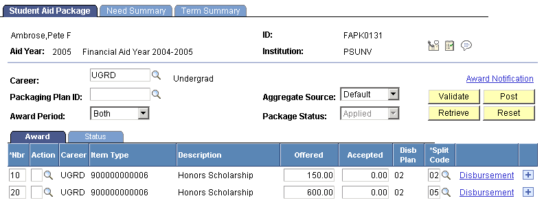

The following screen shots illustrate how the Award Posting process handles the two instances of the University Grant. In the first shot, both instances of the Financial Aid Item Type are visible.
The navigation path to the page is
This example illustrates the Student Aid Package page with two instances of Honors Scholarship.

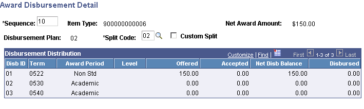

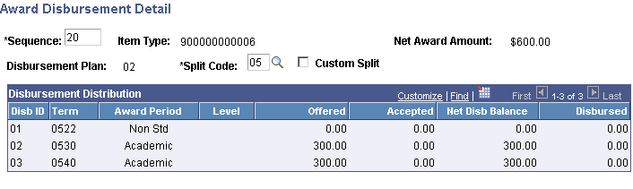

The next two screen shots show the disbursement detail for each instance of the Honor Scholarship.
This example illustrates the Award Disbursement Detail page for the first instance of the Honors Scholarship.
This example illustrates the Award Disbursement Detail page for the second instance of the Honors Scholarship.
The next screen shot shows how the two instances of the University Grant Financial Aid Item Type are combined after posting. Notice that the Split field contains XX, indicating a custom split:
This example illustrates the Student Aid Package page after posting—the two separate instances are combined, with a custom split.

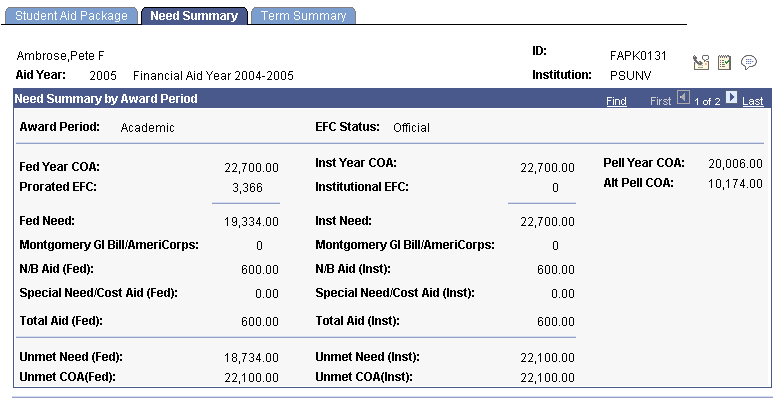

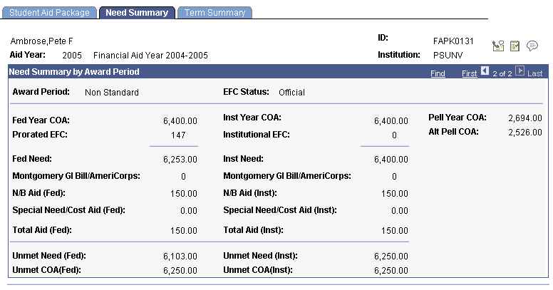

The Need Summary page also retains the separate disbursements:
This example illustrates the Need Summary page displaying AAP information and disbursements.
This example illustrates the Need Summary page displaying NSAP information and disbursements.
