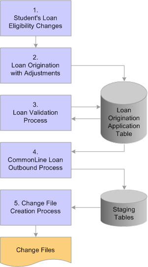

The change business processing flow for CommonLine FFELP and alternative loans using either CRC or CL 4 is as follows.
  1. Changes are made to the student's loan eligibility.
  2. Run the Loan Origination process with the Adjustments option selected. The system identifies the adjustments and changes the loan origination status.
  3. When origination is complete, run the Loan Validation process to check the loan application for data discrepancies. Loans that fail validation are reprocessed in subsequent runs until validation is reached.
  4. Run the CommonLine Loan Outbound process to process validated loans into outbound staging tables.
  5. Run the File Creation process to create loan change files using the staging table information. CRC generates files in XML format and CL 4 uses ASCII files.
After you submit the change files to the loan servicers, they are processed and you are notified using receipt of response files for each loan processed (discussed in a previous section). After receiving the CommonLine response file from your loan servicer as an acknowledgment of the change transaction, run the CommonLine Inbound processes to inbound and process the response records.

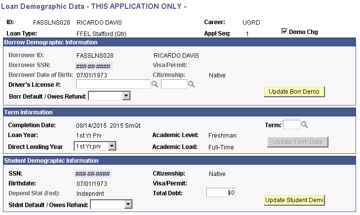

After you change the expected graduation date and grade level for the appropriate FA term record, you must use the Originate Loan component to update any affected loan records. You can also change loan period begin and end dates in the component.
  1. Click the Loan Demographic link to access the Loan Demographic Data page.
  2. Select the Demo Chg (demo change) check box. Then select the changed term from the Termvalues.
  3. Click the Update Term Data button. Note that the system displays any changes made to the FA Term record. Click OK to return to the Loan Origination I page. Save the Loan Origination 1 page.

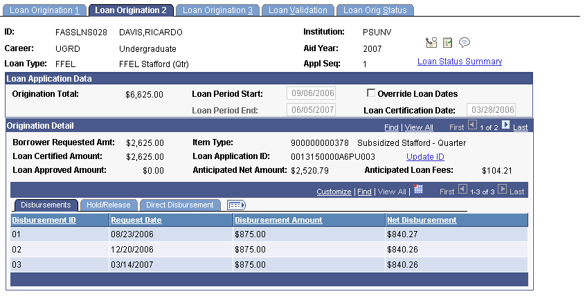

Access the Loan Origination 2 page (Financial Aid > Loans > CommonLine Management > Maintain Originated Loans > Loan Origination 2).
This example illustrates the fields and controls on the Loan Origination 2 page: Disbursements tab. You can find definitions for the fields and controls later on this page.
You send information to loan agencies regarding changes to a borrower's loan period dates through the transmission of the CommonLine 4 Change Transaction Loan Period Change @1-07 Detail record. This is a loan level adjustment. You can submit this loan change record before or after disbursement.
After you make changes to the loan dates or disbursement dates, save the page.
Field or Control
Description
Override Loan Dates
Select this check box to make the date fields available for editing.
Loan Period Start and Loan Period End
Generated from the Valid Careers for Terms table. After changing the loan dates, save the page.
Disbursements
Use the Disbursements tab to change disbursement dates.
Field or Control
Description
Request Date
Change the disbursement date.

After updating the appropriate FA Term record, access the Loan Demographic Data page.
This example illustrates the fields and controls on the Loan Demographic Data page. You can find definitions for the fields and controls later on this page.
When you finish making changes to this page, save the Loan Origination 1 page.
Field or Control
Description
Demo Chg
Select this check box to make the fields and buttons available for processing loan demographic changes.
Term information
Field or Control
Description
Term
Enter the term you changed in the FA Term record. This field is available when the Demo Chg check box is selected.
Update Term Data
Click this button to pull in any changed information from the FA Term record into the loan origination application.

  • Access Financial Aid > Loans > View Disbursement Status > Origination Loan Disbursement. If a loan disbursement is adjusted or cancelled, the system displays a disbursement action message in the Description area. If the adjustment results in a CommonLine 4 change transaction record, the Change link is active.
  • Click the Change link to open the Loan Disbursement Change page and view the type of CommonLine 4 change record that the system generates for the loan disbursement.

You have the option to submit address, phone, and email address changes for CRC change transactions. This option is part of the CRC Outbound process and functions only if you made another change and have calculated a change transaction for the loan. An address, phone, or email address change by itself does not trigger the system to generate a change transaction.
To process an address or phone change:
  1. Make an address, phone, or email address change in Campus Community.
  2. Make a change to the loan, such as loan period start and end dates.
  3. Run the Process CRC Outbound Records process with the Orig Change Outbound and Demographic Changes options selected.
    The CRC Outbound process determines whether this loan information has changed since the last time that you submitted information to the servicer. If so, the system submits the changed information in the change transaction record.
To generate CRC change transaction files or CommonLine 4 (C004P) change transaction files, use the same outbound processes used to generate application send files, but use different run control options. As with application send records, change records must be originated and validated before you create change transaction files.
This is the change transaction outbound procedure for CommonLine FFELP and alternative loans using either CRC or CL 4:
  1. Make changes to the student's loan.
  2. Run the Loan Origination process, using Adjustments, to detect changes made to the student's loan and calculate new loan eligibility. The calculated information is stored on the loan origination application tables.
  3. Run the Loan Validation process to check the loan changes for data discrepancies. Loans failing validation are reprocessed in subsequent runs until validation is reached.
  4. Run the CommonLine Loan Outbound process to process validated loans processed into outbound staging tables. Be sure to select the appropriate Outbound Change run control options.
  5. Run the Change File Creation process to create loan application files using the staging table information. CRC generates files in XML format while CL 4 uses ASCII files.
After you submit the change files to the loan servicers, they are processed and you are notified using receipt of response files for each loan change processed.
