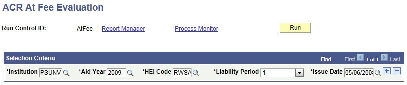

Access the ACR At Fee Evaluation page ().
This example illustrates the fields and controls on the ACR At Fee Evaluation page. You can find definitions for the fields and controls later on this page.
Field or Control |
Description |
Liability Period |
Select a Liability Period. You can run this process for multiple Liability Periods with the same Issue Date. |
Issue Date |
Enter the issue date of the ACR file that you want to evaluate. |
