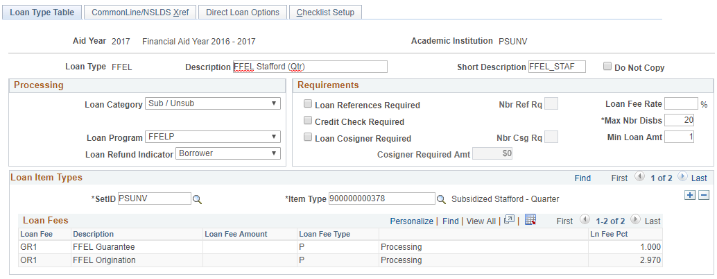

Access the Loan Type Table page ().
This example illustrates the fields and controls on the Loan Type Table page. You can find definitions for the fields and controls later on this page.
When you set up a loan financial aid item type, you include specific conditions for processing the loan. You must complete the Loan Type Table page to complete the setup.
Field or Control |
Description |
Do Not Copy |
Select this option to prevent the Loan Type from being
copied during the Aid Year Rollover process.
Processing
Field or Control |
Description |
Loan Category |
Select from Alt Loan (alternative loan), PLUS, Sub/Unsub (subsidized/unsubsidized), Subsidized, and Unsubsidized. If you select PLUS, a Graduate PLUS Indicator check box displays. Select the check box for Grad PLUS loans. |
Loan Program |
Select from Alternative, Direct, FFELP, Health, Perkins, State, and University. For example, to set up Stafford loans processed through CommonLine, you might specify the loan category as Sub/Unsub and the loan program as FFELP. To set up an alternative loan program processed through CommonLine, specify the loan category as Alt Loan (alternative loan), and the loan program as Alternative. |
Loan Refund Indicator |
Select from: Borrower: Select to have the borrower of the loan receive any refunds or overage. For example, the borrower would be a parent or guardian for a PLUS loan. Student: Select to have the student to receive any refunds from the loan. You can override this field at the loan application level. Note that additional setup is required in Student Financials to generate refunds to the proper recipient. |
Requirements
The system enforces the selected requirements during loan validation when utilizing the corresponding loan edit.
Field or Control |
Description |
Loan References Required |
Enter reference information on the Promissory Note Plus and Promissory Note Alt pages and Loan Origination components (SFA_CRC_ORIG). Enter the number of references required in the Nbr Ref Rq (number of references required) field. |
Loan Cosigner Required |
If you select this check box, enter the number of cosigners required in the Nbr Csg Rq (number cosigners required) field. |
Cosigner Required Amount |
Enter the minimum loan amount that requires a cosigner. Enter cosigner information on the Promissory Note Plus and Promissory Note Alt pages and Loan Origination components (SFA_CRC_ORIG). Note that this requirement is enforced by the loan servicer and not the loan validation process. |
Loan Fee Rate |
Enter the loan fee rate to print on the promissory note for this loan type. Ensure that the loan fee rate matches the loan fee setup for the item type that you associate with this loan type. |
Loan Item Types
Field or Control |
Description |
SetID |
Select a setID and an item type. You can associate multiple item types with the same loan type. You cannot share item types across multiple loan types. For example, to define FFELP Stafford loans, enter the subsidized and unsubsidized item types. |
Note: Based on the business processes defined by your institution, you might need to create multiple loan types for the same loan program.
The system displays the loan fee, description, loan fee amount, loan fee type, and loan fee percent for the item type selected. These values are associated with the item type when you set up the financial aid item type on the Loan Fee Table page.

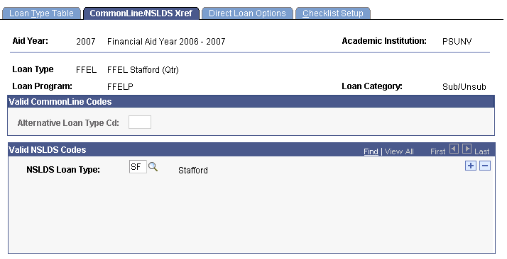

Access the CommonLine/NSLDS Xref page ().
This example illustrates the fields and controls on the CommonLine/NSLDS Xref page. You can find definitions for the fields and controls later on this page.
When you originate a CommonLine loan, the system uses the information set up on this page to search for similar loans in the borrower's NSLDS history. If a prior loan is found, the system uses the prior loan information to derive the new loan's destination. This optional feature can be set up in the Loan Institution setup page.
Field or Control |
Description |
Alternative Loan Type Cd (alternative loan type code) |
The system uses this code to notify loan agencies about the type of alternative loan. Alternative loan codes are assigned by NCHER. |
NSLDS Loan Type |
Select a loan type to translate the NSLDS loan type that is defined in the NSLDS tables. |
For more information, see www.ncher.us

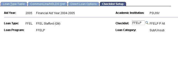

Access the Checklist Setup page
This example illustrates the fields and controls on the Checklist Setup page. You can find definitions for the fields and controls later on this page.
The values for the Loan Type, Loan Program, and Loan Ctgry (loan category) fields are based on the aid year and academic institution that you selected to access the page.
Field or Control |
Description |
Checklist |
Select a checklist to be generated at the time the loan is originated. Note: The system does not generate checklists for direct loans during origination. It generates checklists after you run the promissory note process. |
