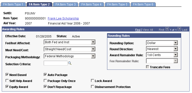

Access the FA Item Type 2 page ().
This example illustrates the fields and controls on the FA Item Type 2 page.
Select the Don't Repackage check box if this item type should be protected during repackaging. If this check box is selected, this award is not to be modified during repackaging unless the repackaging rule explicitly includes this item type. Even if this check box is selected, if this item type is specified on the repackaging plan setup, its presence negates the Don't Repackage action and exposes the award to repackaging.
Note: The Don't Repackage attribute does not apply to packaging plans or to repackaging plans that use the "Original Package Plan" repackaging rule.

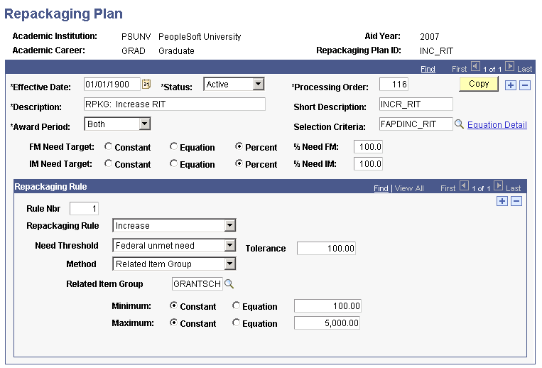

Access the Repackaging Plan page and select Increase in the Repackaging Rule field.
This example illustrates an Increase repackaging rule with a Related Item Group method.
This example demonstrates how all students with a Federal unmet need greater than 100 USD are evaluated for several grants with the objective of increasing funds in their package by a maximum of 5000 USD.
This table lists key parameters for the Increase rule and describes each parameter:

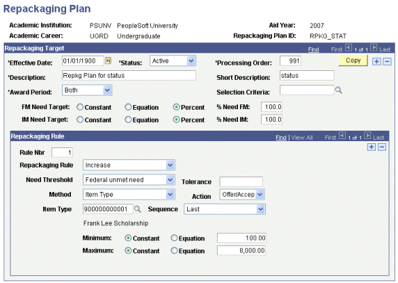

Increase Rule - Example 2
Access the Repackaging Plan page.
This example illustrates the Repackaging Plan page (Increase rule).

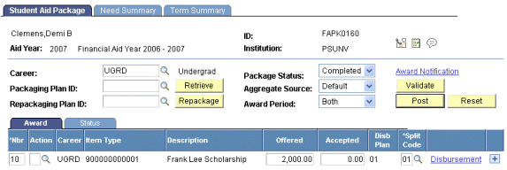

This example shows a repackaging plan setup to award an additional amount of 8,000 USD, using the Frank Lee Scholarship item type, with an award action of Offer/Accept.

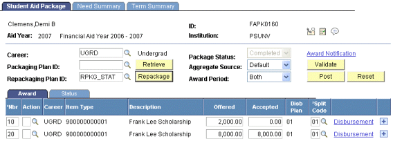

Access the Student Aid Package page.
This example illustrates the Student Aid Package page with an award in Offered status.
This example shows that the student has an existing award (Frank Lee Scholarship) for 2,000 USD in Offered status.

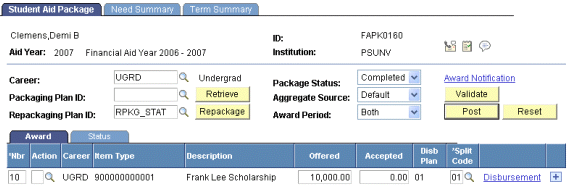

This example illustrates the Student Aid Package page after Repackaging.
This example shows that the repackaging plan has awarded the student a second instance of the Frank Lee Scholarship for an additional amount of 8,000 USD.
This example illustrates the Student Aid Package page with the combined award after posting.
When you post the awards, the system combines the two instances of the Frank Lee Scholarship item type into a single award of 10,000 USD.
Note: The system sets the final award action to Offered status because the first instance of the Frank Lee Scholarship was in Offered status.

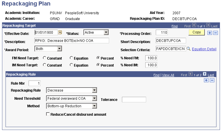

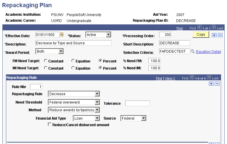

Multiple Decrease Rule Plan
Access the Repackaging Plan page and select Decrease in the Repackaging Rule field.
This example illustrates the Repackaging Plan page with multiple decrease rules (page 1 of 2).
Example of the Repackaging Plan page with multiple decrease rules (page 2 of 2)
In this example, students who meet the criteria defined in the FAPDDECTEST equation are evaluated for a decrease in funding, first by Federal overaward and then by Federal overaward COA. The process evaluates federal loans before institutional loans. Any disbursed amounts are ignored.
This table lists the Decrease parameters and describes each:

Set the target need to be evaluated to a Need Threshold: Federal overaward, Federal overaward COA, Institution overaward, or Institution overaward COA. Establish a threshold amount in the Tolerance field. For example, you could evaluate all students who have an overaward of at least 1 USD. |
Method |
If you select Item Type. you must select an Item Type name. If you select Reduce awards by type/source, you can enter a type, a source, or both. Select Bottom Up to reduce the student's package by the overaward amount beginning with the highest sequenced award |
Reduce/Cancel disbursed amount |
Overrides the Disbursement Protection attribute on Financial Aid Item Type Set Up. Use this value if you want to reduce or cancel award amounts below the disbursed amounts. |

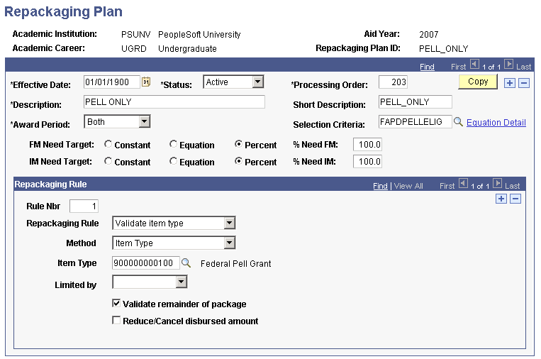

Access the Repackaging Plan page and select Validate item type for the repackaging rule.
This example illustrates the Example of the Validate item type rule with an Item Type method.
In this example, students are reevaluated for eligibility for the Federal Pell Grant. After the Pell Grant is adjusted as needed, the remainder of the package is reevaluated.
This table lists the appropriate parameters and describes each one:
Parameter |
Description |
Validate remainder of package |
The system works from that point in the repackaging plan of the Validated Item Type rule down through the package. |
Overrides the Disbursement Protection attribute on Financial Aid Item Type Set Up. Use this check box if you want to reduce or cancel award amounts below the disbursed amounts. |

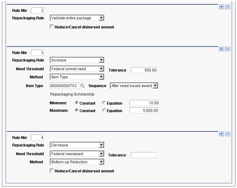

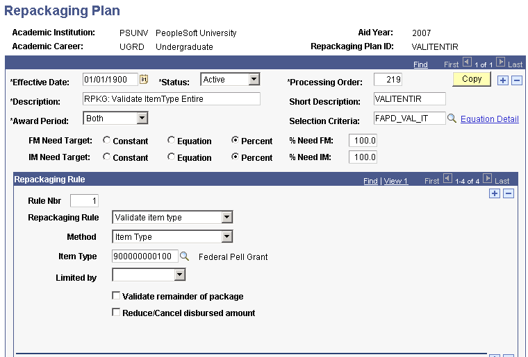

Multirule Plan to Validate the Entire Package
Access the Repackaging Plan page ().
This example illustrates a multiple-rule Repackaging Plan page (page 1 of 2).
A plan that validates students against their entire package should first validate Pell Grants, then recheck for eligibility, and finally account for overawards because locked awards won't be reduced. That is:
Rule 1: Validate item type. Specify the item type for Pell Grant to reevaluate the student for a Pell Grant. Based on eligibility criteria, the student might be eligible for the same amount, a higher amount, or a lower amount.
Rule 2: Validate entire package. This rule checks the student's eligibility and federal need.
Rule 3: Increase using an item type. This rule ensures that any student who lost a Pell Grant and thereby gained unmet need or who otherwise still had up to 500 USD of unmet need could be evaluated for a Repackaging Scholarship between 10 and 5,000 USD.
Rule 4: Decrease. Specify the need threshold as Federal overaward and use the bottom-up method. If the student has gained (more) Pell Grant eligibility and, as a result, created an overaward condition, then this rule reduces other awards until the overaward condition is removed. Reduction starts from the bottom up, that is, from the highest sequenced award to the lowest.
