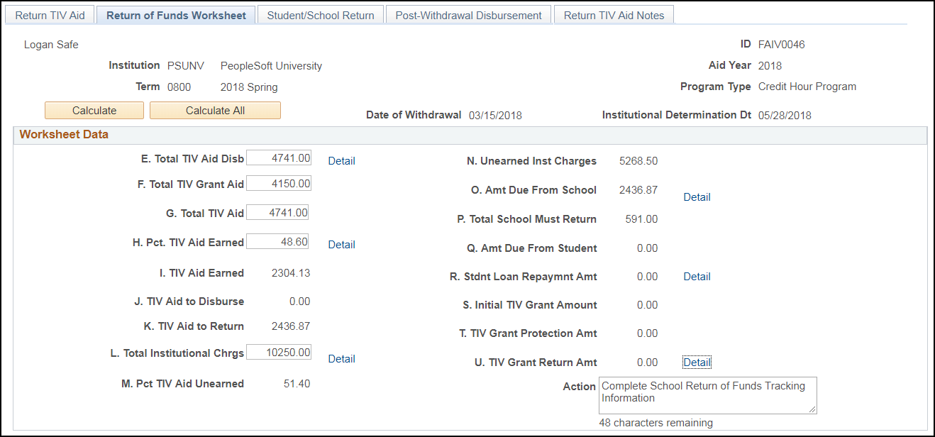

Access the Return of Funds Worksheet page (Financial Aid > Return of Title IV Funds > Create Worksheet > Return of Funds Worksheet).
This example illustrates the fields and controls on the Return of Funds Worksheet page. You can find definitions for the fields and controls later on this page.
Use the Detail links to view or recalculate specific amounts.
Click Calculate to recalculate the values based on the adjustments you made to the percentages.
Click Calculate All to update and populate the fields with the student's calculated withdrawal information. The system displays the withdrawal status of the student for the specified term and calculates the actual values for the amount of earned aid, unearned aid, and aid to be returned. The system uses the setup and award data specific to the student.
If you change the start and end dates from the Return of TIV Aid page, click Calculate All to update the values on the Return of Funds Worksheet page.
Field or Control
Description
E. Total TIV Aid Disb (E. total Title IV aid disbursed)
Displays Title IV Grant and Loan Programs amounts to be disbursed for grants, amounts that could have been disbursed for grants, net amounts disbursed for loans and net amounts that could have been disbursed for loans. Totals based on the actual federal worksheet are also displayed.
F. Total TIV Grant Aid (F. total Title IV grant aid)
Displays grant aid disbursed and amount that could have been disbursed.
G. Total TIV Aid (G. total Title IV aid)
Displays grant and loan aid disbursed and amount that could have been disbursed.
H. Pct. TIV Aid Earned (H. percent Title IV aid earned)
Displays percentage of period of enrollment completed.
I. TIV Aid Earned (I. Title IV aid earned)
Displays aid earned by the student based on percentage of enrollment period completed.
J. TIV Aid to Disburse (J. Title IV aid to disburse)
Displays amount of aid that could have been disbursed.
K. TIV Aid to Return (K. Title IV aid to return)
Displays amount aid to be returned.
L. Total Institutional Chrgs (L. total institutional charges)
Displays the value of the charges your institution set up in the Institutional Charges setup page. Institutional costs are defined as charges—the cost of attendance—a student must pay to the institution directly. Whether you use the actual or budgeted charges, the system displays the value for the institutional charges you defined in your setup.
M. Pct TIV Aid Unearned (M. percent title IV aid unearned)
Displays the amount to be returned based on the percentage of the unearned aid.
N. Unearned Inst Charges (N. unearned institutional charges)
Displays the amount of aid that must be returned for unearned institutional charges. For example, tuition is an institutional charge. If a student withdraws at 10% of the term, the student earns 10% of the charges for tuition. The remaining 90% is unearned.
O. Amt Due From School (O. amount due from school)
Displays the amount of aid the institution must return to the Title IV program. The institution determines its share of unearned funds first.
P. Total School Must Return:
Displays the total loans the school must return.
Q. Amt Due From Student (Q. amount due from student)
Displays the amount of aid the student must return to the Title IV program. The student returns the difference between the Title IV aid to be returned and the amount of Title IV aid due by the institution. For example, if the returned aid is 1000.00 USD and your institution returns 600.00 USD, the initial unearned calculation for the student to return is 400.00 USD.
R. Stdnt Loan Repaymnt Amt: (R. Student loan repayment amount)
Displays the total amount the student must repay, which consists of loan funds the student has earned, or unearned loan funds that the school is not responsible for repaying, or both.
S. Initial TIV Grant Amount: (S. initial Title IV grant amount)
Displays the Initial amount of Title IV grants the student must return.
T. TIV Grant Protection Amt: (T. Title IV grant protection amount)
Displays the amount of Title IV grant protected using the value in F. Total TIV Grant Aid and applying the 50 percent grant protection.
U. TIV Grant Return Amt: (U. Title IV grant return amount)
Displays the net Title IV grant funds that the student must return.

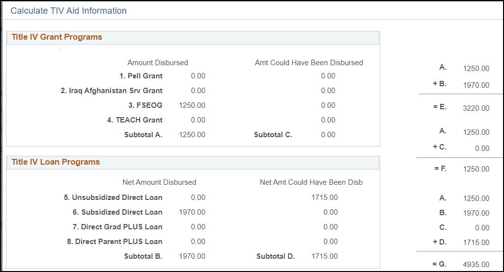

Access the Calculate TIV Aid Information page (click the Detail link to the right of the E. Total TIV Aid Disb field on the Return of Funds Worksheet page).
This example illustrates the fields and controls on the Calculate TIV Aid Information page. You can find definitions for the fields and controls later on this page.
Calculate TIV (title four) Aid Information page
The system displays grant and net loan amounts that are disbursed and that could have been disbursed. Totals based on the actual federal worksheet are also displayed

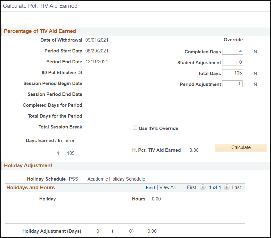

Access the Calculate Pct. TIV Aid Earned page (click the Detail link to the right of the H. Pct. TIV Aid Earned field on the Return of Funds Worksheet page).
This example illustrates the fields and controls on the Calculate Pct. TIV Aid Earned page. You can find definitions for the fields and controls later on this page.
Calculate Pct. (percentage of) TIV (title four) Aid Earned page
Percentage of Title IV Aid Earned
Field or Control
Description
Date of Withdrawal
Displays the student's day of withdrawal as entered on the Return of TIV Aid page.
Period Start Date
Displays the first day of the term or payment period.
Period End Date
Displays the last day of the term or payment period.
60 Pct Effective Date(60 percent effective date)
Displays the 60 percent date for the session in which the withdraw is taking place as recorded in the Term/Session Table or as entered in the Return TIV Session table.
Note: This date is not necessarily a 60 percent point in time for the span of multiple sessions.
Session Period Begin Date
Displays the lowest beginning date of the Session Period as entered in the as entered in the Return TIV Session table.
Session Period End Date
Displays the highest end date of the Session Period as entered in the Return TIV Session table.
Completed Days for Period
Displays calculated earned days for a session.
Total Days for Period
Displays calculated total days for a session period.
Total Session Break
Displays the total of all breaks between sessions greater than 4 days.
Completed Days
Displays the number of days between the Period Start Date and student's Date of Withdrawal. Enter a value in this field to manually override and set the Override flag to "Y".
Note: Completed Days are net days considering eligible Session Breaks. Holiday Breaks are not reflected in this total. They are, however, accounted for in the Period Adjustment to provide a point of reference.
Student Adjustment
Enter a value in this field to exercise professional judgment by adjusting the student's completed days.
Note: Completed Days are net days considering eligible Session Breaks. Holiday Breaks are not reflected in this total. They are, however, accounted for in the Period Adjustment to provide a point of reference when making an adjustment to a student’s Completed Days.
Total Days
Displays the number of days between the Period Start Date and Period End Date, inclusive. Enter a value in this field to manually override and set the Override flag to "Y".
Note: Total Days are net days considering eligible Session Breaks. Holiday Breaks are not reflected in this total. They are, however, accounted for in the Period Adjustment to provide a point of reference.
Period Adjustment
Displays the adjustment that is required for scheduled holidays of five consecutive days or more. The system displays 0 if no holidays are scheduled consecutively for 5 or more days. Enter a value in this field to manually override and set the Override flag to "Y".
Note: Total Days are net days considering eligible Session Breaks. Holiday Breaks are not reflected in this total. They are, however, accounted for in the Period Adjustment to provide a point of reference when making an adjustment to a student’s Total Days.
Use 49% Override
Displays whether or not the 49% Override is used in the Return TIV calculation.
If the Use 49% Override is enabled, then the Override fields for Completed Days, Student Adjustment, Total Days, and Period Adjustment are read only.
Days Earned / In Term
Displays the number of completed days divided by the total days after performing a calculation.
Note: This field is reset to zero every time you access the component. Click Calculate to update.
H. Pct TIV Aid Earned (H. percent Title IV aid earned)
Displays the percentage of the period of enrollment or payment period that the student completed.
Calculate
Click to recalculate the percentage of the period of enrollment or payment period that the student completed if updating Completed Days, Student Adjustment, Total Days, or Period Adjustment.
Holiday Adjustment
Field or Control
Description
Holiday Schedule
Displays the name of the holiday schedule defined on the Holiday Schedule page (Set Up Common Objects > Foundation Tables > Organization > Holiday Schedule) for that term. Student Records associates this schedule to terms and sessions used in Campus Solutions.
See Setting Up Holiday Schedules.
Holiday
Displays the date of the holiday. The system lists all holidays, not just those that are consecutive.
Hours
Displays the number of clock hours for the holiday.
Holiday Adjustment (Days)
Displays the number of consecutive holidays defined in the holiday schedule.
Calculate
Click to recalculate the adjustment for holidays if you made a change to the start and end dates of the payment or enrollment period. The system determines whether there are any changes to the holiday schedule based on the new start and end dates.
Note: The system does not support clock hours even though you can select clock hours as a program type when you enter the access requirements to enter the Return of TIV Aid page.
