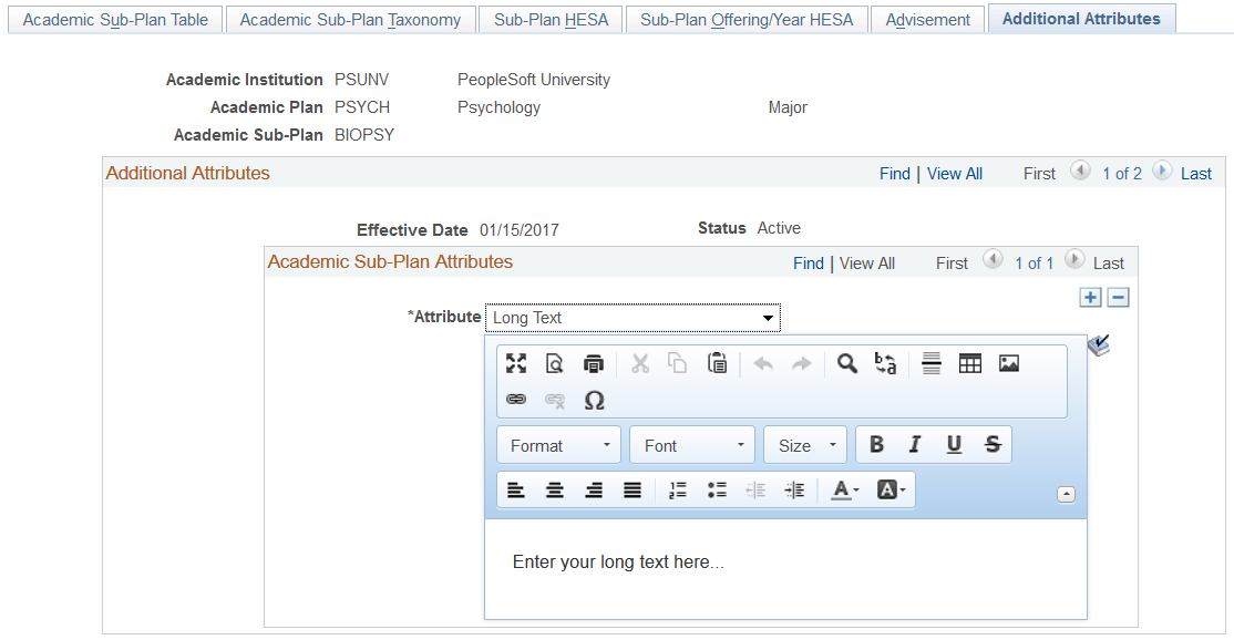

Access the Additional Attributes page ().
This is an example of an attribute that can be used on the Additional Attributes page.
Use this page to enter and review Common Attribute fields associated with the academic subplan.
The Academic Subplan CAF Table record (ACAD_SUBPLAN_CAF) is delivered and associated with the Academic Plan Table (ACAD_SUBPLN_TBL) record.
This page appears only after adding common attributes to the Academic Subplan CAF Table attribute record using the record context (CSS_CAF_REC_ATTRIBUTE) component.
Note: On the Record Context page, you must select the Inline Subpage option in the Attribute Display Type group box. The other option, Secondary Page, is not a supported display type for attributes associated with the Academic Subplan Table.
