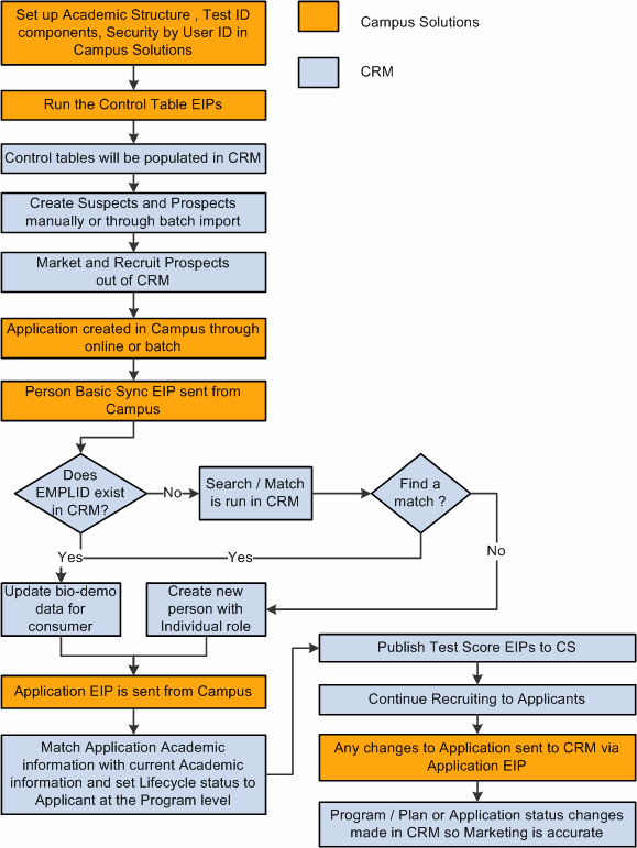

Workflow illustrating the system steps to pass messages between Campus Solutions and CRM when suspects become applicants.

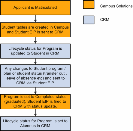

Workflow illustrating the system steps to pass messages between Campus Solutions and CRM when applicants become alumni.
