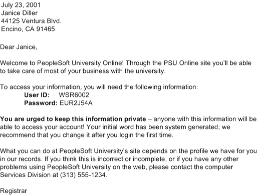

Example
Here is an example of a password notification letter created with the sample template CCLTROPR.doc:
Example of an online access letter to a student from an institution.
Warning! When you merge the letter template with the extract files, a copy of the letter is saved on the local drive of the computer that was used to merge and print the letters. Be sure to delete these local copies because they contain the nonencrypted passwords.
