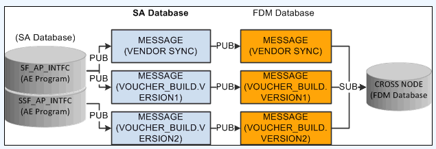

The following diagram illustrates how AP refund messages travel between Student Financials and PeopleSoft Financials:
Student Financials to PeopleSoft Financials AP refund messaging process
During the AP refund messaging process, Student Financials delivers queues and messages using Service Operations to the PeopleSoft Financials database:
Queue |
Message |
Service Operation |
Description |
VENDOR |
VENDOR_SYNC |
VENDOR_SYNC |
Publishes all vendor information (address, location, and contact) in a message to the PeopleSoft Financials database, one vendor at a time. Also allows changes to vendor data to be published iteratively. |
VOUCHER |
VOUCHER_BUILD.VERSION_1 |
Sends voucher header, line, and distribution information in the message to be processed by PeopleSoft Payables. The system populates staging tables with the message data. The Voucher Build (AP_VCHRBLD) process then processes these staging tables. |
VOUCHER |
VOUCHER_BUILD.VERSION_2 |
SSF_VOUCHER_BUILD_V2 |
For Direct Deposit only Sends refund as a Single Payment Voucher (SGLP) to the PeopleSoft Financials database. In addition to sending the voucher header, line, and distribution information, voucher vendor details and voucher bank details are also included. The system populates staging tables with the message data. The Voucher Build (AP_VCHRBLD) process then processes these staging tables. |
