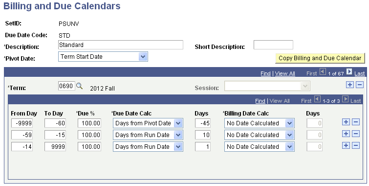

Access the Billing and Due Calendars page (
).This example illustrates the fields and controls on the Billing and Due Calendars page. You can find definitions for the fields and controls later on this page.

Pivot Date |
Select a pivot date for this calendar. Student Financials uses the pivot date as the starting place to calculate due dates or billing dates. The system counts the billing dates and due dates—either back in time or forward in time—from the pivot date that you select. Warning! Values for this field are delivered with your system as translate values. Do not modify these values in any way. Any modifications to these values requires a substantial programming effort. Select from: Admit Term Start Date: Select to use as the pivot date the first day of the term that the student is admitted. This option pertains to application fee processing only. Application Date: Select to use as the pivot date the date that the application is filed. This option pertains to application fee processing only. Class Start Date: Select to use as the pivot date the first day of the class. Session Start Date: Select to use as the pivot date the first day of the session. Term start date: select to use as the pivot date the first day of the term. For ITEM_SF installments, you can use only pivot dates that are available at the level that the fee is calculated. If the term fee is calculated by:

From Day and To Day |
Enter the first and last day that you assess fees. Express the number of days before the pivot date as a negative number, and the number of days after the pivot date as a positive number. |
Due % (due percent) |
Define the percentage of the fee that's due for the respective assessment period. |
Due Date Calc (due date calculation) |
Use this field to determine how the system calculates the due date for a given fee assessment period. Select from: Days from Pivot Date: Select to calculate the due date based on the pivot date. If tuition calc is creating installments, any adjustments are processed by first trying to match the adjustment due date to the due date of the original charge. If an adjustment with an un-matching due date is posted, it is applied to the oldest due date with a lower line sequence number first. This also applies to adjustments posted with NULL due dates. Days from Run Date: Select to calculate the due date based on the day that you assessed fees. Do not select this option when creating tuition calc adjustments to ensure that any tuition calc adjustments are applied appropriately to the original installment due date(s). No Date Calculated: Select to disable the calculation of a due date. Note: Do not select Days from Run Date or No Date Calculated when using the Third Party Contract-Track Charges by Due Dates functionality. |
Days |
Enter the number of days from the pivot date or run date that the fees are due. Enter a negative number to indicate days before the respective date; enter a positive number to indicate days after the respective date. If you select No Date Calculated in the Due Date Calc field, the Days field becomes unavailable. |
Billing Date Calc (billing date calculation) |
Use this field to determine how the system calculates the billing date for a given fee assessment period. Select from: Days from Due Date: Select to calculate the billing date based on the calculated due date. Days from Pivot Date: Select to calculate the billing date based on the pivot date. Days from Run Date: Select to calculate the billing date based on the day that you assessed fees. No Date Calculated: Select to disable the calculation of a billing date. Note: Do not select Days from Run Date when using the Third Party Contract Track Charges by Due Dates functionality. |
Days |
Enter the number of days from the due date, pivot date, or run date that the system produces a bill. Enter a negative number to indicate days before the respective date; enter a positive number to indicate days after the respective date. If you select No Date Calculated in the Billing Date Calc field, the Days field becomes unavailable. |
