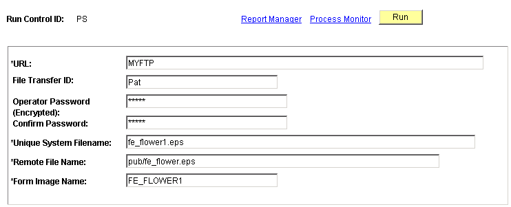

Access the Upload EPS Image File page (Set Up SACR > Common Definitions > Forms Engine > Process > Upload EPS Image File).
This example illustrates the fields and controls on the Upload EPS Image File page. You can find definitions for the fields and controls later on this page.
Upload EPS (Encapsulated PostScript) Image File page
Enter the required information and run the process to upload the image to an FTP server.

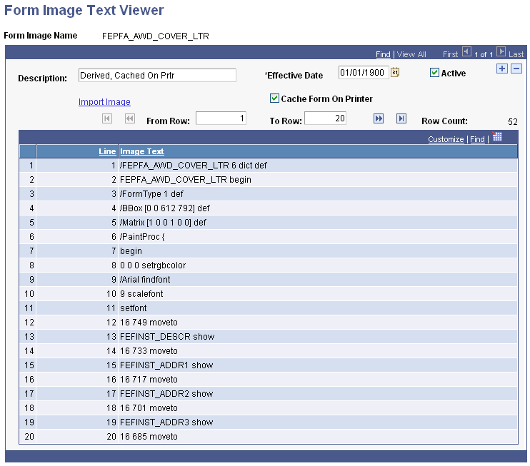

Access the Form Image Text Viewer page (Set Up SACR > Common Definitions > Forms Engine > Setup > Form Image Text).
This example illustrates the fields and controls on the Form Image Text Viewer page. You can find definitions for the fields and controls later on this page.
Field or Control
Description
Description
Enter a description for the image.
Field or Control
Description
Cache Form On Printer
Select if the image is cached. Clear if the image is noncached.

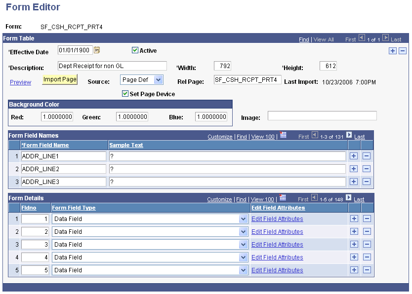

Access the Form Editor page (Set Up SACR > Common Definitions > Forms Engine > Setup > Form Editor).
This example illustrates the fields and controls on the Form Editor page. You can find definitions for the fields and controls later on this page.
Form Editor page
Changing a Receipt Title
To change a receipt title:
  1. Scroll to the row with a Fldno (field number) of 12.
  2. Click the Edit Field Attributes link to open the Form Text Attributes page.
  3. Edit the title in the Form Text field.
  4. Click OK and save your changes to the form.
Adding a Cachable Image to a Receipt
To add a cachable image to a receipt:
  1. Insert a row in the field number grid.
  2. Entered a form field type of Image.
  3. Click the Edit Field Attributes link to open the Form Image Attributes page.
  4. Locate and select the desired image.
  5. Specify a start position.
    X is the horizontal distance from the left side of the page, in units of 1/72 of an inch. Y is the vertical distance from the bottom of the page, in units of 1/72 of an inch. For example, if X is 504 and Y is 684, the start position would be 1.5 inches from the upper right corner of an 8.5-inch by 11-inch page.
  6. Specify a scaling factor.
    For example, if the unscaled image is roughly 3 inches square, use an X and Y scaling factor of 0.3 so that the image comes out as one square inch.
  7. Click OK and save your changes to the form.
