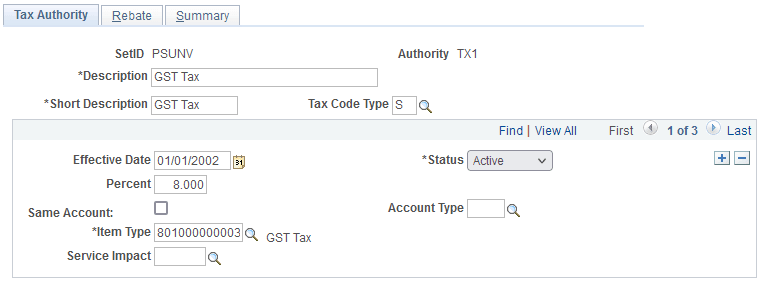

Access the Tax Authority page (
).This example illustrates the fields and controls on the Tax Authority page. You can find definitions for the fields and controls later on this page.
Field or Control |
Description |
Tax Code Type |
Select a tax code type of S (sales tax) or V (value added tax). |
Percent |
Set the default percentage of tax that the authority assesses. |
Same Account and Account Type |
Select the Same Account check box if you want the tax assessed to appear in the same account as its associated charge. If you clear the check box, you can select a different account type in the Account Type field. Warning! For accuracy in payment shuffling, Oracle recommends not selecting Same Account and to identify an account type that's unique for taxes. If the tax fee can be waived, the Tax Waiver account type should be the same value as the Tax Authority account type. |
Item Type |
Select the item type that you have defined for transactions from this tax authority. |
Service Impact |
Select the service impact that exempts customers from this taxation. |

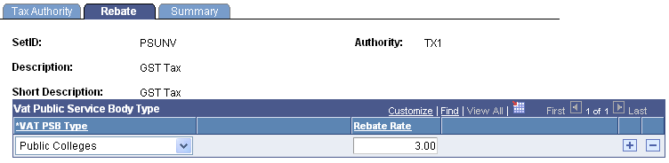

Access the Tax Authorities - Rebate page (
).This example illustrates the fields and controls on the Tax Authorities - Rebate page. You can find definitions for the fields and controls later on this page.
Field or Control |
Description |
VAT PSB Type (value added tax public service body type) and Rebate Rate |
If applicable, select the value added tax public service body type and enter a rebate rate. |

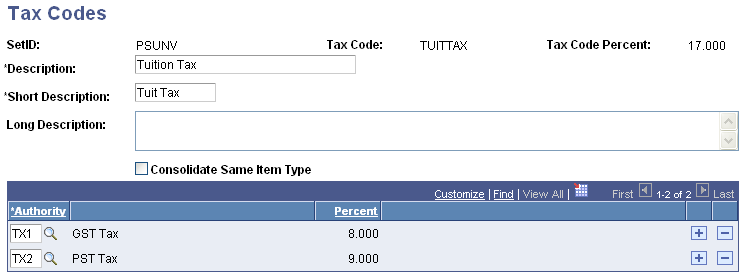

Access the Tax Codes page (
).This example illustrates the fields and controls on the Tax Codes page. You can find definitions for the fields and controls later on this page.
Field or Control |
Description |
Consolidate Same Item Type |
If you are creating a code that combines two or more different tax authorities, you can select this check box to consolidate the tax transactions that make up the code into the same item type during posting. Otherwise, the system creates each transaction on an account as individual entries. |
Authority |
Select the tax authority that you want to attach to the tax code. |
Percentage |
The default percentage appears to the right of each authority that you add. |
