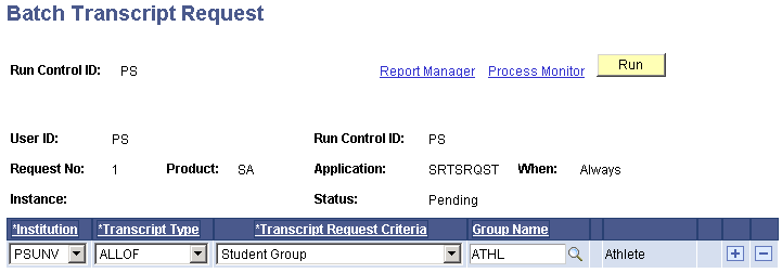

Access the Batch Transcript Request page (
).This example illustrates the fields and controls on the Batch Transcript Request page. You can find definitions for the fields and controls later on this page.

Click the Run button to run this request. When you click the OK button, an Application Engine process scans the database and creates transcript requests for the students who match your selection criteria. When the Run Status for SRTSRQST process is Success, you can generate the transcripts on the Transcript Generation page. Be sure to click the Message Log link on the Process Detail page to note the system-generated transcript request numbers. You need these numbers to generate transcripts on the Transcript Generation page and to print transcripts on the Transcript Print page.
