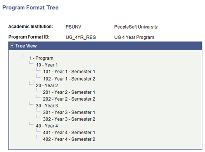

This field prompts against the Program Format Table for the selected institution. Use the View Tree link to view the Program Format definition. The value that is selected here serves as a high level control for the run control. Only students (identified by the population selection or entered manually) in programs with a matching program format ID are considered for processing. |

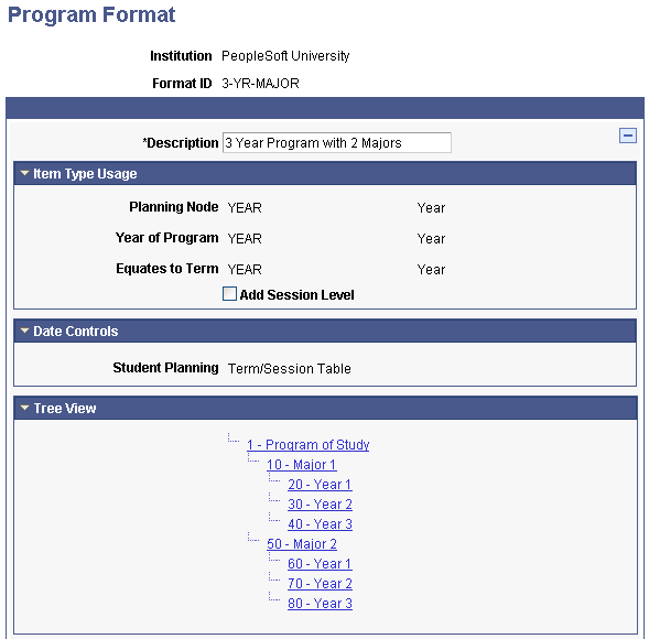

If this option is selected, the user must identify which plan node (within a Program Format) should be created for the run. This allows planning nodes to be created in a user defined order when necessary. For example, you could define a Program Format where it is necessary to create and activate multiple planning nodes at the same time. Refer to the following example. |
This example shows a dual major program format, where planning nodes (years) are defined under each major:
The Create Selected Plan Node(s) option can be used to identify, create and activate each year for each major. To activate the student in Year 1 for both Majors, Node IDs 20 and 60 would be specified.

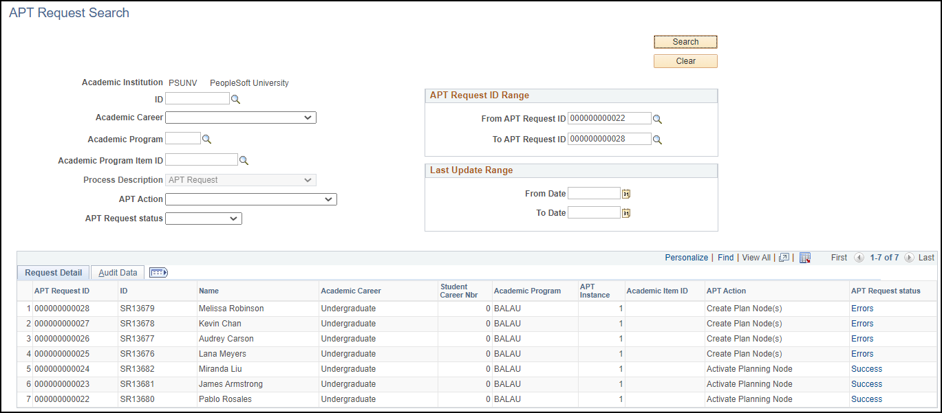

Access the APT Request page ().
This example illustrates the fields and controls on the APT Request Search page. You can find definitions for the fields and controls later on this page.
Field or Control |
Description |
APT Request ID Range |
Enter the Request ID range you wish to search. |
Last Update Range |
Enter the date range you wish to search for when the APT was last updated. |
APT Request status |
Click the link for more details about the APT Request status. |
