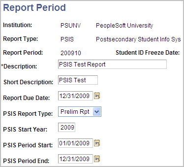

Access the Report Period page ().
This example illustrates the fields and controls on the Report Period page. You can find definitions for the fields and controls later on this page.

Institution |
Enter the institution for which you will run the report. |
Report Type |
Enter the report type to which the reporting period pertains. |
Report Period |
Enter a unique reporting submission period for your report type. |
Report Due Date |
Enter the date upon which you must report data. The system uses this date to perform effective date checking. This enables you to process data after the report date, and as long as the changes have an effective date, the system does not pick them up for reporting. If you need to make corrections to reporting data, you must ensure that the data has an effective date that is less than or equal to this report due date. |
Student ID Freeze Date |
The date that the student list, for the selected reporting period, is frozen. |
The following fields are available for entry if you specify a report type of PSIS.
Field or Control |
Description |
PSIS Report Type |
Enter the type of report to be run. |
PSIS Start Year |
Enter the year in which the current reporting period begins. |
PSIS Period Start |
Enter the start date of the reporting period. |
PSIS Period End |
Enter the end date of the report period. |
