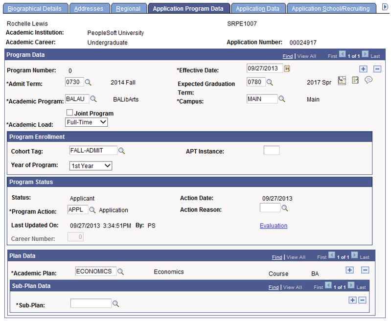

Access the Application Program Data page ().
This example illustrates the fields and controls on the Application Program Data page for Program Enrollment. You can find definitions for the fields and controls later on this page.
Field or Control |
Description |
Cohort Tag |
This field appears only if the Enable Program Enrollment check box is selected on the Academic Institution 9 page. This value is obtained in the application process and indicates the point within a term (typically a session) that the applicant is expected to enroll. |
APT Instance |
This field appears only if the Enable Program Enrollment check box is selected on the Academic Institution 9 page. Note: The rules governing the generation of the instance at the admission stage and the process to generate the instance are planned for the future. |
Year of Program |
This field appears only if the Enable Program Enrollment check box is selected on the Academic Institution 9 page. This value is obtained in the application process and indicates the student’s start point in a program of study, for example, a student could apply as a second year student. |
See Adding New Applications Manually
See Enabling Program Enrollment

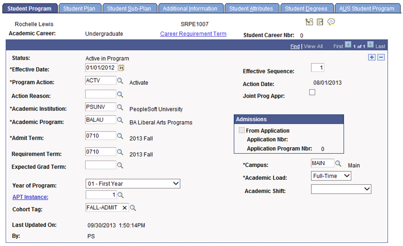

Access the Student Program page ( ).
This example illustrates the fields and controls on the Student Program page for Program Enrollment. You can find definitions for the fields and controls later on this page.
Field or Control |
Description |
Year of Program |
This value is gathered in the application process and indicates the student’s start point in a program of study: for example, a student could apply as a second year student. The value is copied from the Admissions program stack by the matriculation process. |
APT Instance |
This field is populated with number of the APT Instance. This could be generated during the Admissions activation/matriculation process, the APT Request process or from this component (see “Adding a New Program” below). Click the APT Instance link to access the Academic Progress Tracker component. From that component, click the Student Career Nbr link to return to the Student Program page. See Creating and Managing APT Instances Using the Academic Progress Tracker Component |
Cohort Tag |
