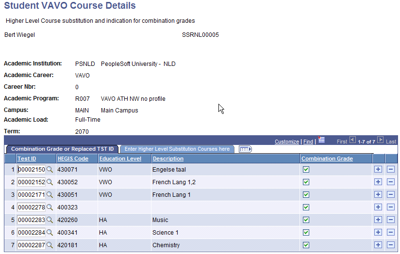

Access the Student VAVO Course Details page (
).This example illustrates the fields and controls on the Student VAVO Course Details page: Combination Grade or Replaced TST ID tab. You can find definitions for the fields and controls later on this page.
Field or Control |
Description |
Test ID |
Select a test ID for which you want to add a combination grade indication or a higher level substitution course. |
Combination Grade |
Select to indicate that the test ID should count towards an overall combination grade calculated result. If you select this check box, the Calculation process uses the combination grade test result and counts it towards the overall combination grade calculated result set up through the Test Catalog. |
Education Level |
Displays the course education level. Education level is set up for each HEGIS Code that is related to a course (Set up SACR , Foundation Tables, Reporting Codes, HEGIS Code Table). |
