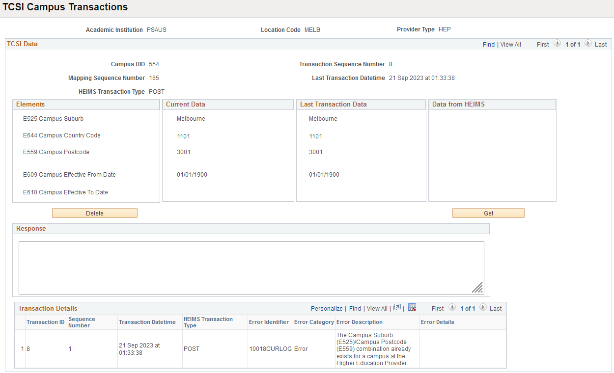

Here's an example of a Transaction Maintenance page.
This example illustrates the fields and controls on a TCSI Transaction Maintenance page. You can find definitions for the fields and controls later on this page.
Here are descriptions of some of the common fields on the Transaction Maintenance pages.
Field or Control |
Description |
Mapping Sequence Number |
This is the sequence number across all records in all mapping tables. |
Transaction Sequence Number |
This is the sequence number for the records in this transaction table. |
Last Transaction Datetime |
This is the date and time when you last initiated a data transfer process. The transaction could be a delete, post, patch, or get. |
HEIMS Transaction Type |
This identifies the type of transaction you recently initiated: POST, PATCH, MATCH, or DELETE. |
Elements |
These are the elements that make up the record. For example, if you’re viewing the TCSI Campus Transactions page, this column shows the elements that make up the campus record. If you have submitted data to TCSI, a Delete button appears. If you click this button, the record in TCSI is deleted, and the record in CS is marked as deleted. When you run the TCSI data process, the process skips this record (it isn’t sent to TCSI) because it has been marked as deleted. |
Current Data |
Here, you see the data that’s currently in CS. If you have run the migration process, but never submitted nor updated your records in TCSI, a Post button appears. Click Post to submit this record to TCSI. |
Last Transaction Data |
If you initiated a data transfer process, this column shows the data that was imported from the TCSI system. It’s the latest version of the data that’s stored in TCSI. When you send data to TCSI either by running the migration process or initiating a Get call on this page and there’s a discrepancy between the values of the elements in CS (shown in the Current Data column) and TCSI (shown in this column), a Patch button appears. If you click Patch, CS updates the record in TCSI. The record that appears in the Current Data column is used to update the record in TCSI. |
Data for HEIMS |
When the Get button is available and you click it, an API call is made to retrieve the campus record that’s in the TCSI system. That data appears here. |
Response |
This field shows the response from TCSI when you click any one of these: Delete, Post, Patch, or Get. |
Transaction Details |
This grid shows the processing actions you’ve done, whether it’s a delete, post, patch, or get. Here, you will also see any errors that occur when you initiated any one of those actions. An example of an error is one where you’re attempting to create an element that already exists, which means it will be a duplicate entry. The system prevents you from creating a duplicate entry. |

Access the TCSI Campus Transactions page ().
Field or Control |
Description |
Campus UID (Unique Identifier) |
This shows the ID that TCSI assigned to this record. When this field has a value, it means you have run the migration process or the TCSI data process and successfully posted a record. The former retrieves information about your existing records in TCSI (such as a record’s UID), and the latter submits new or updates existing information in TCSI. |
