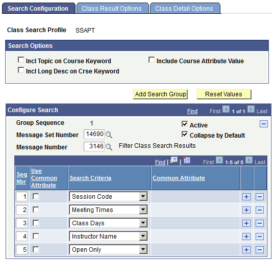

Access the Search Configuration page (
).Note: This page is not used for class search in Fluid.
This example illustrates the fields and controls on the Search Configuration page. You can find definitions for the fields and controls later on this page.
Use this page to define, for each profile, the search criteria that are available on the Search for Classes page. For example, if you select Session Code for the INSTR profile, then instructors who use class search in Self Service can select session as a search criterion.
Search Options
Field or Control |
Description |
Incl Topic on Course Keyword (Include Topic on Course Keyword) |
If this check box is selected and a Class Search Profile includes Course Keyword, then if a user searches by cognitive, the search returns all classes for which cognitive is found in the Course Description or Long Course Title. The search also returns all classes for which cognitive is found in the course topic Description or Formal Description if a Course Topic ID exists for the class. |
Incl Long Desc on Crse Keyword (Include Long Description on Course Keyword) |
If this check box is selected and a Class Search Profile includes Course Keyword, then if a user searches by cognitive, the search returns all classes for which cognitive is found in the Course Description, Long Course Title, or Long Description. |
Include Course Attribute Value |
If a Class Search Profile includes Course Attribute, then:
Configure Search
Field or Control |
Description |
Add Search Group, Group Sequence, and Seq Nbr (sequence number) |
Configure groups of search criteria for a profile and define the sequence order in which fields are displayed on the Search for Classes page. Criteria can used in only one group box within a profile. |
Message Set and Message Number |
Define the labels for class search groupings through the Message Catalog (Message Set 14690). |
Reset Values |
Click this button to access a default setting where all values are displayed and configured into two groups: Class Search, which is expanded by default and Additional Search Criteria, which is collapsed by default. You can then modify the search criteria and groupings. |
Use Common Attribute |
Select this check box to use class association attributes in class search. When you select the check box, the Search Criteria field is not available and the Common Attribute field displays the available class association attributes as defined on the CLASS_ASSOC Record Context. An attribute can be used only once within a profile. When students search for classes from Program Enrollment Self Service, a controlled class search is used. Therefore unlike other class search profiles, you do not need to include Subject and Course Number as search criteria for the SSAPT profile. See Using the Common Attribute Framework to Extend Class Associations for Program Enrollment |

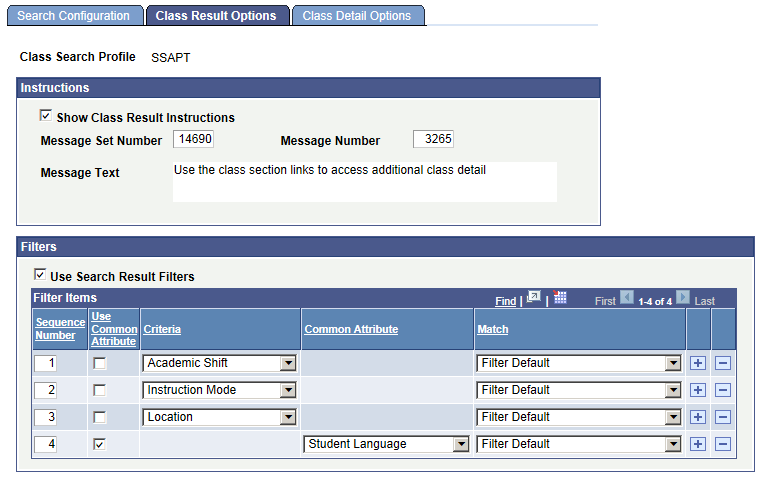

Access the Class Result Options page (
).This example illustrates the fields and controls on the Class Result Options page. You can find definitions for the fields and controls later on this page.
Instructions
You can define user-specific (student, faculty, admin) introductory text which appears on the class Search Results page if the Show Class Result Instructions check box is selected.
Filters
This group box is currently available for SSAPT (Program Enrollment - My Schedule Builder) only.
See Using Program Enrollment Self-Service Features
For information about defining academic shifts (Academic Shift page), see Defining Academic Shifts
For information about how to indicate that you want to use Academic Shift and the setup required to assign a shift to a student (Academic Institution 3 page), see Setting Additional Institution Defaults and Options
For information about attaching an academic shift to a student’s academic program (Student Program page), see Maintaining Student Academic Programs
For information about additional setup required for Common Attribute values, see:
Understanding Common Attribute Framework
Associating a Common Attribute to a Record
Maintaining Student Additional Information
Field or Control |
Description |
Use Search Result Filters |
If you select this check box, filters appear on the class Search Results page, as explained below. |
Sequence Number |
Determines the order in which filters appear on the class Search Results page. |
If you select this check box and then select a Common Attribute value (and the attribute is associated with the relevant associate class in the Schedule of Classes component), then the attribute is available as a filter on the Search Results page when a user searches for classes. When viewing the class search results, the filter check box is selected by default if the attribute is attached to the student's program as well as the relevant associated class and section. The user can change the filter. However, if the Match selection option on the Class Result Options page is Required Match and there is a match on the student's attribute and associated class attribute, then the Search Results page shows matching class sections only. The student cannot change the filter. See Adding Class Association Attributes Using the Schedule of Classes Component |
Criteria |
Select a value to indicate that the criteria should be available as a filter on the Search Results page when a user searches for classes. If you select the Academic Shift criteria, an Academic Shift value must be selected for the class in the Schedule of Classes component. |
Match |
Filter Default: A filter option appears with a check box selected on the class Search Results page when the class search returns a class with sections that match the filter criteria. A student can clear or re-select the check box to expand or narrow the search results. If no match occurs, the filter does not appear on the Search Results page Required Match: The class Search Results page displays only sections that match the required criteria. A filter option appears with a check box selected but the student cannot clear or change the filter criteria. For example, if an institution wants to display to the student only class sections that match the student's campus (see Student Program/Plan component), the institution can define campus as a required match. See Maintaining Student Program Stacks Note: If no matches are found for a given default filter criteria, the respective filter does not display on the Search Results page. For example, if there is a filter default defined for the attribute of student language but there are no sections with the associated class attribute for a student language value, the filter does not display on the Search Results page. Note: If a student accesses My Schedule Builder and only one class section matches the Required Match filter criteria, that section displays on My Schedule Builder. The student does not see the Search Results page. |
