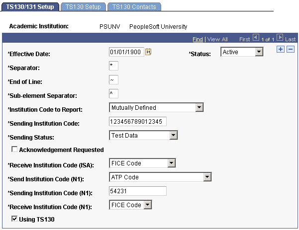

Access the TS130/131 Setup page ().
This example illustrates the fields and controls on the TS130/131 Setup page. You can find definitions for the fields and controls later on this page.
Field or Control |
Description |
Separator |
Insert a character that separates values in the output file. |
End of Line |
Insert a character that ends a line in the output file. This value must be different from the separator value. |
Sub-element Separator |
Insert a character that the system uses to separate component data structure. This character must be different from the separator and end of line delineators. |
Institution Code to Report |
Choose the type of code that you report on the ISA segment (Interchange Control Header Data Element Summary) as the Interchange ID Qualifier for the Interchange Sender ID. The values are ACT Code, ATP Code, FICE Code, IPEDS Code, Mutually Defined, Stat Canada College Student, Stat Canada Postsecondary, and Stat Canada Uni Student Inst. |
Sending Institution Code |
Enter your institution's appropriate code, as determined by the value you select in the Institution Code to Report field. |
Sending Status |
Select Test Data while the institution is sending test files to trading partners. Select Production Data after testing is complete and TS130 outbound transactions are official. |
Acknowledgement Request |
Select to request the receiving institution to respond with a TS997 Functional Acknowledgement. |
Received Institution Code (ISA) |
Choose the type of code that you report on the ISA segment (Interchange Control Header Data Element Summary) as the Interchange ID Qualifier for the Interchange Receiver ID. Values are ACT Code, ATP Code, FICE Code, and IPEDS Code. These values are defined on the Organization Table page for each institution. |
Send Institution Code (N1) |
Choose the type of code that you report on the N1 segment (Name [Sending/Receiving Institution]) as the identification code qualifier. Values are ACT Code, ATP Code, College Board and ACT, FICE Code, IPEDS Code, Statistics Canada College, and Statistics Canada University. |
Sending Institution Code (N1) |
Enter the appropriate code for your institution, as determined by the value entered in the Send Institution Code field. |
Receive Institution Code (N1) |
Select the appropriate code that the institution reports as the recipient in the N1 segment. Values are ACT Code, ATP Code, FICE Code, and IPEDS Code. These values are defined on the Organization Table page for each institution. |
Using TS130 |
Select if you process TS130 outbound transactions for this institution. |
Note: If the characters you enter in the Separator, End of Line or Sub-element Separator fields appear within any text that is included in the output file, the receiving institution recognizes the character and inappropriately separates a field or ends a line. Select characters that are not found in any fields or text that is part of the output file.

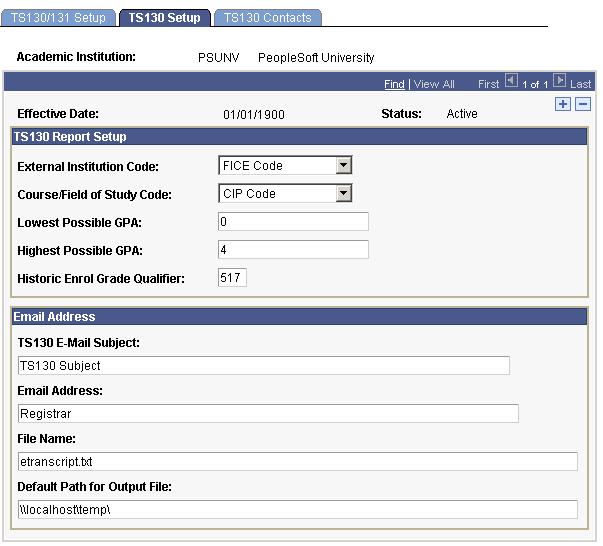

Access the TS130 Setup page ().
This example illustrates the fields and controls on the TS130 Setup page. You can find definitions for the fields and controls later on this page.
Field or Control |
Description |
External Institution Code |
Select the type of code that the institution reports for students' previously attended institutions that are reported for other institutions attended. Values are ACT Code, ATP Code, FICE Code, and IPEDS Code. These values are defined on the Organization Table page for each institution. |
Course/Field of Study Code |
Select the type of course or field of study code that the institution reports. Values are CIP Code and HEGIS Code. Course codes are defined on the Offerings page of the Course Catalog component and field of study codes are defined on the Academic Plan Taxonomy page. |
Lowest Possible GPA |
Enter the numeric value for the lowest possible GPA at this institution to be reported in the SUM (Academic Summary) segment. |
Highest Possible GPA |
Enter the numeric value for the highest possible GPA at this institution to be reported in the SUM (Academic Summary) segment. |
Historic Enrol Grade Qualifier |
Enter the academic grade qualifier code that you report with historical course enrollments. The codes are based on the American Medical Colleges Admissions Services (AMCAS) grade scale. Please refer to Appendix B of the American National Standards Institute Accredited Standards Committee (ANSI ASC) X12 Version 4.0 Implementation Guide dated April 1998. |
TS130 E-Mail Subject |
Enter a free form text that the system uses as the subject line in the email that delivers the TS130. |
Email Address |
Enter free form text that the system uses as the sender of the TS130 email. |
File Name |
Enter the file name that you want the system to use for each TS130 file when the system creates the file. The system inserts the control number before the file extension to identify unique files. |
Default Path for Output File |
Enter the default path to which the system writes the TS130 file at the time it is generated. Note: Users must have write permission for this specified directory to prevent runtime errors. Also, you must enter the final slash in the file path. |
