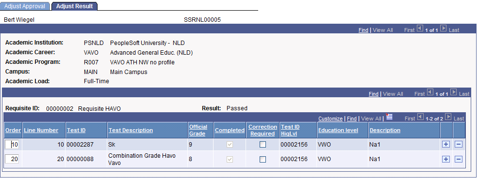

Access the Adjust Result page ().
This example illustrates the fields and controls on the Adjust Result page. You can find definitions for the fields and controls later on this page.
Field or Control |
Description |
Order |
Enter the requisite line number. |
Correction Required |
Select if the test ID, official grade, or test ID higher level on this line can be replaced by another test ID. |
