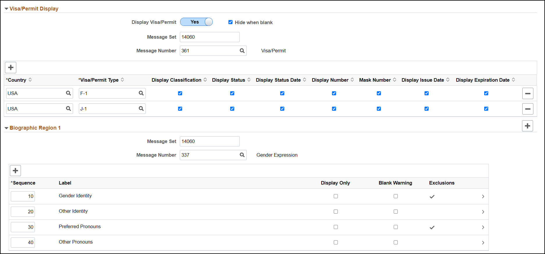

Citizenship Display
Field or Control
Description
Hide when blank
If selected, the region is hidden on the Personal Details page if there are no records to display
Visa/Permit Display
Field or Control
Description
Hide when blank
Note: Only records for defined Visa/Permit Types are displayed on the Personal Details page.
Biographic Regions
You can configure fields to appear in up to 12 Biographic Regions on the Fluid Biographic Details page. By default, only one region appears on the page. Click Add Field (plus sign icon) to add more regions, and the Delete row (minus sign icon) button to remove a region.
Use the Fields grids to define and organize the fields to be displayed. The fields available for display are: Birth Gender, Gender Identity, Other Identity, Preferred Pronouns, Other Pronouns, Sexual Orientation, Other Orientation, Biographical Attribute 1 to 9, Gender, Marital Status, Military Status, and Religious Preference.
A Biographic Region only appears on the Biographic Details page if at least one field is defined in it. If none of the regions have fields defined for them, the Biographic Details page is not displayed.
Define a Message Set, Message Number and Message Text field for each region.
Field or Control
Description
Message Set
Define the Message Set number for the field label. This is a required setting if at least one field is defined in the grid.
Message Number
Define the Message Number for the field label. This field is only enabled if the Message Set field is defined.
Message Text
View the message text for the region label that appears on the Biographic Details page; for example, Gender Expression. Two sample messages are provided: 14060, 337 Gender Expression and 14060, 338 Demographic Information.
Select the icon to add new fields. The icon only appears if there are fields available for selection in the particular region. A field cannot be used in more than one region.
Sequence
Assign a unique two–digit number that controls the display of the field. This is a required value.
Label
View the message text from the message catalog entry defined for the field. The maximum text limit is 100 characters but we recommend that you use 30 characters to avoid word truncation in the display.
Display Only
Select the check box to make the field read-only on the Biographic Details page. If the Display Only, check box is selected, the Blank Warning check box is cleared.
Blank Warning
Select the check box to determine whether a warning is displayed on the Biographic Details page if a field value is blank. You can select the check box only if the Display Only option is not selected.
Exclusions
Indicate whether exclusions have been defined for the field- where a value is not available for selection by students on the Biographic Details page. This allows values that are valid for use on the Personal page for administrative users, for example Unknown, to be excluded from the list of values available on the self-service page. A check mark indicates exclusions.
Editing a Field Setting
Select any row in the grid to edit a field setting. You can edit the Message Set, Message Number and Sequence values. You can also change the setting of the Display Only and Blank Warning check boxes, which are by default, not selected. You can save changes or delete the field from the grid.
Click the Add Exclusions button to add exclusions for a field—translate values to be excluded from the list of available values for selection on the Biographic Details page. The Add Exclusion button does not appear if there are no active translate values associated with the field. If exclusions have been added for a field, they appear in a grid and you can click the plus button to add another exclusion. You can also delete exclusions using the minus button.
For the Citizenship, Visa/Permit, Biographic Regions, the region titles on the Self-Service Profile pages are derived from the Message Text field in the Message Catalog setup. You can create, view, and make changes to the Message Catalog using the PeopleTools Message Catalog component (PeopleTools > Utilities > Administration > Message Catalog).
Note: If the Other text field is included with the coded field, for example, both Gender Identity and Other Identity are included; then both should be included in the same region and the sequence values should be defined so that the fields appear together on the Biographic Details page. Ensure that the Display Only value is the same for both fields for consistent display.

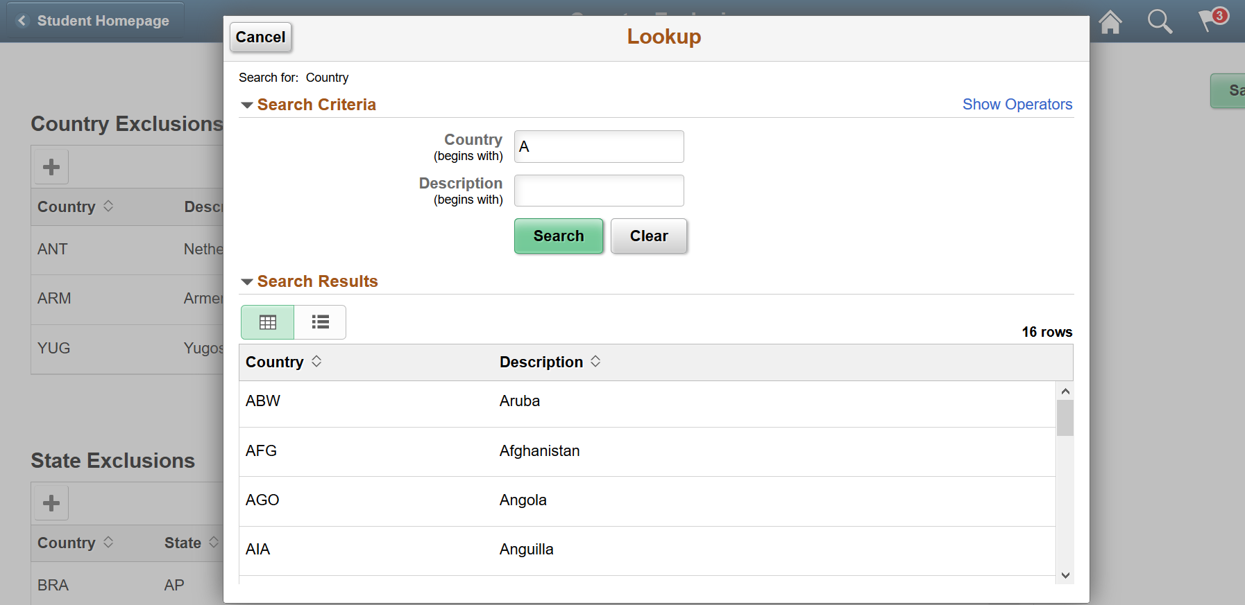

Access the Country Exclusions page (Set Up SACR > Common Definitions > Self Service > Campus Community > Country Exclusions).
Use this page to exclude any country or state value from Address prompts. The Country Exclusions grid is prepopulated with Netherlands Antilles (ANT) and Yugoslavia (YUG), with the Address Exclusion check box selected.
This example illustrates the fields and controls on the Country Exclusions page- Lookup feature.
You can add or delete a row from the grid using the plus and minus icons. When adding a country or state, you can use the Lookup page to search for the value to add. The Country Lookup prompt displays all records in the Country Table minus any Country values already defined in the Country Exclusions grid. Similarly, the State Lookup excludes any values set up in State Exclusions with Exclude from Addresses selected.
Note: In the State Lookup, existing filters for USA and CAN also apply. For USA, records without a numeric code are excluded; with the exceptions of AA, AE, AP, AS, GU, MP, PR, and VI. For CAN, records without a numeric code are excluded. Since these values are already excluded from the State Lookup prompt, you do not need to specifically set them up as exclusions.
