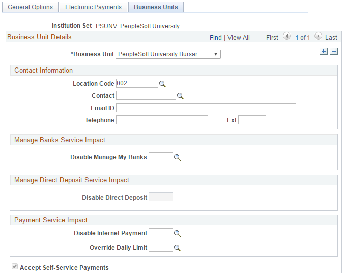

Business Units |
INSTITUTION_SET_02 |
Define business unit parameters. |
Access the General Options page (

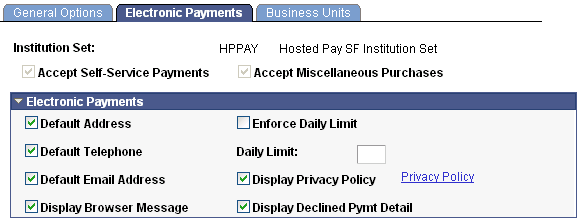

Access the Electronic Payments page (
).This example illustrates the fields and controls on the Electronic Payments page (1 of 2). You can find definitions for the fields and controls later on this page.
This example illustrates the fields and controls on the Electronic Payments page (2 of 2). You can find definitions for the fields and controls later on this page.
Note: Most of the fields on the Electronic Payments page are specific to each business unit in the institution set, not to the institution set as a whole. If you have multiple business units associated with the institution set, be sure to insert a row and enter the information on the Electronic Payments page for each business unit. Also, if you have more than one business unit associated with your institution set, you must enter a priority ranking for each (see following). The exceptions to this are the service impact and service indicator codes, which are institution set-specific, not business unit-specific.
To control what charges the student can pay towards in self service, you must ensure that the item type contains the correct charge priority list. The charge priority list that you assign to the eCheck item type can differ from the credit card item type. In this way, you can control whether particular charges can be paid by one payment method versus another. Be sure to specify the correct tender category (eCheck or credit card) on the item type so that it is available to select here.

Electronic Payments
Field or Control |
Description |
Default Address |
Select to make the address fields on the Make a Payment - Specify Payment Details page available for input. |
Default Telephone |
Select to make the telephone field on the Make a Payment - Specify Payment Details page available for input. |
Default Email Address |
Select to make the email field on the Make a Payment - Specify Payment Details page available for input. |
Display Browser Message |
Select this check box:
You define the browser requirements message and detail on the Payment Merchant page. |
Enforce Daily Limit and Daily Limit |
Select the Enforce Daily Limit check box to limit the number of self-service payments a student can make per day to the value that you enter in the Daily Limit field. For example, if you set up and institution set with both a credit card merchant ID and an electronic check merchant ID, and enter a daily limit of 4, then a student can make any combination of eCheck and credit card transactions up to a maximum of four total transactions per day. If a student exceeds the limit, the system prevents the student from making additional self-service payments until the following day. |
Display Privacy Policy |
Select to display the Privacy Policy link on the Make a Payment - Confirm Payment page if a school uses the hosted payment feature and on the Make a Payment - Specify Payment Details page if the school does not use the hosted payment feature. The privacy policy is optional and user defined. |
Privacy Policy |
Click to access the Institution Set Privacy Policy page and define a privacy policy for your institution. |

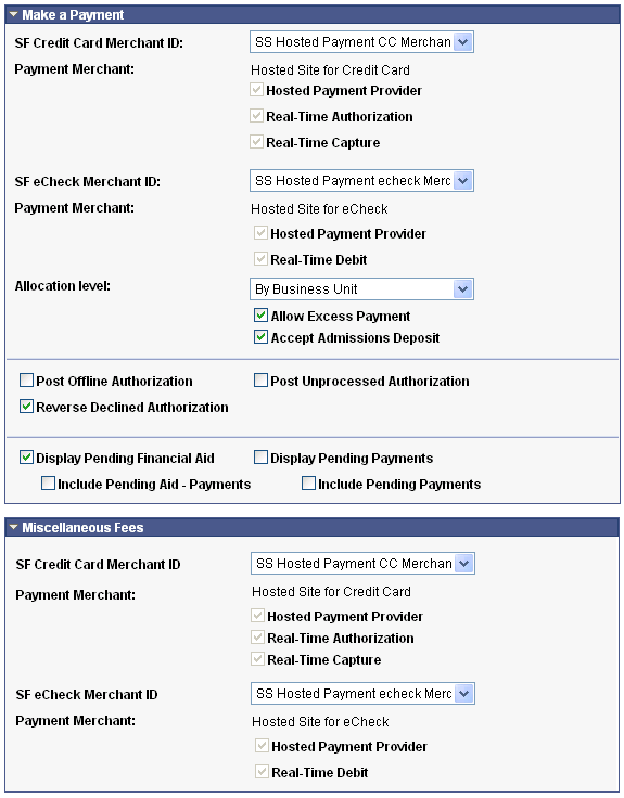

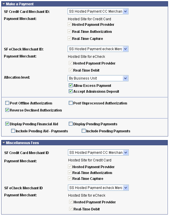

Make a Payment
Important! PeopleSoft Business Interlinks is a deprecated product. The Business Interlinks class currently exists for backward compatibility only. For new integrations, use Integration Broker instead.
Your selections here determine what students see in the Make a Payment self-service component. For instance, if you clear the Display Pending Financial Aid check box, then the student's anticipated aid is not displayed anywhere in the Make a Payment self-service component.
Field or Control |
Description |
SF Credit Card Merchant ID and SF eCheck Merchant ID |
Select a credit card SF merchant ID, an eCheck SF merchant ID, or both for an institution set. This determines which payment type is supported for this institution set: credit card only, eCheck only, or both. If you select a value in both the SF Credit Card Merchant ID and the SF eCheck Merchant ID fields, the Select Payment Method page prompts students to select one of two payment types from the drop-down list box—Pay by Credit Card or Pay by Electronic Check,—before they are permitted to enter self-service payment information. If you select a value in only one of these fields, then the system takes students directly to the Make a Payment - Specify Payment Details page because only one valid tender option is available for self-service payment. The Make a Payment page using Fluid user interface always begins with Step 1, Select Payment Method. See Making Electronic Payments. Note: Depending on the charge priority rules assigned to the ePayment item type, the student may not be presented with all charges to pay—the student is presented only those charges that are a part of the charge priority list that is associated with the ePayment credit card or eCheck item type. |
Payment Merchant |
The check boxes are selected or deselected by default depending on the setup on the SF Merchants page and are not available for edit on this page. Note: If both credit card and eCheck are available as payment methods for an institution set, both payment methods must be either hosted or non-hosted. For example, if you define an institution set that allows credit card payment with hosted payment and eCheck with non-hosted payment, you receive an error message advising that SF merchants have conflicting payment merchant values. You can, however, use Business Interlink for one payment method and Integration Broker for another. Also, across features, you can use both hosted and non-hosted payment—for example, you can use hosted payment for Make a Payment setup and non-hosted for Miscellaneous Fees setup. |
Allocation Level |

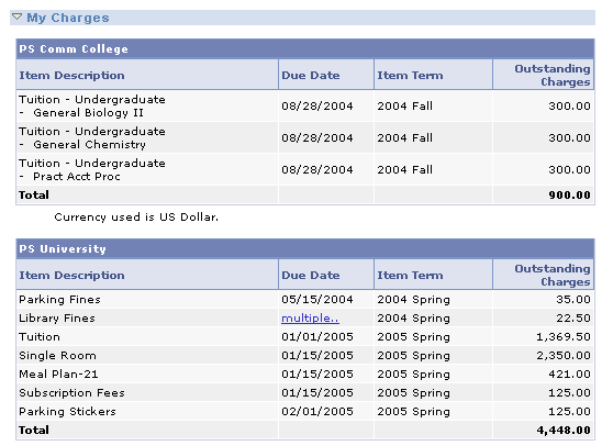

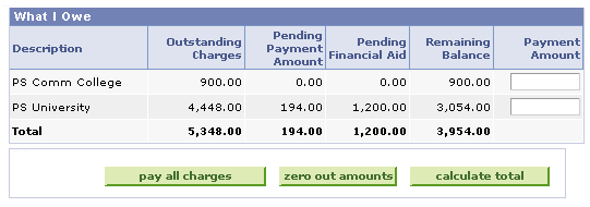

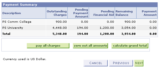

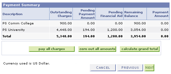

Use the allocation level to define how charges and payments are displayed on a self-service page. |
Allocation Level By Business Unit
This page displays all charges that the student incurred by business unit on the Make a Payment self-service component. Displaying charges in this manner forces the student to pay all or a portion of the charges by business unit. The Student Financials posting process invokes the appropriate charge priority and payment overall priority rules to the self-service payments.
This example illustrates the fields and controls on the Allocation Level By Business Unit page (1 of 2). You can find definitions for the fields and controls later on this page.
This example illustrates the fields and controls on the Allocation Level By Business Unit page (2 of 2). You can find definitions for the fields and controls later on this page.

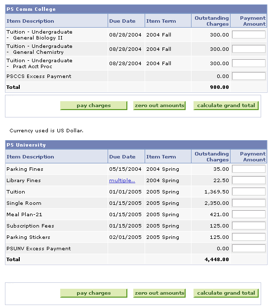

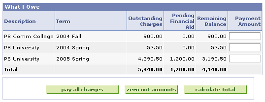

Allocation Level by Charge
This page displays each charge that the student incurred individually by business unit on the Make a Payment self-service component. Displaying charges in this manner permits the student to pay all or a portion of each charge. The Student Financials posting process bypasses the established charge priority and payment overall priority rules and uses the amounts that the student indicates during the self-service transaction. The resulting effect is that the student can choose which charges to pay, thus creating a scenario in which older, more pressing charges can be ignored while newer charges can be reduced.
This example illustrates the fields and controls on the Allocation Level by Charge page (1 of 2). You can find definitions for the fields and controls later on this page.
This example illustrates the fields and controls on the Allocation Level by Charge page (2 of 2). You can find definitions for the fields and controls later on this page.

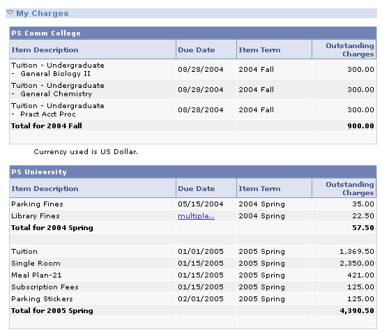

Allocation Level by Term
This page displays all charges that the student incurred by term within each business unit on the Make a Payment self-service component. Displaying charges in this manner permits the student to pay all or a portion of a term's charges—these charges are aggregated by business unit whereby the student cannot pay each individual charge. The Student Financials posting process invokes the appropriate charge priority and payment overall priority rules to the self-service payments.
Note: For the Allocation Level by Term feature to work, you must set Term, Payment Term First for Sort 1 of the Charge Sort for Payment Overall Priority attribute for applicable ePayment item types.
This example illustrates the fields and controls on the Allocation Level by Term page (1 of 2). You can find definitions for the fields and controls later on this page.
This example illustrates the fields and controls on the Allocation Level by Term page (2 of 2). You can find definitions for the fields and controls later on this page.
Field or Control |
Description |
Allow Excess Payment |
Select to allow students to make ePayments in excess of their balance due. |
Accept Admissions Deposit |
Select to accept payment for admissions deposits by credit card over the internet. The application center does not accept payment by eCheck. |

Description |
Post Offline Authorization |
Select to post transactions in real time, even though you authorize the transactions through a batch process. This field is available only if you do not select the Credit Card Authorization option on the SF Merchants page. Note: This is not used in Fluid functionality. |
Post Unprocessed Authorization |
Select to post credit card transactions that fail while performing real-time authorization due to a connection problem. If you cleared this check box, the system posts only transactions with fully processed authorizations. Note: Consider the implications if transactions posted in real time fail authorization when processed at a later point in time (such as payment reversals and discharge of service indicators). Note: This is not used in Fluid functionality. |
Reverse Declined Authorization |
Select to automatically reverse a posted transaction when a credit card transaction is declined. This option should always be selected if you choose to post transactions with payments authorized offline (see above). Note: This is not used in Fluid functionality. |
Your next selections determine what students see in the Make a Payment self-service component. For instance, if you clear the Display Pending Financial Aid check box, then the student's anticipated aid is not displayed anywhere in the Make a Payment self-service component.
Note: Pending Financial Aid isn't displayed in CS Self Service (Classic, Fluid and Student Center) if you have integrated with Oracle Student Financial Planning (SFP) for financial aid processing. The display of Pending Financial Aid is dependent on the record PS_STDNT_AWRD_DISB which is populated for CS Financial Aid, but not for SFP.
Field or Control |
Description |
Display Pending Financial Aid |
Select to display anticipated aid as a line item on the Make a Payment - Specify Payment Amount page in the What I Owe grid. With this check box selected, anticipated aid appears on the page as a line item only and does not reduce the remaining balance amount. Students are informed of any anticipated aid, but their total charges are not reduced by the anticipated aid. If this check box is cleared, then the student's anticipated aid does not appear anywhere in the Make a Payment self-service component. |
Include Pending Aid – Payments |
Select to use pending financial aid to reduce the remaining balance amounts on the Make a Payment - Specify Payment Amount page. This check box must be used in conjunction with the Display Pending Financial Aid check box for the remaining balance amount to be reduced by anticipated aid. If this check box is selected, the student's total charges are reduced and the student is informed of any anticipated aid. If Display Pending Financial Aid and this check box are both cleared, then the student's anticipated aid does not appear anywhere in the Make a Payment self-service component. |
Display Pending Payments |
Select to display the student's pending payments on the Make a Payment - Payments page and the Make a Payment - Specify Payment Amount page. If this check box is cleared, then the student's pending payments do not appear anywhere in the Make a Payment self-service component. Note: This is not used in Fluid functionality. |
Include Pending Payments |
If this check box is selected, then the student's balance is reduced by the payment amount. This check box must be used in conjunction with the Display Pending Payments check box for the remaining balance amount to be reduced by any payments made. If Display Pending Payments and this check box are both cleared, then the student's pending payments do not appear anywhere in the Make a Payment self-service component. Note: This is not used in Fluid functionality. |
Miscellaneous Fees
Note: This group box is not used in Fluid functionality.
Use these fields if your institution wants to set up separate merchant IDs for miscellaneous purchases as opposed to regular tuition payments.
Field or Control |
Description |
Select a credit card SF merchant ID, an eCheck SF merchant ID, or both for miscellaneous fees. This determines which payment type is supported for this institution set: credit card only, eCheck only, or both. If you select a value in both the SF Credit Card Merchant ID and SF eCheck Merchant ID fields, the Select Payment Method page prompts students to select one of two payment types from the drop-down list box—Pay by Credit Card or Pay by Electronic Check—before they are permitted to enter self-service payment information. If you select a value in only one field, the system takes students directly to the Make a Payment - Specify Payment Details page because only one valid tender option is available for self-service payment. For miscellaneous purchases, the setup on the Purchase Items setup component (SSF_PUR_ITEM_TABLE) determines the items that are presented for purchase. Because these are optional purchases, they do not exist until the student (or user) elects to purchase these items. Because these are paid for at the time of selection, charge priority rules do not affect miscellaneous purchases. |
Payment Merchant |
The check boxes are selected or cleared by default depending on the setup on the SF Merchants page and are not available for edit on this page. Note: If both credit card and echeck are available as payment methods for an institution set, both payment methods must be either hosted or non-hosted. For example, if you define an institution set that allows credit card payment with hosted payment and eCheck with non-hosted payment, you receive an error message advising that SF merchants have conflicting payment merchant values. You can, however, use Business Interlink for one payment method and Integration Broker for another. (For credit cards, Security Code is supported only by Integration Broker). Also, across features, you can use both hosted and non-hosted payment—for example, you can use hosted payment for Make a Payment setup and non-hosted for Miscellaneous Fees setup. |
Access the Business Units page (
).This example illustrates the fields and controls on the Business Units page (1 of 2). You can find definitions for the fields and controls later on this page.
This example illustrates the fields and controls on the Business Units page (2 of 2). You can find definitions for the fields and controls later on this page.
This page is used for both classic and fluid self service.
Note: Most of the fields on the SF Institution Set - Business Units page are specific to each business unit in the institution set, not to the institution set as a whole. If you have multiple business units associated with the institution set, be sure to insert a row and enter the information on the SF Institution Set - Business Units page for each business unit. Also, if you have more than one business unit associated with your institution set, you must enter a priority ranking for each (see below). The exceptions to this are the service impact and service indicator codes, which are institution-set-specific, not business-unit-specific.
Field or Control |
Description |
Business Unit |
Enter the business unit that you want to include in this institution set. |
Contact Information
Field or Control |
Description |
Location Code |
Select a location code to display a remittance address on the Account Summary and Total Due Charges pages. |
Contact |
Select the ID of the individual assigned to be the contact person in the event of web credit card transaction problems. |
Email ID |
Enter the email address of the contact person. |
Telephone |
Enter the telephone number of the contact person. |
Ext (extension) |
Enter the telephone extension of the contact person (if applicable). |
Manage Banks Service Impact
Note: This group box is not used in Fluid functionality. If Direct Deposit Enrollment is enabled for fluid self service, then this grid is disabled.
Use the Disable Manage My Banks service impact to remove student access to the Manage My Bank Accounts pages in Self Service. If a student has this service impact, the student cannot set up new bank accounts or edit existing bank account details. This service impact does not prevent direct deposit refunds from being distributed to existing bank accounts.
After you verify that the student cannot access the Manage My Bank Accounts component in Self Service, revoke the bank agreement if one exists.
Manage Direct Deposit Service Impact
Use Disable Direct Deposit service impact to prevent a student from accessing the Direct Deposit page in Fluid self service. This could be a temporary action because of fraud or a similar event.
See Managing Financial Accounts Using PeopleSoft Fluid User Interface.
Payment Service Impact
Field or Control |
Description |
Disable Internet Payment |
Select the negative service impact code that the system uses to disable a customer's ability to pay on the internet using a credit card. If students have this impact on their account, they cannot access the Make a Payment page. |
Override Daily Limit |
Select the positive service impact code that the system uses to enable customers to bypass the daily limit for credit card payments. If students have this impact on their account, they can make credit card payments in excess of the daily limit. |
Field or Control |
Description |
Accept Self-Service Payments |
This is a display-only field that shows whether Accept Self Service Payments has been selected in the General Options setup. This means that web credit-card payments are authorized for this business unit. |

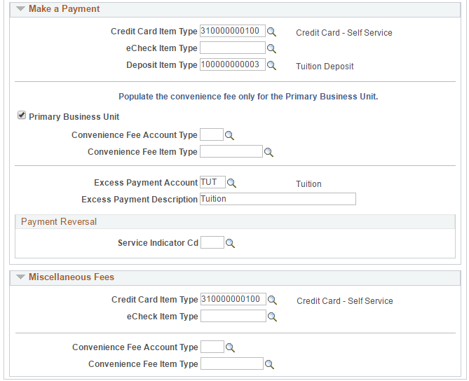

Make a Payment
Field or Control |
Description |
Credit Card Item Type |
Enter the item type that the system uses for self-service credit card transactions entered for this institution set. Note: The payment item type that you select must specify credit card as a tender type. |
eCheck Item Type |
Enter the item type that the system uses for self-service eCheck transactions entered for this institution set. Note: The payment item type that you select must specify electronic check as a tender type. |
Deposit Item Type |
If you accept web credit card payments for admission deposits, select the item type that is defined for admission deposits. |
Primary Business Unit |
Select to designate the business unit as the one to which the system assigns ePayment transaction surcharges. Note: You can designate only one business unit per institution set as the primary business unit. |
Convenience Fee Account Type |
If you charge a convenience fee on credit card transactions, select the account to which the system posts charges resulting from a credit card transaction convenience fee. Note: If you charge a convenience fee, the payment item type used for credit card transactions must include the account type of your convenience fee item type on the account type page. |
Convenience Fee Item Type |
If you charge a convenience fee on credit card transactions, select the item type that the system uses when posting charges resulting from a credit card transaction convenience fee. Note: If you are charging a convenience fee, the item type specified here must be included in one of the Allowable Charges tree nodes in the charge priority list used by the credit-card payment item type. This charge priority list is specified on the item type miscellaneous page. |
Excess Payment Account |
Select the account to which the system posts credit card payments in excess of customer balances. If it is different , this selection overrides the excess payment account that you select in the Posting Setup 1 page of the SF Business Unit component (BUSINESS_UNIT_SF). |
Excess Payment Description |
Enter the label that you want to display for excess payments. This description overrides the description of the item type for credit-card payment and appears on the Allocate Payment page in the Future Charges section. |
Payment Reversal
Field or Control |
Description |
Service Indicator CD |
Select the negative service indicator code that the system attaches to student records when transaction authorizations fail and payments are reversed. |
Miscellaneous Fees
This setup allows different payment item types and convenience fee item types to be used as opposed to the regular Make a Payment item types.
Field or Control |
Description |
Enter the item type that the system uses for self-service credit card transactions entered for this institution set for paying for miscellaneous purchases. Note: The payment item type that you select must specify credit card as a tender type. |
eCheck Item Type |
Enter the item type that the system uses for self-service eCheck transactions entered for this institution set to pay for miscellaneous purchases. Note: The payment item type that you select must specify electronic check as a tender type. |
If you are charging a convenience fee on credit card transactions for miscellaneous purchases, select the account to which the system posts charges resulting from a credit-card transaction convenience fee. Note: If you are charging a convenience fee, the payment item type used for credit card transactions must include the account type of your convenience fee item type on the account type page. |
If you are charging a convenience fee on credit card transactions, select the item type that the system uses when posting charges resulting from a credit card transaction convenience fee. Note: If you are charging a convenience fee, the item type specified here must be included in one of the Allowable Charges tree nodes in the charge priority list used by the credit card payment item type. This charge priority list is specified on the item type miscellaneous page. |
