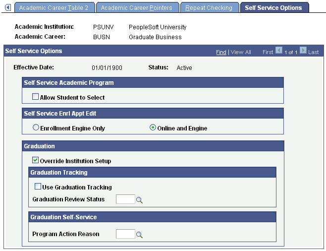

Self Service Options |
SSR_ACDCAR_SELFSRV |
Set up for career-specific usage of the graduation tracking process. |
Graduation |
SSR_PROG_TBL_GRAD |
Set up for program-specific usage of the graduation tracking process. |

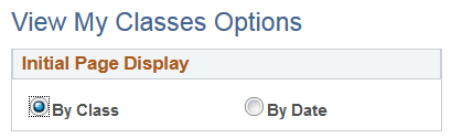

View My Classes Options |
SSR_VWCLSCHDOPT_FL |
Select how the initial page displays class schedules. |

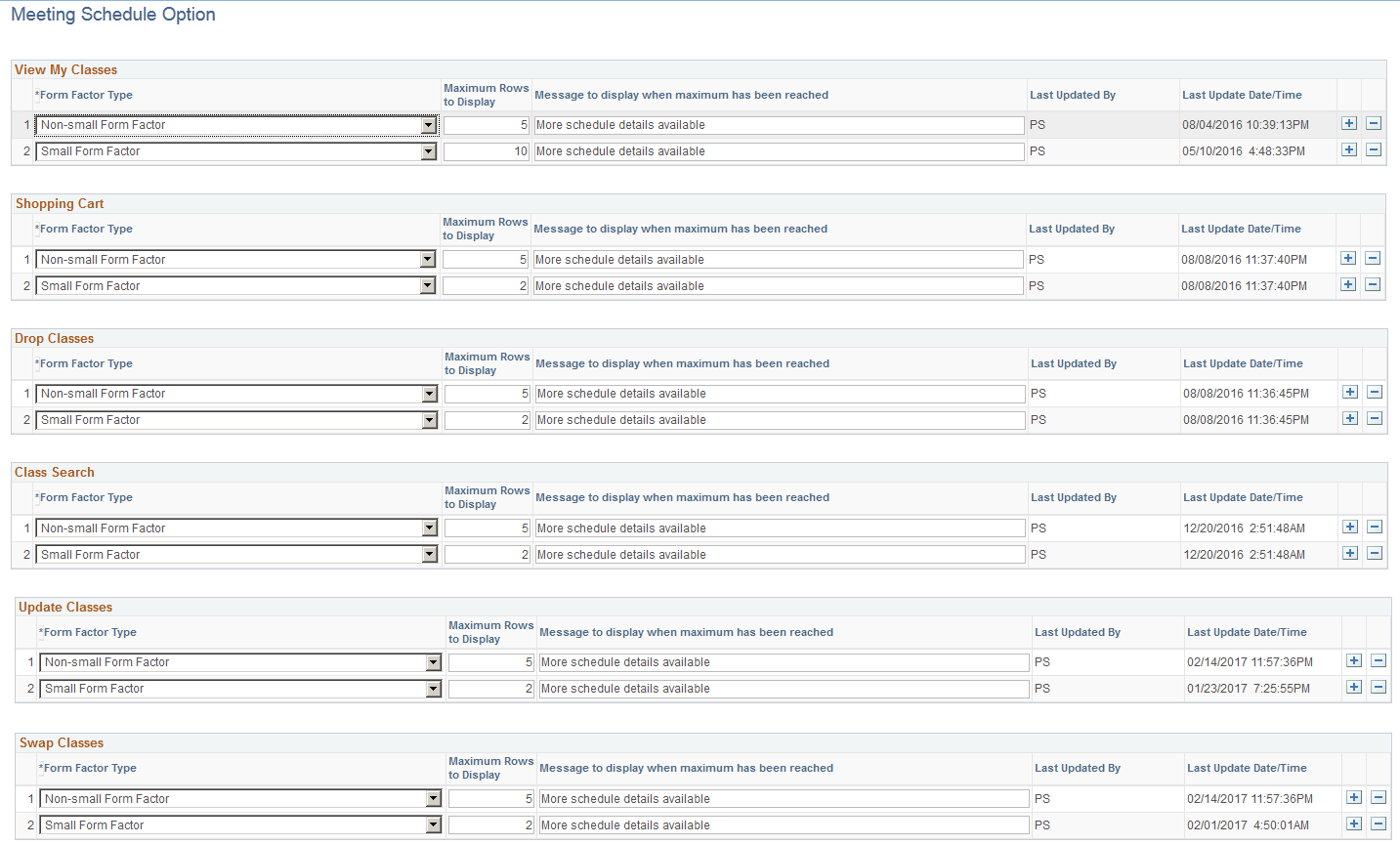

Meeting Schedule Option |
SSR_MTGSCHDOPT_FL |
Determine the number of meeting patterns that appear for each class in Fluid user interface. |

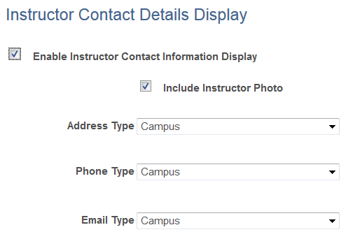

Instructor Contact Options |
SSR_INSTRDSP_FL |
Set up the options for displaying instructor information on the Class Information modal page for View My Classes, Drop Classes, Shopping Cart, and Class Search in Fluid user interface. |

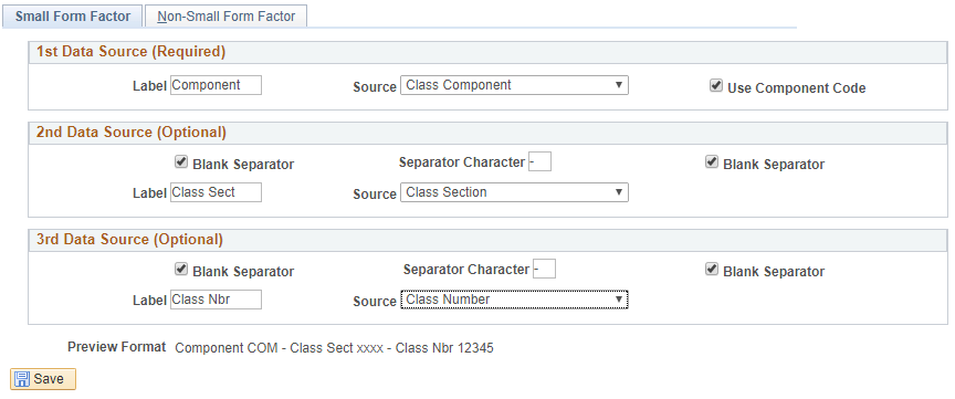

Class Label Setup – Small Form Factor Class Label Setup – Non-small Form Factor |
SSR_CLASSLBL1_FL SSR_CLASSLBL2_FL |
Set up labels for mobile devices and desktops or laptops |

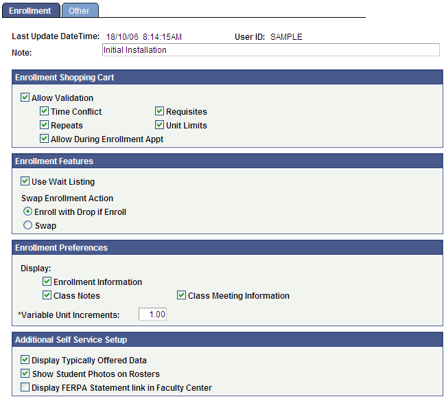

Access the Enrollment page ().
This example illustrates the fields and controls on the Enrollment page. You can find definitions for the fields and controls later on this page.
Field or Control |
Description |
Note |
Enter descriptive information about the setup. This field is for informational purposes only. |
Enrollment Shopping Cart
Note: These features are also used to set up Class Search and Enrollment for PeopleSoft Fluid User Interface.
Field or Control |
Description |
Allow Validation |
Select to enable the Validation feature. This feature enables self-service users to validate their Shopping Cart entries against a subset of edits from the Enrollment Engine. You can select which edits the Enrollment Engine runs. The options are time conflicts, repeats, requisites, and unit limits. If you select this check box, you must select at least one of these options. If you clear this check box, all references to validation in the system are hidden. |
Time Conflict |
Select this check box if you want the Enrollment Engine to check time conflicts while validating Shopping Cart entries. |
Repeats |
Select this check box if you want the Enrollment Engine to check repeats while validating Shopping Cart entries. |
Allow During Enrollment Appt (allow during enrollment appointment) |
Select to enable users to validate their Shopping Cart entries during their enrollment appointment. If you select this check box, the Validate button appears in the Shopping Cart during the student's enrollment appointment. If you clear this check box, the Validate button is not available in the Shopping Cart during the student's enrollment appointment. This option prevents you from having to set up validation appointments that parallel your enrollment appointments. |
Requisites |
Select this check box if you want the Enrollment Engine to check requisites while it validates Shopping Cart entries. |
Unit Limits |
Select this check box if you want the Enrollment Engine to check unit limits while it validates Shopping Cart entries. |
Enrollment Features
Field or Control |
Description |
Use Wait Listing |
Select to enable wait listing. If you clear this check box, the system hides all references to wait listings in self-service. If you clear this check box, the system selects the Swap option by default and makes the Enroll with Drop if Enroll and Swap fields unavailable for edit. Note: This field is used to set up Class Search and Enrollment for PeopleSoft Fluid. |
Swap Enrollment Action |
This field controls the processing of enrollment requests submitted from the Swap component in student self-service. Select one of these options: Enroll with Drop if Enroll: Select this check box to enable Drop if Enroll processing for self-service swaps. If you select this check box, when a student swaps from one class to another or to a different enrollment component of the same class, the enrollment engine drops the student from the class that the student wants to swap only after the student is enrolled in the preferred class. The enrollment engine does not drop a student who is on the wait list for the preferred class. The enrollment engine processes the preferred class with an enrollment action of Enroll. Swap: If you select this check box, when a student swaps from one class to another (or a different enrollment section of the same class), the enrollment engine drops the student from the unwanted class if they are successfully enrolled or when they are placed on the wait list in the preferred class. Note: If the swap is for non-enroll components only, the request is processed with a Swap action regardless of the option that is selected on this setup page. When a student tries to swap only the non-enroll component(s) on the Swap component (no change to the enrollment component), the transaction is submitted to the enrollment engine with an enrollment action of Swap (instead of Enroll with Drop if Enroll). This ensures that the student is enrolled (or wait listed) in the right combination of enrollment and non-enroll components. For example, if a student is enrolled in CHEM 102 lecture section 1 plus related lab 1A and tries to swap to a closed lab, 1B, electing to wait list, the transaction is submitted as non-enroll swap (for example, swap section 1 to section 1 with related section 1B) where the student's status will be changed from enrolled to wait listed for the lecture section, wait listed in the non-enroll lab section (1B), and dropped from their original lab section (1A). |
Enrollment Preferences
Select the information that you want to appear in student self service.
Field or Control |
Description |
Enrollment Information |
Select to display enrollment requisite information about the self-service Enrollment Preferences page during the enrollment process. |
Class Notes |
Select to display class notes information on the self-service Enrollment Preferences page during the enrollment process. |
Class Meeting Information |
Select to display class meeting information on the self-service Enrollment Preferences page during the enrollment process. |
Variable Unit Increments |
Enter a value to control how unit increments appear to students when students select a unit value for a variable unit course. For example, if students are allowed to enroll in half units, enter 0.50 in this field. A student who enrolls in a class with a variable unit range of 1 to 3 units is then presented with the following options: 1.00, 1.50, 2.00, 2.50, 3.00. |
Additional Self Service Setup
Field or Control |
Description |
Display Typically Offered Data |
Select to display when a course is usually offered at the institution. If this check box is selected, the data appears on a variety of self-service pages, including Browse Course Catalog, Course Detail, My Planner, and My Academic Requirements. If you clear the check box, the system does not display typically offered data within self-service, but it continues to display it on administrative pages. Typically offered values are institutionally defined within a typically offered setup page. They are then assigned to courses on the Course Catalog - Offerings page. |
Show Student Photos on Rosters |
Select this check box if you want student photos to appear on the class and advisee rosters in the Faculty Center. |

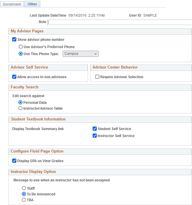

Access the Other page ().
This example illustrates the fields and controls on the Other page. You can find definitions for the fields and controls later on this page.
My Advisor Pages
Use the My Advisor Pages group box to control the display of phone details of advisors, committee members, or both on the My Advisors page.
Note: You should select the same advisor phone number value on this page and on the Student Center Options page in the Student Center component (SSS_STUDENT_CENTER).
Advisor Self Service
Field or Control |
Description |
Allow access to non-advisees |
If this check box is selected, the VIEW DATA FOR OTHER STUDENTS button becomes available on the View My Advisees – Advisee Roster page in Faculty Center. The check box is selected by default. Advisors can access student data for non-advisees by clicking the VIEW DATA FOR OTHER STUDENTS button, which takes them to a search page. If the Allow access to non-advisees check box is cleared, advisors cannot access student data for non-advisees. The VIEW DATA FOR OTHER STUDENTS button is hidden. If, when viewing an advisee's data, an advisor clicks the Return to Search button, the advisor is taken to a search page on which only their advisees are available. |
Faculty Search
Use this group box to control the data that you want to search against when you use the Locate a Faculty Member page in Faculty Center.
You can search against the entire population in the database or against data in the Instructor/Advisor Table component (INSTR_ADVSR_PERS).
Field or Control |
Description |
Personal Data |
Select this option to search against the entire population in the database when you use the Locate a Faculty Member page in Faculty Center. |
Instructor/Advisor Table |
Select this option to search against data in the Instructor/Advisor Table component when you use the Locate a Faculty Member page in Faculty Center. |
Warning! You must be careful when setting up Self Service Faculty Search. You do not have to use the Instructor/Advisor Table component to assign instructors to classes. You should therefore select the option to edit the search for faculty members against data in the Instructor/Advisor Table component only if the Instructor/Advisor option is selected in the Edit Instructor Against group box on the Academic Organization Table page.
Student Textbook Information
Field or Control |
Description |
Display Textbook Summary link |
If you select the Student Self Service and Instructor Self Service check boxes, the View Textbook Summary link appears on the Student Self Service, My Class Schedule page and the Faculty Center, My Schedule page. Students and faculty staff can use the link to access a summary of the textbook assignments for each of their classes for the term. Clear the check boxes if you do not use the textbook feature or if you want to disable access to the Textbook Summary page. |
Configure Fluid Page Option
In this group box, choose whether to display a student's GPA on the fluid View Grades page.

Instructor Display Option
When a class schedule doesn't have an assigned instructor, use this group box to select what appears in place of an instructor's name.

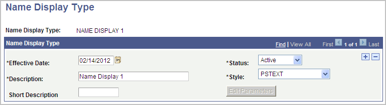

Access the Name Display Type page (click the Add Name Display Type link on the Academic Institution 8 page).
This example illustrates the fields and controls on the Name Display Type page. You can find definitions for the fields and controls later on this page.
The Name Display framework provides a configurable solution that allows institutions to define how a display name appears for graduation. This functionality is available only on the View Graduation Status page in self service.
There are four delivered Style choices; these are currently not enabled for the View Graduation Status page.
Click the Edit Parameters button to access the Name Display Type Parameters page where you can further define how names appear.

Access the Self Service Options page ().
This example illustrates the fields and controls on the Self Service Options page. You can find definitions for the fields and controls later on this page.
Field or Control |
Description |
Override Institution Setup |
If you select this check box, the Graduation Tracking and Graduation Self-Service group boxes appear. |
Use Graduation Tracking |
Select this check box to add a row to the graduation tracking process during self-service apply for graduation. Then select the appropriate Graduation Review Status. |
Program Action Reason |
Select the appropriate program action reason. |

Access the View My Classes Options page ().
This example illustrates the fields and controls on the View My Classes Options page. You can find definitions for the fields and controls later on this page.
Use this page to select whether the initial page displays the class schedules By Class or By Date.
Access the Meeting Schedule Option page ().
This example illustrates the fields and controls on the Meeting Schedule Option page. You can find definitions for the fields and controls later on this page.
Use this page to set the number of meeting patterns that appear for each class in Fluid user interface.
Field or Control |
Description |
Form Factor Type |
Set the form factor on which the schedules appear.
Maximum Rows to Display |
Define the maximum number of schedules that appear on the View My Classes – By Class, Shopping Cart, Drop Classes, Class Search, Update Classes, or Swap Classes pages. The maximum number of schedules that appear on the page is 10. If you do not configure the Meeting Schedule Option, by default the maximum number of schedules is displayed. |
Message to display when maximum has been reached |
Set the message that appears to students when there are more schedules than the maximum number of rows you have set to appear on the View My Classes – By Class, Shopping Cart, Drop Classes, Class Search, Update Classes, or Swap Classes pages. |
Access the Instructor Contact Details Display page ().
This example illustrates the fields and controls on the Instructor Contact Details Display page. You can find definitions for the fields and controls later on this page.
Access the Class Label Setup page ().
This example illustrates the fields and controls on the Class Label For Small Form Factor. You can find definitions for the fields and controls later on this page.
Use these pages to display class information like class section and class number in Class Search results for mobile devices (small form factor) or desktops and laptops (non-small form factor) in Fluid user interface. The fields on the Small Form Factor page applies to the Non-Small Form Factor page.
Field or Control |
Description |
Preview Format |
As you assign values to the various data sources on this page, this field automatically adjusts to show you an example of how the label appears on Fluid user interface. |
1st Data Source (Required)
Use this group box to set up the first data source as a component. These fields apply to the 2nd and 3rd Data Source.
Field or Control |
Description |
Label |
Enter the label you want to use. This label appears on the user interface. |
Source |
Select Class Component. For the 2nd and 3rd Data Source group boxes, select either Class Section or Class Number. |
Use Component Code |
Select to display the component code. |
2nd and 3rd Data Source (Optional)
This group box is optional. However, you can use this to include class section to classes when viewed in PeopleSoft Fluid User Interface. To include class section in Fluid, set the Source field to Class Section.
Field or Control |
Description |
Blank Separator |
Select this check box to insert a blank space between the label and source. |
Separator Character |
Enter a character, for example, a dash. This character is inserted between the label and the source to visually separate the text. |
Blank Separator |
Select this check box to insert a blank space between the label, separator character, and source. |
