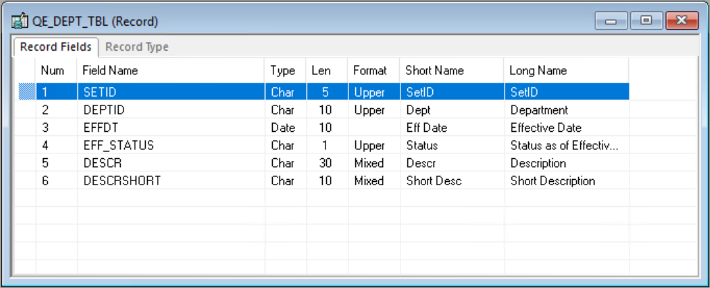

Use the Record Fields tab to access the fields that compose the record definition.
This example illustrates the fields and controls on the Record Fields tab.

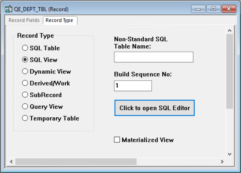

Use the Record Type tab to specify way that the record definition is to be used, for example a SQL table or view, or perhaps a temporary table.

Select the Record Type tab to view the record definition types. Select from these types:

SQL View
Select to define a record definition that corresponds to a SQL view, which is not a physical SQL table in the database but fields from one or more SQL tables that are reorganized into a different sequence. SQL view provides an alternate view of information that is stored in tables.
To create the SQL view, click the Click to open SQL Editor button, enter a SQL Select statement, and then run the Build process.

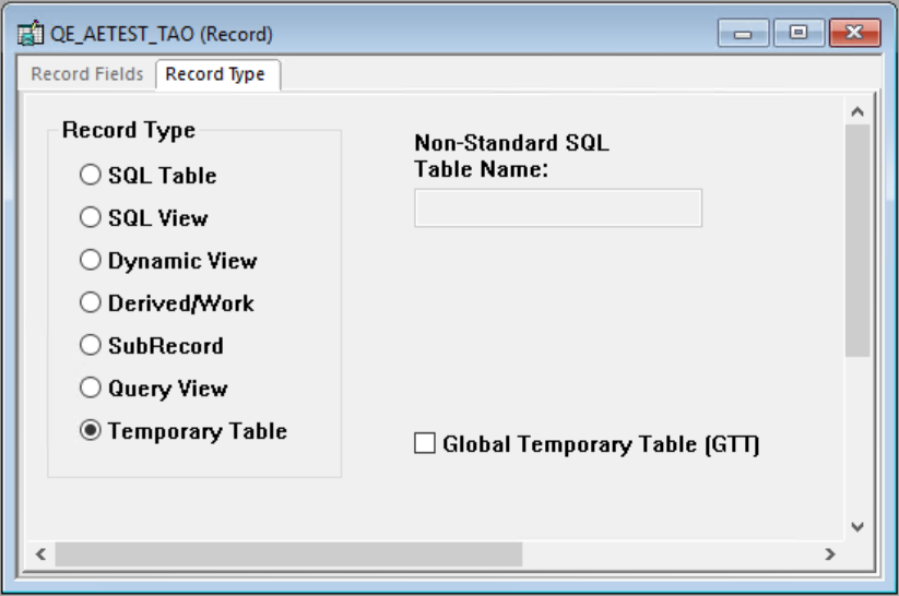

Temporary Table
Select to define the record definition as a temporary table. You can specify temporary images of the table on the PeopleTools Options page. Use temporary tables for running PeopleSoft Application Engine batch processes. Temporary tables can store specific data to update without risking the main application table.
When creating a temporary table on an Oracle RDBMS, you have the option of creating a Global Temporary Table (GTT). Using GTTs can enhance Application Engine performance.

When building temporary tables on an Oracle database, you have the option of implementing Global Temporary Tables (GTT) for enhanced performance.
This example shows the Record Type tab when creating a temporary table on the Oracle platform with the Global Temporary Table option displayed.
