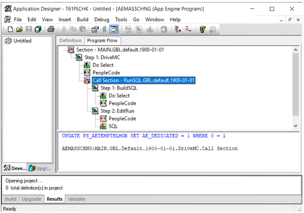

Verify the configured Application Engine program in Application Designer to know the impact of the plug-ins.
You can identify the configured SQL, PeopleCode, or Call Section action by a red flash on its icon.
This image shows the configured actions with a red flash icon.
On the code (lower) pane:
The additional code is highlighted in blue.
The original code or action from the plugged action appears in black.
Replacement code or actions are in red and the code being replaced is in strikethrough.
The codes are displayed based on the order of execution defined in the PIA.
When a SQL, PeopleCode, or Call Section action has a plugin to do a Call Section, then the lower pane will show the Call Section plugin as:
Call Section - <Plugin Program Name>.<Plugin Section Name>
    For example,
Call-Section - QE_AETESTPRG.QE_PCODE
Note: You can use the %AECallerApplId system variable to identify the name of the Application Engine program that executed a plug-in action or a call section to the currently executing program.
For more details, see %AECallerApplId

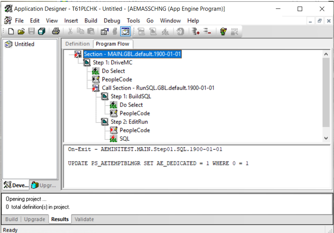

You can verify the configured On-Exit Application Engine plug-in in the Application Designer.
This example shows an On-Exit Application Engine plug-in configured in the Application Designer.

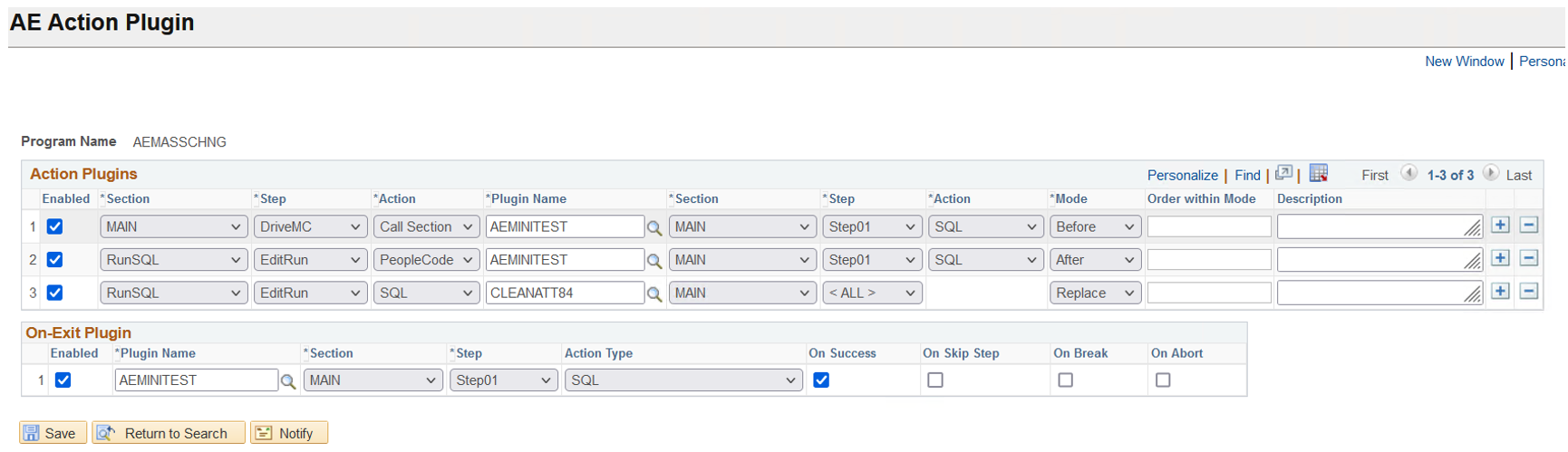

Use the AE Action Plugin page to configure Application Engine action plug-in and On-Exit Application Engine plug-in.
This example illustrates the fields and controls on the AE Action Plugin page. You can find definitions for the fields and controls later on this page.
   Use these configuration options to configure a delivered Application Engine program:
Field or Control  |
Description  |
Enabled  |
 Select this check box to enable the configuration.  |
Section  |
 Select a section of the delivered Application Engine program, which you plan to configure. Only sections with steps having SQL or PeopleCode are listed.  |
Step  |
 Select a step of the chosen section. Only steps that have SQL or PeopleCode actions are listed.  |
Action  |
 Select an action from the chosen step.  |
Plugin Name  |
 Select the new Application Engine program that contains the new SQL or PeopleCode action, which will be used to configure the delivered Application Engine program.  |
Section  |
 Select the required section from the new Application Engine program.  |
Step  |
 Select the required step from the selected section. Note: The step <ALL> is used as a plug-in. When you select this step, it runs all the steps in the section and therefore the Action column disappears.  |
Action  |
 Select the SQL or PeopleCode action from the selected step to add before or after the existing action, or to replace the existing action.  |
Mode  |
 The three modes that decide the execution order of the configured Application Engine action:
Order within Mode  |
 This field is required if the same action belonging to the same step of the same section of the configured Application Engine program has multiple plug-ins using the same mode. The value entered in this field decides the sequence in which the actions within the mode run during execution.  |
Description  |
 (Optional) Descriptive notes.  |
Use these configuration options to configure On-Exit Application Engine plug-in:
Field or Control  |
Description  |
Enabled  |
 Select this check box to enable the On-Exit plug-in configuration.  |
Plugin Name  |
 Select the On-Exit Application Engine plug-in.  |
Section  |
 Select a section of the On-Exit Application Engine plug-in that you plan to run.  |
Step  |
 Select a step of the selected section.  |
Action Type  |
 Select an action of the selected step.  |
<Exit Conditions>  |
 These are the exit conditions:
 The On-Exit Application Engine plug-in runs based on the exit condition defined in the Application Engine program. For example, for an Application Engine program, if you set the On-Exit plug-in to run for the On-Break exit condition, the On-Exit plug-in runs when the last action executed before the Application Engine program exited was a SQL or PeopleCode action that issued a Break condition. See documentation for SQL and PeopleCode actions. See Using PeopleCode in Application Engine Programs Note: At least one of the exit conditions must be selected. Otherwise, an error is displayed while saving.  |
Note: In the PIA, the Actions Plugin grid gets disabled if the selected Application Engine program does not have SQL, PeopleCode, or Call Section actions, and a message is displayed stating that only On-Exit plug-ins can be configured.
