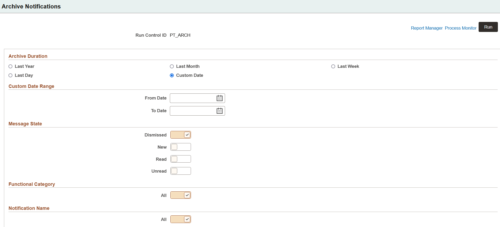

Use the Archive Notifications page to archive notifications system wide. Archiving notification data at regular intervals improves system performance.
Use the Archive Notifications page to archive the data based on the selected options. You can also use this page to schedule the archive process or set the recurrence of the process. When notifications are archived, the data is moved from the notification table (PSPTPN_MSG_TBL) to the archive table (PSPTPN_ARCHIVE).
Navigation:
This example illustrates the fields and controls on the Archive Notifications page. You can find definitions for the fields and controls later on this page.
Field or Control |
Description |
Archive Duration |
Select a time duration to archive notifications data:
Custom Date Range |
Set the period to archive data. |
Message State |
Select one or more message states to archive:
Functional Category |
Select a specific functional-category notification for archiving. Note: If no functional category is selected, notifications in all functional categories will be archived. |
Notification Name |
Select a specific notification for archiving. If a functional category is specified, the notifications are displayed based on the selected functional category. Note: If no notification is selected, all notifications will be archived. |
Run |
Select the Run button to display the Process Scheduler Request page where you can schedule the archive process and set the recurrence of the process, if required. For more information, see Scheduling Process Requests and Defining Recurrence Definitions. |
