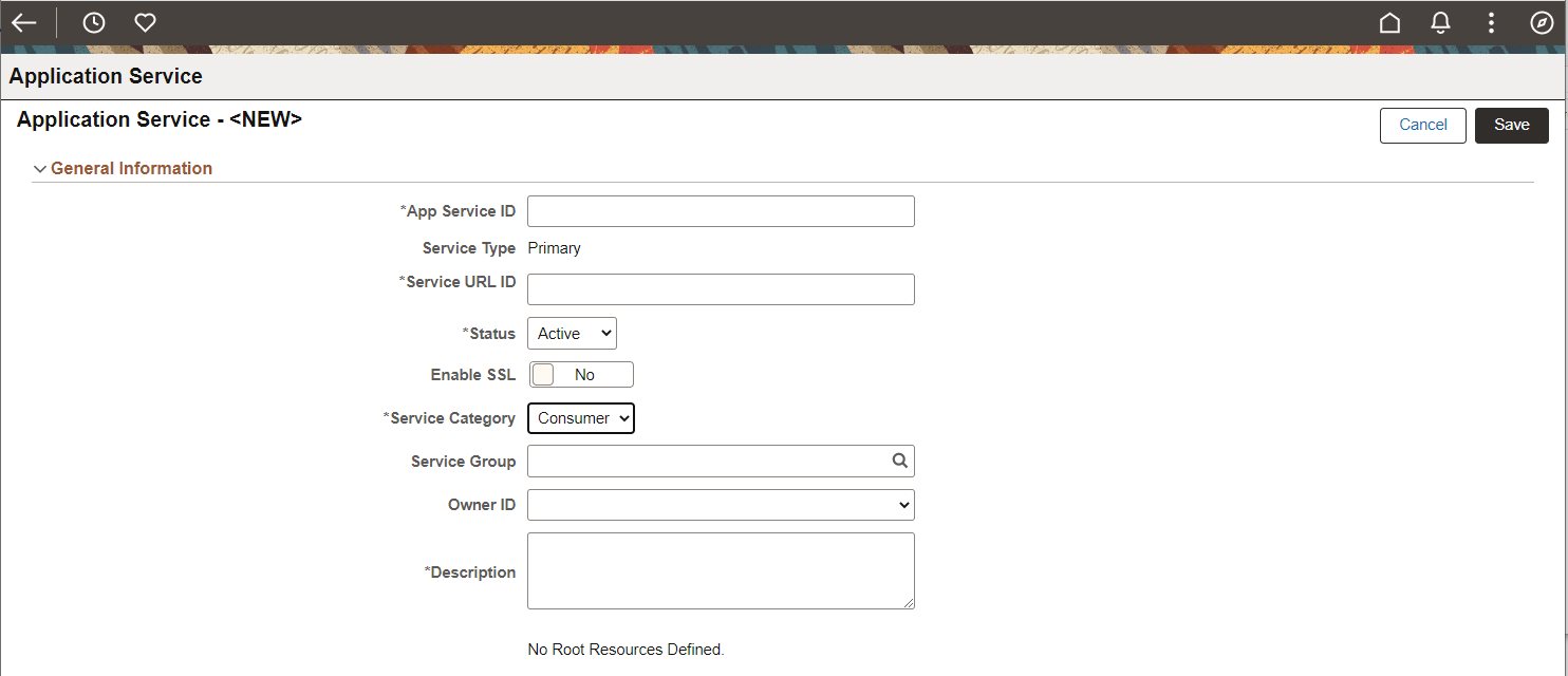

To create a new Consumer Application Service:
  1. Select PeopleTools > Integration Broker > Application Services > Manage Application Services.
  2. Select Create Application Service.
This example illustrates the fields and controls on the Application Services – General Information page to create a new Consumer Application Service. You can find definitions for the fields and controls later on this page.
Create New Consumer Application Service
Field or Control
Description
App Service ID
Service ID for the Application Service.
Service Type
When you create a new Consume Application Service, the Service Type is Primary only.
Service URL ID
Service URL ID forms a part of the endpoint URL. It identifies the service to be executed.
Status
Status for the Application Service. When you create a new Application Service, the default Status is Active.
Enable SSL
Requires SSL for the Service to be invoked.
Service Category
Select Consumer.
Service Group
Used to group services together for search.
Owner ID
Owner of the Application Service.
Description
A description for the Application Service.

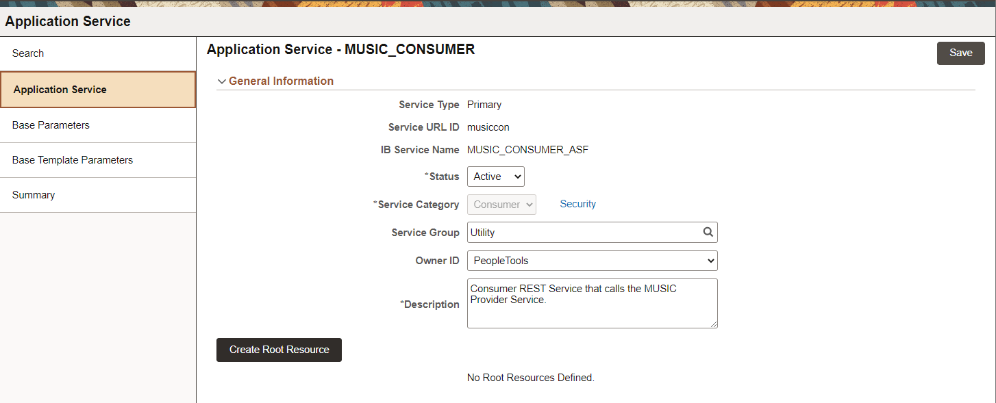

  • When the Service URL ID is valid, save processing will generate the necessary IB metadata, update the Service Name and enable the Create Root Resource button.

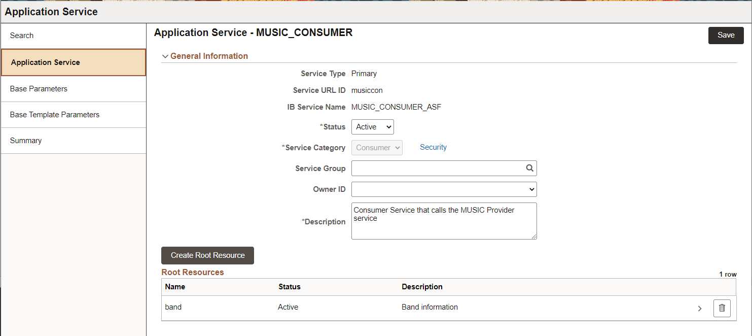

This example illustrates the fields and controls on the Application Service page for Consumer Application Service after Save. You can find definitions for the fields and controls later on this page.
Field or Control
Description
Security
Select this link to set the Security details.
Select this button to create a new root resource.
The Security link at the Service level can be used to update the security for all defined methods of the Service.

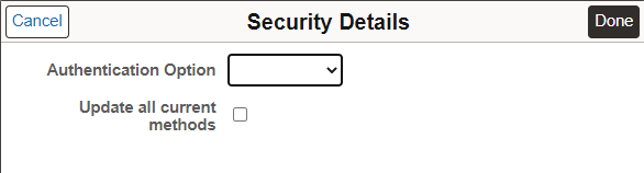

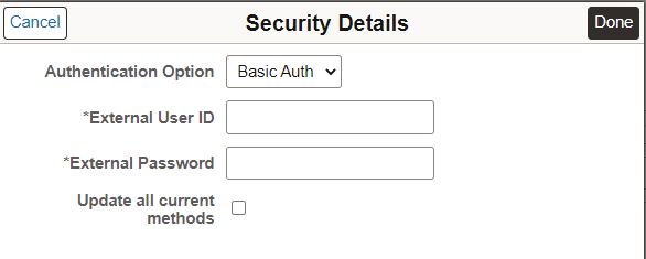

The provider of the integration will define what security will be required to invoke their integration(s). This can be Basic Authentication, oAuth2 or no security at all. For each method (integration) the appropriate security can be set by selecting the Security link. The developer can then select the Authentication Option.
This example illustrates the fields and controls on the Security Details page. You can find definitions for the fields and controls later on this page.
Field or Control
Description
Authentication Option are Basic Auth or oAuth2
Update all current methods
Select this check box to propagate the security information to all the methods.
This example illustrates the fields and controls on the Security Details page when Basic Auth is selected. You can find definitions for the fields and controls later on this page
Basic Auth
Field or Control
Description
External User ID
User ID
External Password
User ID password

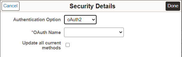

oAuth2
3rd party Authorization Service information should first be registered on the oAuth2 security pages see Creating a Service Application.
This example illustrates the fields and controls on the Security Details page when oAuth2 is selected. You can find definitions for the fields and controls later on this page.
oAuth2
Field or Control
Description
Authorization Option
oAuth2
OAuth Name
Select the OAuth name from the drop down list. All registered Service Applications are available from the drop down list.

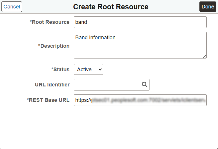

Use the Create Root Resource page to create a new root resource.
Select the Create Root Resource button from the Application Service page.
This example illustrates the fields and controls on the Create Root Resource page for a Consumer Application Service. You can find definitions for the fields and controls later on this page.
Field or Control
Description
Root Resource
The name of the Root Resource defined by the Provider.
Description
A description of the root resource.
Status
Status for the root resource. When a root resource is created, the default status is Active.
URL Identifier
The URL Identifier defined for the REST base URL.
If you select a URL Identifier for the Application Service, the REST Base URL field gets automatically populated and becomes read-only. To define the REST Base URL, remove the URL Identifier entry and tab out.
Note: You must define either a REST Base URL or URL Identifier to save the Application Service.
REST Base URL
The base URL as defined by the Provider Integration to be called.
Note: For the cases where a root resource cannot be established then any root resource name will do as long as it complies with the Oracle naming standards.
Once the root resource is created for the Application Service it is displayed on the page.
This example illustrates the fields and controls on the Application Service page after root resource is created.

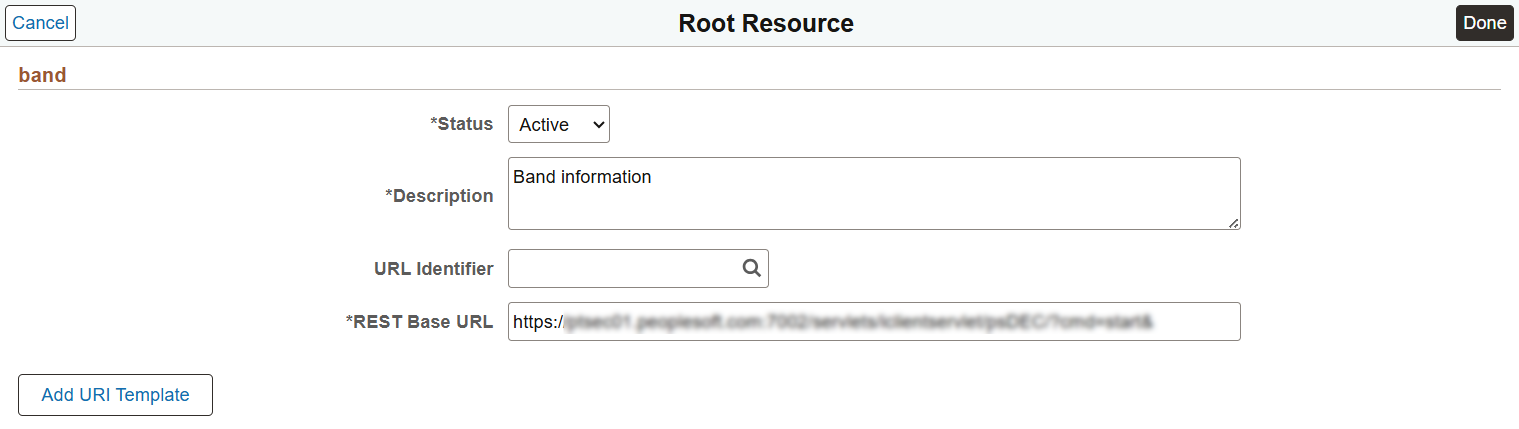

Select the Root Resource name to open the Root Resource page.
This example illustrates the fields and controls on the Consumer Root Resource page.
Select the Add URI Template button to define the URI templates for this resource. See Adding URI Templates.
