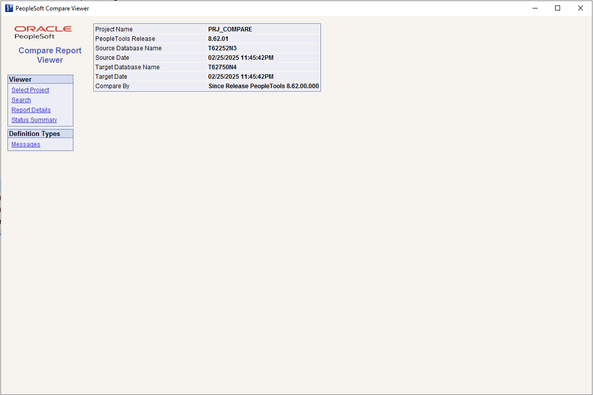

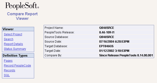

The following is a screen image of Accessing Browser Reports in PeopleSoft Compare Report Viewer.
The Viewer menu contains menu options related to navigating within the report. The Definition Types menu enables you to dill down into the compare data for each definition type compared. The Definition Types menu only contains the definitions compared.
Note that the PeopleSoft Compare Report Viewer (pscmpviewer.exe) is placed in the same folder location where browser compare reports are saved.
The compare reports are saved to the location you specify in the Report Output Directory field in Tools > Options on the General tab.

Click Report Details to view information related to the databases and/or files compared.
Field or Control |
Description |
Project Name |
The name of the project in the primary database. |
PeopleTools Release |
The PeopleTools release number on which the primary database runs. |
Source Database/Source File |
The name of the primary database or file depending on which compare option you selected. |
Source Date |
The date the primary database was last updated. |
Target Database |
The name of the secondary database. |
Target Date |
The date the secondary database was last updated. |
Compare By |
Displays the Comparison options selected on the Compare Options dialog box either the release or date. |
