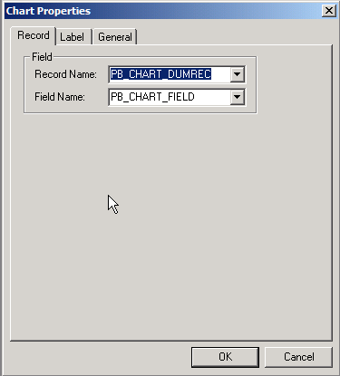

Associating the Chart Control with a Record Field
Each chart on a component must be associated with a unique field. Double-click the chart control to access the Chart Properties dialog box and enter a record name and field name.
Chart properties dialog
The chart field has no special requirements. Its only purpose is to provide a reference to the field in PeopleCode.

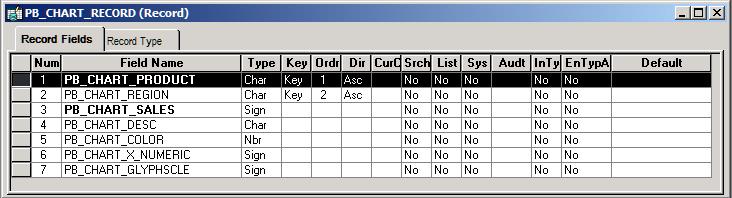

Creating the Chart Data Record
The chart needs either a record or a rowset to serve as the data source. This sample chart uses a record. See the Chart class SetData method for details about using a rowset.
See SetData.
At a minimum, the record must have fields for the x-axis data and the y-axis data. Optionally, the record can have fields for series data, chart color, and glyph size.
Example of a chart data record

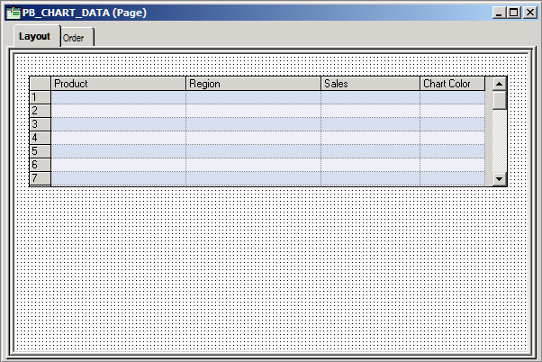

The record must be available in the component buffer at runtime. You can use a database record that is already part of your application or you can use a derived/work record or a component rowset that you populate at runtime. For greatest control, you will normally populate your record or rowset at runtime.
For the sample chart, place the record on a grid on a second page on the sample component. This placement gives you the opportunity to experiment with the data.
Your chart data record must be placed at level 1 on the same component as the chart so that the data is available in the component buffer at runtime. In your application, you can hide the grids or scroll areas that hold the records. For the sample chart, you will keep the grid visible so you can enter sample data.
Example of a page definition with chart data grid

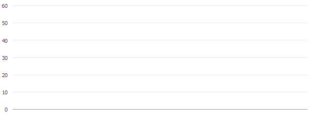

Viewing the Page in the Browser
This is the most basic Chart class chart. It has no data and only the default y-axis.
Chart class chart with no data

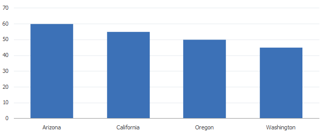

Adding Data for the Chart
Add the following data to the chart:
Region
Sales
Arizona
60
California
55
Oregon
50
Washington
45
This bar chart is generated by the example code and data:
A simple bar chart
This chart graphs sales on the y-axis (the vertical axis) and regions on the x-axis (the horizontal axis).

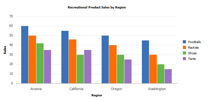

Add this PeopleCode to set the series record field:
&cChart.SetDataSeries(DOC_CHRT_SLSREC.DOC_CHRT_PRDCT);
The resulting chart is a default 2D bar chart with bars for each region grouped by series:
Default 2D bar chart with products as series
The chart has four series:
  • Footballs
  • Rackets
  • Shoes
  • Tents
Each series shows four regions along the x-axis:
  • Arizona
  • California
  • Oregon
  • Washington
Sales values appear against the y-axis as bar height.
The chart uses the default colors.

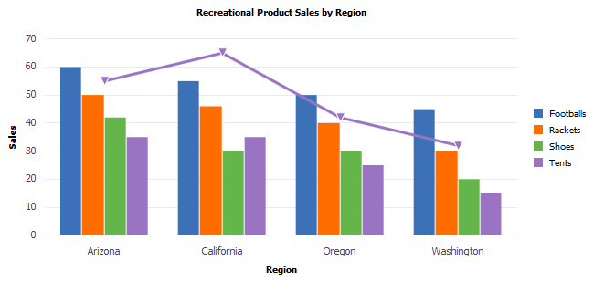

The following PeopleCode adds these elements to your chart:
  • Title
  • Legend
  • Y-axis title
  • X-axis title
/* Set title and legend properties */
&cChart.MainTitle = "Recreational Product Sales by Region";
&cChart.HasLegend = True;
&cChart.LegendPosition = %ChartLegend_Right;
/* Set axis text properties */
&cChart.XAxisTitle = "Region";
&cChart.YAxisTitle = "Sales";
This is the resulting chart:
Sample bar chart with custom colors, a main title, axis titles, and a legend
Reviewing the Complete Program
The PeopleCode for this bar chart has been presented in snippets. Here is the complete program that produced the chart:

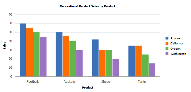

Changing X-Axis and Series Values
&cChart2.SetDataXAxis(DOC_CHRT_SLSREC.DOC_CHRT_PRDCT);
&cChart2.SetDataSeries(DOC_CHRT_SLSREC.DOC_CHRT_RGN);
&cChart2.MainTitle = "Recreational Product Sales by Product";
&cChart2.XAxisTitle = "Product";
To group sales by product instead of by region, switch the series and the x-axis. You will also need to reorder colors to correspond to regions instead of products:
2D Bar chart

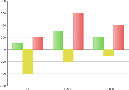

If your chart has negative values, the bars automatically extend below the x-axis:
Bar chart with negative values

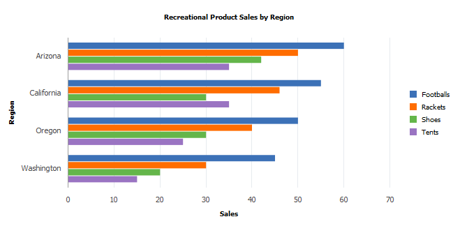

Horizontal Bar Chart
Use this line of code to specify a horizontal bar chart:
&cChart.Type = %ChartType_2DHorizBar;
This example illustrates a horizontal bar chart:
Horizontal bar chart

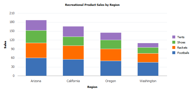

Stacked Bar Chart
With a the stacked bar chart, you can place a different emphasis on the same data. The stacked column shows total sales per region as well as the product segments that contribute to the total.
Use this line of code to specify a stacked bar chart:
&cChart.Type = %ChartType_2DStackedBar;
This example illustrates a stacked bar chart:
Stacked bar chart

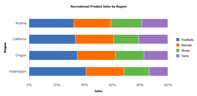

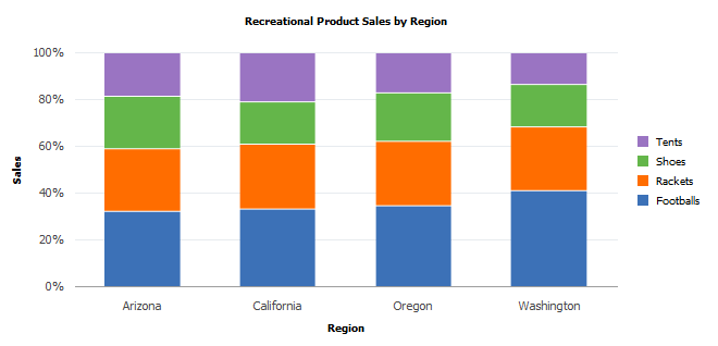

Percent Bar Chart
A percent bar is similar to a stacked bar, but the segments of each bar add up to 100. The segments show the proportional contribution of each product to total sales.
Note: Negative values cannot be displayed in any type of percent bar chart.
Use this line of code to specify a stacked percent bar chart:
&cChart.Type = %ChartType_2DPercentBar;
This example illustrates a percent bar chart:
Percent bar chart
Horizontal Percent Bar Chart
Use this line of code to specify a horizontal percent bar chart:
&cChart.Type = %ChartType_2DHorizPercentBar;
This example illustrates the fields and controls on a horizontal percent bar chart:
Horizontal percent bar chart

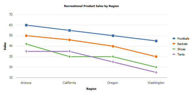

Line Chart
A line chart is useful for showing changes and trends over time or across categories.
Use this line of code to specify a line chart:
&cChart.Type = %ChartType_2DLine;
This example illustrates a line chart:
Line chart

Use the OLType property to specify whether the overlay is a line chart or a histogram.
Add this PeopleCode to the PeopleCode for your bar chart to create 2D line chart overlay:
/* Create Overlay */
&cChart3.SetOLData(Record.DOC_CHRT_OLREC);
rem &cChart.SetOLDataSeries(DOC_CHRT_OLREC.SC_CHART_SERIES);
&cChart3.SetOLDataXAxis(DOC_CHRT_OLREC.DOC_CHRT_RGN);
&cChart3.SetOLDataYAxis(DOC_CHRT_OLREC.DOC_CHRT_SALES);
&cChart3.OLType = %ChartType_2DLine;
This example illustrates a 2D line chart overlay on a vertical bar chart:
Overlay Chart

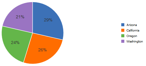

Pie Chart
A pie chart shows comparisons within a single set of values, and it shows how parts contribute to a whole. It is an ideal chart type to display the contribution of each region to an annual sales total.
A pie chart ignores the series and only plots x-axis data against y-axis values. Our original bar chart has four regions times four products, resulting in 16 XY pairs. A pie chart with all of those slices would be confusing and not helpful. Instead, suppose you want to show just the data for tents, which are in rows 13–16. You can use a combination of the DataWidth and DataStartRow properties to select which rows to display.
You can make a pie chart showing only rows 13–16 by adding this snippet of code:
&cChart.DataWidth = 4;
&cChart.DataStartRow = 13;
&cChart.Type = %ChartType_2DPie;
This example illustrates a 2D pie chart generated from a portion of the rowset:
2D pie chart

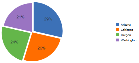

Exploded Pie Chart
Use the SetExplodedSectorsArray Chart class method to specify the sectors to explode. Sectors correspond to rows of data used by the pie chart. Sector 1 is the first row of data, or the row specified with the DataStartRow chart class property, if it is used, and so on.
The following snippet of code explodes sectors 1 and 3:
Local array of number &ExplodedArray;
&ExplodedArray = CreateArray(1,3);
&cChart.SetExplodedSectorsArray(&ExplodedArray);
This example illustrates an exploded pie chart:
Exploded pie chart
See the SetExplodedSectorsArray property.

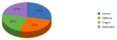

3D Pie Chart
Use this line of code to specify a 3D pie chart:
&cChart.Type = %ChartType_3DPie;
This example illustrates a 3D pie chart.
3D Pie Chart

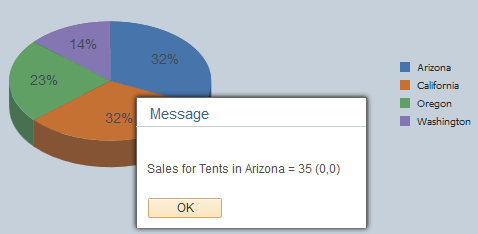

Adding Drilldown
If you set the property IsDrillable to True and add FieldChange PeopleCode to your chart, your user can get more information by clicking a chart data element—a bar, line segment, data point, or pie slice.
For a simple example, add this PeopleCode to the FieldChange event on the y-axis field:
MessageBox(0, "", 0, 0, "Sales for " | DOC_CHRT_SLSREC.DOC_CHRT_PRDCT | " in " | DOC_CHRT_SLSREC.DOC_CHRT_RGN | " = " | DOC_CHRT_SLSREC.DOC_CHRT_SALES | "");
And add this code to the page Activate event for your pie chart:
&cChart.IsDrillable = True;
When the user clicks the Arizona slice of the pie chart, this message appears:
Example of drill-down triggering PeopleCode with MessageBox
Current context provides the values for fields in the current row in the component buffer. You can use drilldown with your chart data fields along with any other data in the component buffer to accomplish anything FieldChange PeopleCode is capable of.

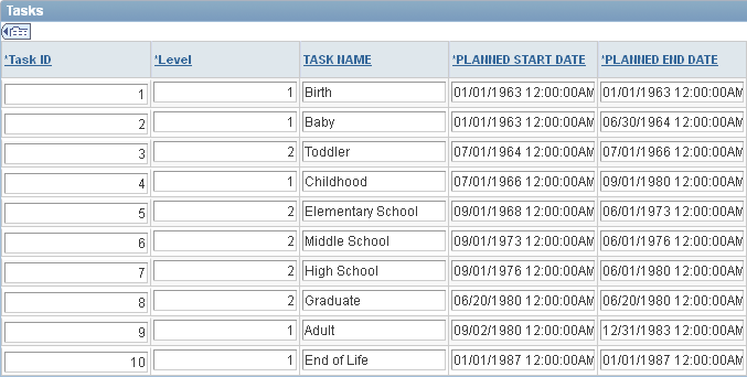

This example uses the following data in the record QE_GANTT_TASK:
This example illustrates Gantt task data:
Example of Gantt task data

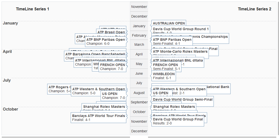

Complete the following steps to create a timeline chart with two series:
  1. Place a chart control on a page in Application Designer.
  2. Create an instance of the Timeline class in PeopleCode.
    &oTChart = GetTimeline(QE_CDEMO_WRK.QE_CHART_TIMELINE);
  3. Specify labels for the series.
    &oTChart.SetSeriesLabels(CreateArray("TimeLine Series 1", "TimeLine Series 2"));
  4. Set the scale of the major axis.
    &oTChart.MajorAxisScale = "quarters";
  5. Set the scale of the minor axis.
    &oTChart.MinorAxisScale = "months";
  6. Set zoom order of the timeline.
    &oTChart.MinorAxisZoomOrder = CreateArray("months", "weeks");
  7. Specify start time of the timeline.
    &oTChart.Start = DateTimeValue("2012-11-01 00:30:40.12-0600");
  8. Specify end time of the timeline.
    &oTChart.End = DateTimeValue("2013-12-30 00:30:40.12-0600");
  9. Set the record for chart data.
    &oTChart.SetData(Record.QE_TLINE_DATA);
  10. Specify the field representing the identifier for the time line series.
    &oTChart.SetDataSeries(QE_TLINE_DATA.QE_TIMELINE_SERIES);
  11. Specify the field for the start time of the timeline item.
    &oTChart.SetDataItemStart(QE_TLINE_DATA.QE_TIMELINE_START);
  12. Specify the field for the description to display on the timeline item.
    &oTChart.SetDataItemDescription(QE_TLINE_DATA.QE_DESCR50);
  13. Specify the field for the title to display on the timeline item.
    &oTChart.SetDataItemTitle(QE_TLINE_DATA.QE_CHARTTITLE);
  14. Specify the timeline orientation.
    &oTChart.Orientation = %Chart_Vertical;
The preceding lines of PeopleCode generate the following timeline chart assuming that sample data is provided for the chart.
A resulting timeline chart.
Timeline Chart with 2 series
