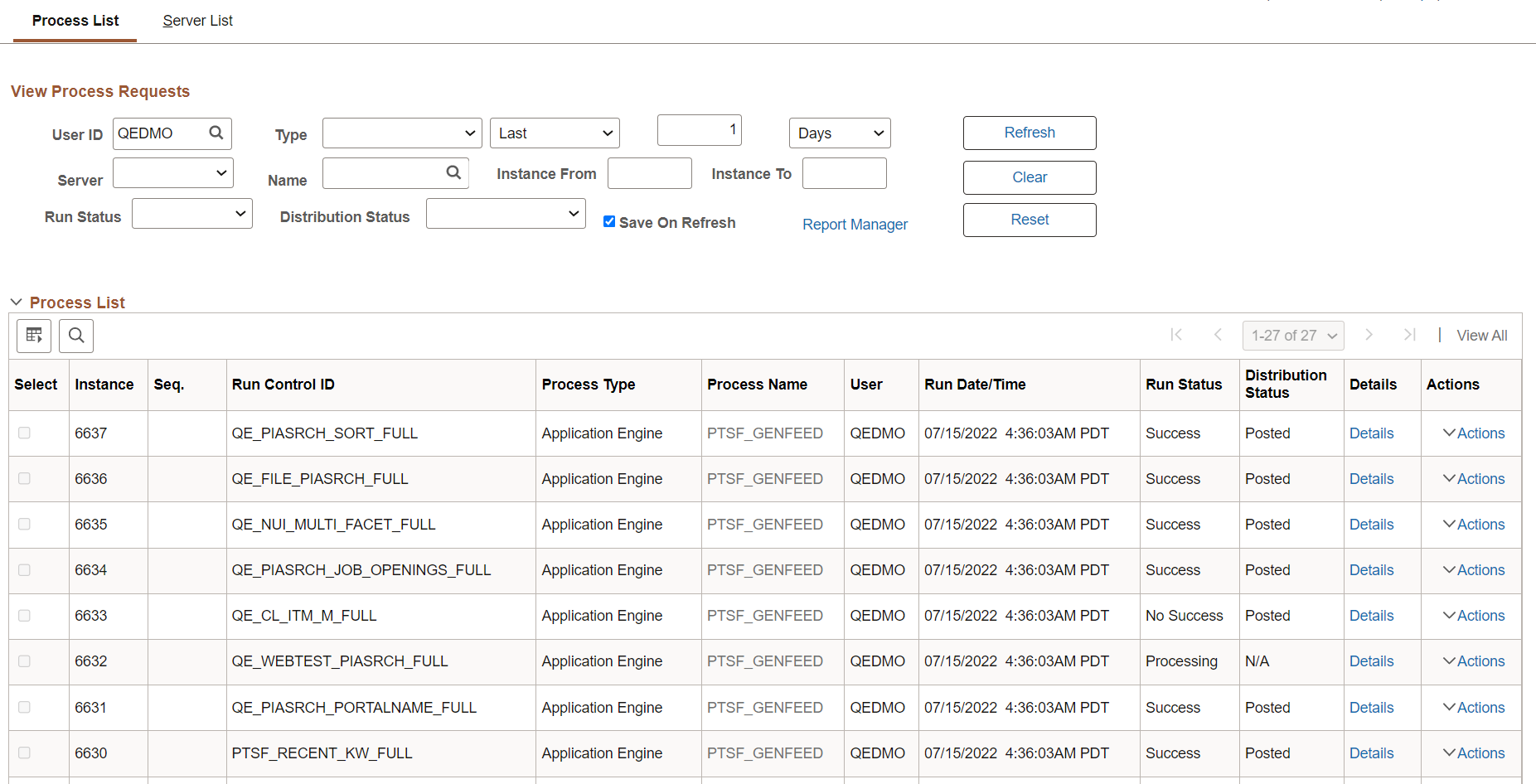

To access the Process List page, select PeopleTools > Process Scheduler > Process Monitor.
This example illustrates the fields and controls on the Process List page. You can find definitions for the fields and controls later on this page.
Process List page
Field or Control
Description
User ID
View the processes submitted by a user ID. Usually, you view your own user ID. Leave blank to view all of the processes that you are authorized to view.
Type
View by a process type, such as Application Engine, COBOL, SQR, or Application Engine.
All or Last or Date Range
Specify an interval of time by which to limit the process requests that appear in the list. When you select All, the time interval fields are grayed out and all process requests appear.
Select Last to display only those reports that were created in the last number of days, hours, years, or minutes. Enter a custom numerical value in the field and then select a unit type: Days, Hours, Years, or Minutes.
Select Date Range to display only those reports created between two specific dates. Enter a From date and a To date.
Refresh
After selecting your filtering options, select Refresh to display the filtered processes.
Clear
Select to clear the filters and set them to their default values.
Reset
Select to reset the filters to the last saved values in the database.

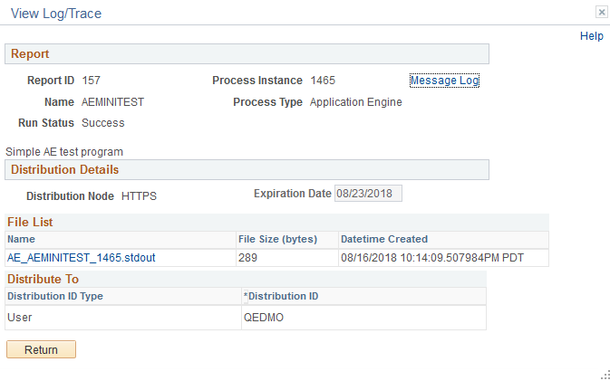

View Log/Trace: Select to view the process log or trace details for the process.

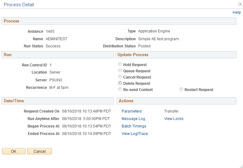

To access the Process Detail page, select the Details link on the Process List page.
This example illustrates the fields and controls on the Process Detail page.
Process Detail page
Use the Process Detail page to view details, such as request parameters, message logs, and any recovery instances that have been run. Many of the items on this page are display-only. However, you can use some controls to manipulate the program run.
Note: You must select OK to confirm the Update Process request on the Process Detail page.
Process
This display-only group box contains general descriptive information to help you identify the process request, including the run and distribution states.

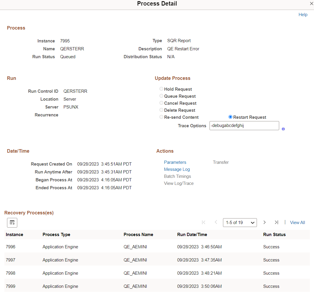

Note: The action Resend Content is available when the Distribution Status for a process is Not Posted.
You can dynamically change the trace value to the desired setting on restart for processes in the Process Monitor, which helps you to debug failed processes. The trace option is available for processes having completion status as No Success or Error.
This additional feature is displayed for processes of the Application Engine, SQR Report, or COBOL types when selecting the restart option following the completion and failure of a restartable process. It includes:
  • Trace Options text box
  • Tool Tip help
This example illustrates the Trace Options field on the Process Detail page.
The text entered for tracing can be found in the Command Line section of the process request parameters. If trace values are already specified in the command line through the Process Definition Override parameters, the Trace Options text box is pre-filled and can be edited within the Process Monitor on restart. You have the option to input new tracing values if they are not initially present in the command line. Additional information about these actions is provided in the Viewing Process Detail Actions section of this topic.
This example illustrates the tracing text appended to Command Line in Process Request Parameters.
Tracing text appended to Command Line in Process Request Parameters
The Tool Tip help text is dynamically populated based on the process type.

Displays the path and program used to run the process.
You can select the command line and copy it into other tools. This is useful when trying to isolate a request-related problem originating outside of PeopleSoft Process Scheduler, such as an incorrect entry in Configuration Manager or an SQR compile problem.
For example, after copying the command line, you might paste the parameters directly into the target of an SQRW icon and then run the process outside of PeopleSoft Process Scheduler to isolate a problem.
Working Dir (working directory)
Displays the directory in which the database connectivity software is installed.
Destination
Displays the location of the completed output that is generated by the process, such as %%OutputDirectory%%.
When the output destination for the process is Web, the destination lists the user or role IDs that are authorized to view the report in Report Manager.
Message Text
Displays additional information about the process status. Typically, this displays built-in messages that describe the status of the program that you are running.
Note: You must manually provide passwords (CP %OPPPSWD% params) that are required in the request parameters, because they are not exposed on the Process Request Parameters page for security reasons.

Viewing Log and Trace Files
Click the View Log/Trace link on the Process Detail page to access the View Log/Trace page.
This example illustrates the fields and controls on the View Log/Trace page.
View Log and Trace link
The View Log/Trace page enables you to view the output file, message log and trace file in a browser. The View Log/Trace link appears active on the Process Detail page when at least one of the following conditions is met:
  • The output destination for the process request is Web, and the report and log files were successfully posted to the Report Repository by the Distribution Agent.
    The process must have a run status of Success.
    • If the report has not been transferred to the Report Repository, the run status of the process request remains Processing and the View Log/Trace link is not active.
    • If the status of the request remains Processing, check the message log for messages from the Distribution Agent indicating that problems occurred while transferring files to the Report Repository.
  • The process request ran from a PeopleSoft Process Scheduler Server Agent that was set up using the Server Definition page with a distribution node.
    You must have also selected to transfer log files to the Report Repository when you set up the preferences on this page.
